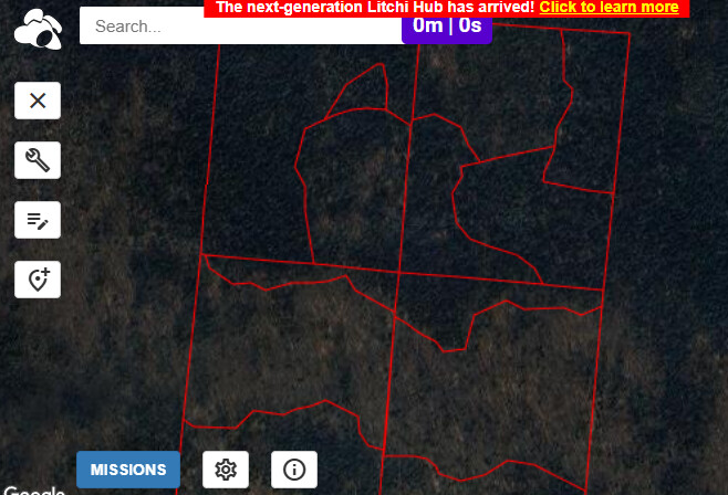

Hello Litchi Team,
I would like to report a very important functionality that seems to be missing in the new version of Litchi Hub.
In the old Litchi Hub, it was possible to import KML files as map overlays (background layers). This feature worked perfectly and was extremely useful for mission planning. It allowed us to prepare flight missions much faster and more precisely, especially when working with predefined boundaries, fields, or reference layers.
Unfortunately, in the new Litchi Hub, this KML overlay import functionality no longer works / is no longer available.
For many professional users, this is a critical feature, and its absence significantly slows down the mission preparation process. Being able to use KML files as background layers is essential for efficient and accurate planning.
I would kindly ask you to urgently consider restoring or re-implementing the KML overlay import feature in the new Litchi Hub.
Thank you for your work on the platform and for considering this request.
This functionality would greatly improve usability and workflow efficiency.
Best regards,
…somethink like this:
Yes, exactly - it works in older version….

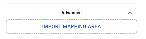

Have you tried the ā€œImport Mapping Areaā€ feature in the Area Mapping flight’s advanced settings?
Does this not meet your needs?
Thank you for your response.
No, unfortunately this does not meet my needs.
The ā€œImport Mapping Areaā€ feature is designed to import a specific flight/mapping area, whereas my use case is different.
I do not want to import a single mission or mapping polygon.
What I need is the ability to import a KML file as a background/overlay layer, exactly as it worked in the old Litchi Hub.
The KML files I use contain thousands of different polygons (e.g. fields, parcels, boundaries), and they are meant to serve only as a reference layer during mission planning — not as an active flight area.
In the old Litchi Hub, the KML overlay import allowed this to work perfectly and greatly improved planning efficiency.
The current ā€œImport Mapping Areaā€ option does not replace this functionality.
We’ve made the following changes to the Hub:
  • you can now import KML polygons to help flight planning
  • DJI Fly KMZ export: flights are now always exported with curves for improved support
  • added a new Mini 4 Pro drone model that can be used for DJI Fly KMZ export
Great - now it is working perfectly !
