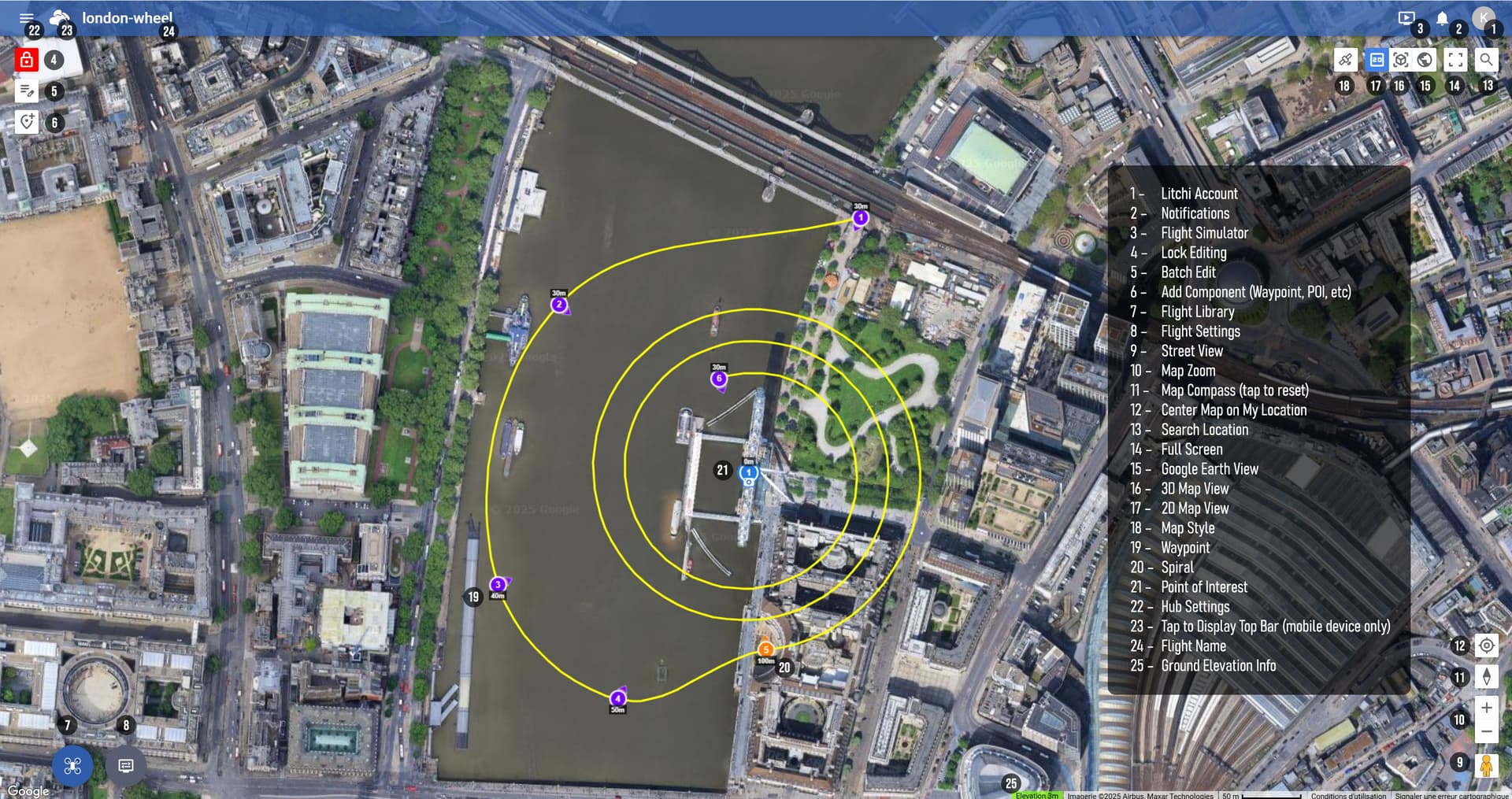

Editing Tools
Waypoint editing is fast and intuitive thanks to contextual controls.
Left-click allows you to add waypoints on the map or interact with map elements.
Right-click options allow you to:
  • Insert a waypoint before or after
  • Delete a waypoint or POI
Waypoint tooltips display key information, including:
  • Heading
  • Gimbal pitch angle
The Add Component button allows you to
  • Add a Waypoint
  • Add a POI
  • Add an Orbit or a Spiral
  • Add a Takeoff Point reference
The Transform Tool allows quick adjustments to entire flights.
Transform features include:
  • Move a flight to a new location
  • Rotate the flight path
  • Scale the flight layout
This makes it easy to reuse the same flight in different locations

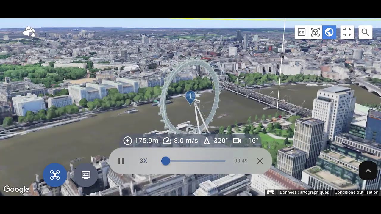

Flight Simulation
Flight simulation includes the same three visualization modes available during flight planning: 2D, 3D, and Google Earth’s photorealistic 3D.
The simulation widget provides intuitive controls to preview and navigate your flight before takeoff.
Simulation tools include:
  • Real-time drone simulation
  • Adjustable playback speeds (up to 8×)
  • Current waypoint settings display during playback
  • Skip forward or backward between waypoints
  • Timeline position slider
  • Automatic waypoint selection during playback
  • 2D & 3D flight simulation preview
  • Google Earth–powered photorealistic simulation environment
Demo video
This allows pilots to preview flights using real terrain, buildings, and satellite imagery
