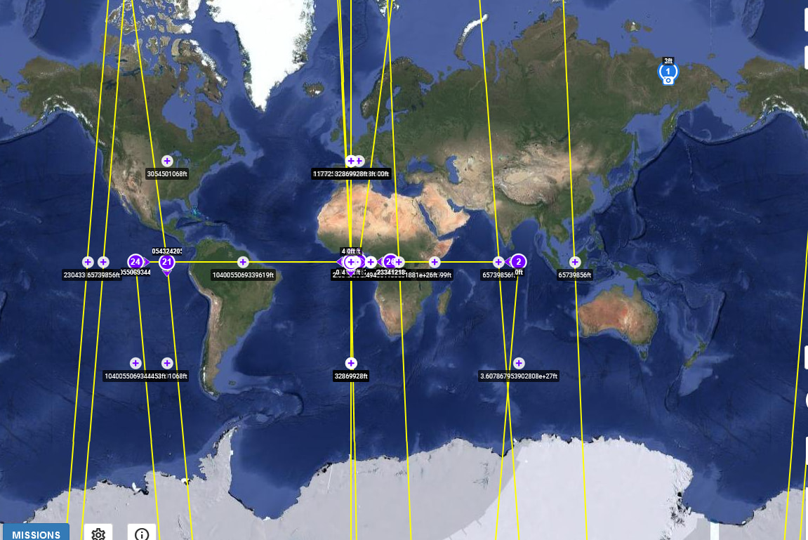

I’m having an issue where if I change the drone type on any particular mission to a mini three pro or a Mavic three pro when I loaded into the apps, the way points are scattered towards the equator of the entire map. If I set the drone as an air 2S it doesn’t do that, what I see in the litchi hub is what I see in the litchi app on my device.
Please clarify what you mean by “apps”. A mission configured for the Mavic 3 Pro in the new mission hub will not display correctly in the old mission hub and is not supported by either app.
I figured the problem out. When I create a mission in the next-generation hub, I created it initially for my Air 2S. I was able to fly the mission without issue. So I decided to change the parameters in the next-generation hub, so I selected the mini 3 pro from the drop down and adjusted the heading and gimbal settings. When I tried to pull it up again in the app (the wrong app), it did not show the mission in the correct location. The waypoints were scattered along the equator on the map. When I changed the drone type back the air 2S, everything displayed correctly again.

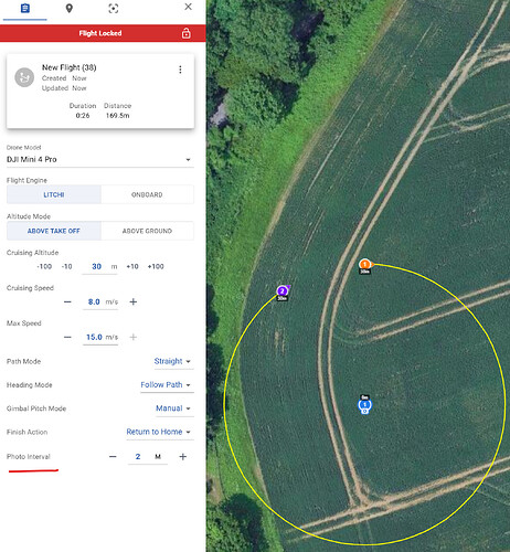

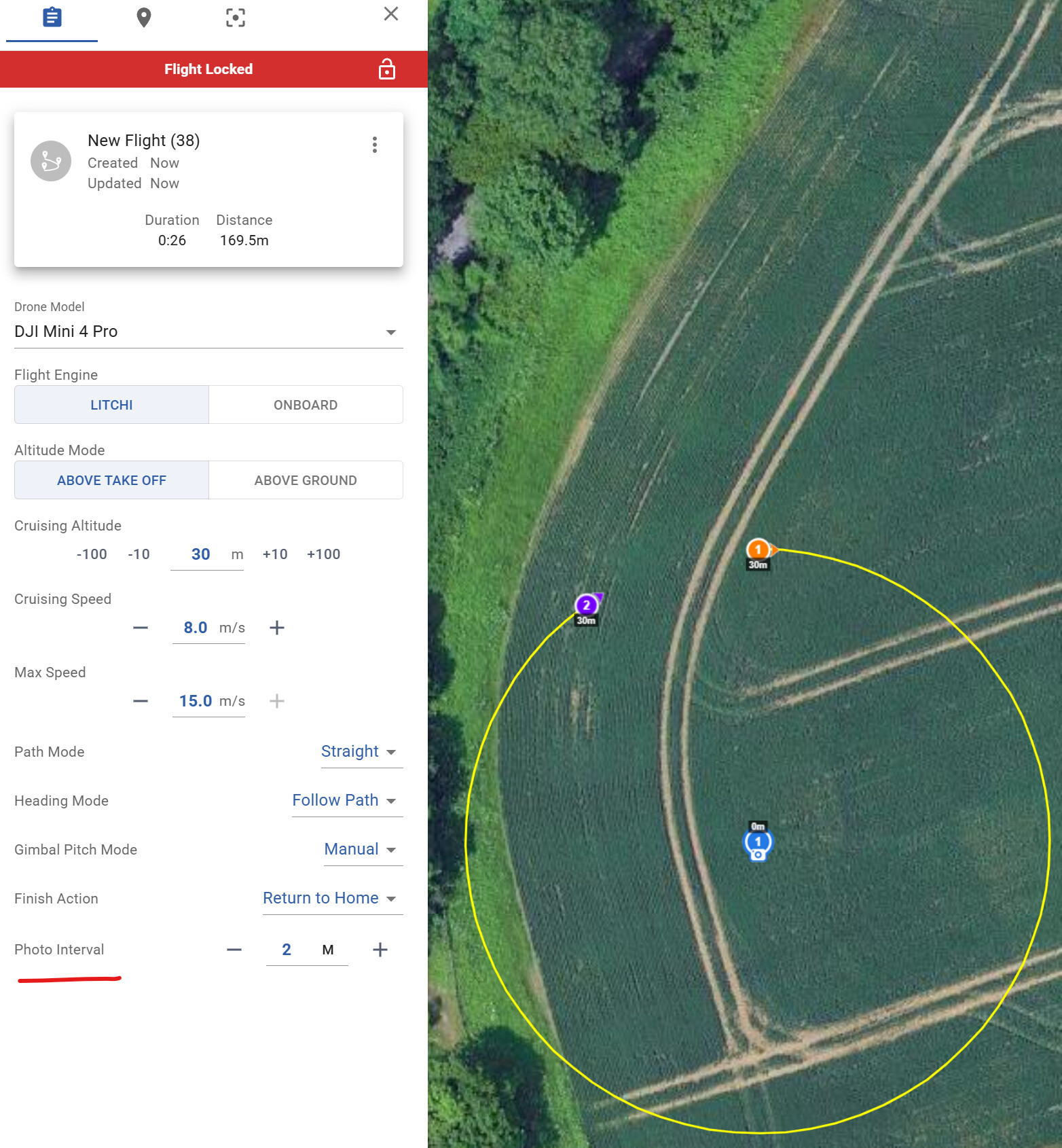

Are there any options in an orbital flight that take photos every X meters?
Use the ‘Photo Interval’ setting

Opening missions with the new litchi mission hub changes something so that the old mission hub can no longer open the saved missions properly. When I open the same missions once opened in the new mission hub, it’s all messed up with all waypoints along the equator. I still use the old mission hub because I can export to CSV and then use litchi utilities to convert it to a KMZ that pilo 2 app can open. The new mission hub doesn’t have the CSV export feature yet, still says “coming soon” for a while now. The KMZ file exported by the new mission hub doesn’t open properly in DJI Flight hub 2 nor the Pilot 2 app.
