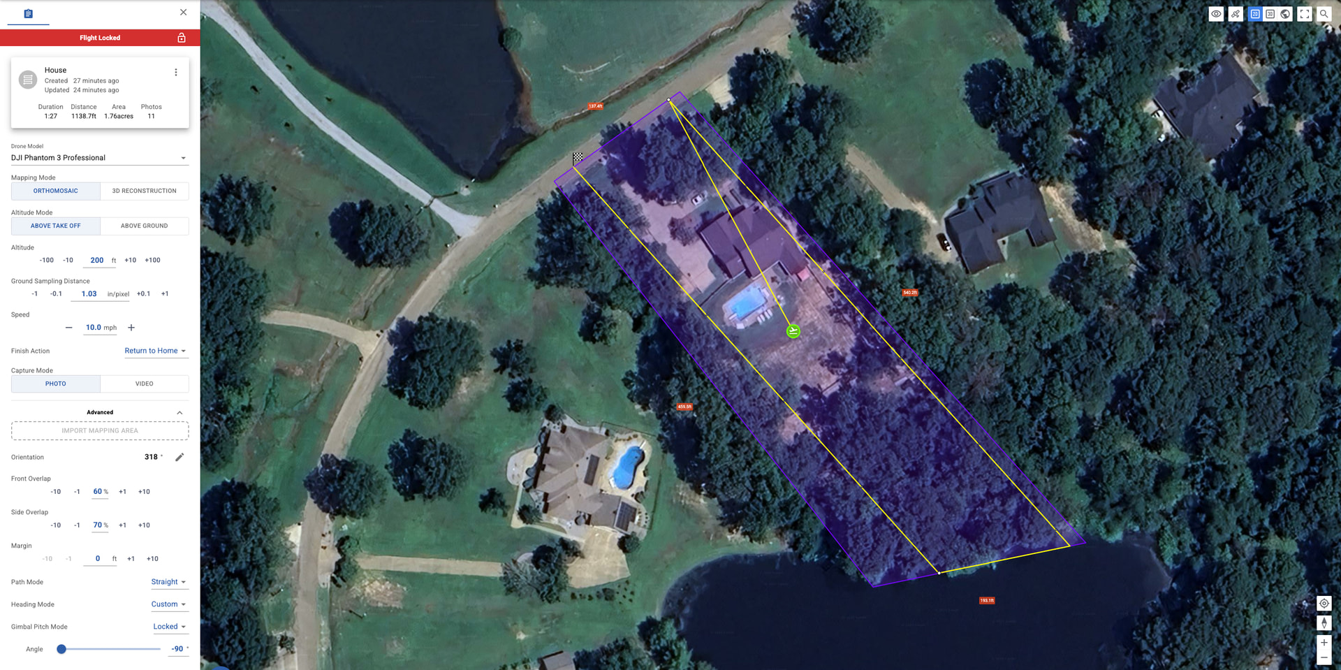

After creating an area mapping mission on the next-generation Litchi Hub and setting the photo interval to 3 seconds, when I load the mission into the Litchi for DJI Drones app, it is stripping the photo intervals and basically is leaving the way points and flight paths between each way point and is not taking pictures. I’ve tried playing with settings and searching the forum and internet and can’t find anything that helps. Thought I’d check to see if anyone has any insight. Thank you!
You can NOT set the Photo Capture Interval in a Mapping Mission in the new Beta Hub, it is calculated automatically depending on other settings:
-Altitude and/or Ground Sampling Distance
-Speed
-Front Overlap
You will get a warning when the calculated Interval gets too high (a lower number).

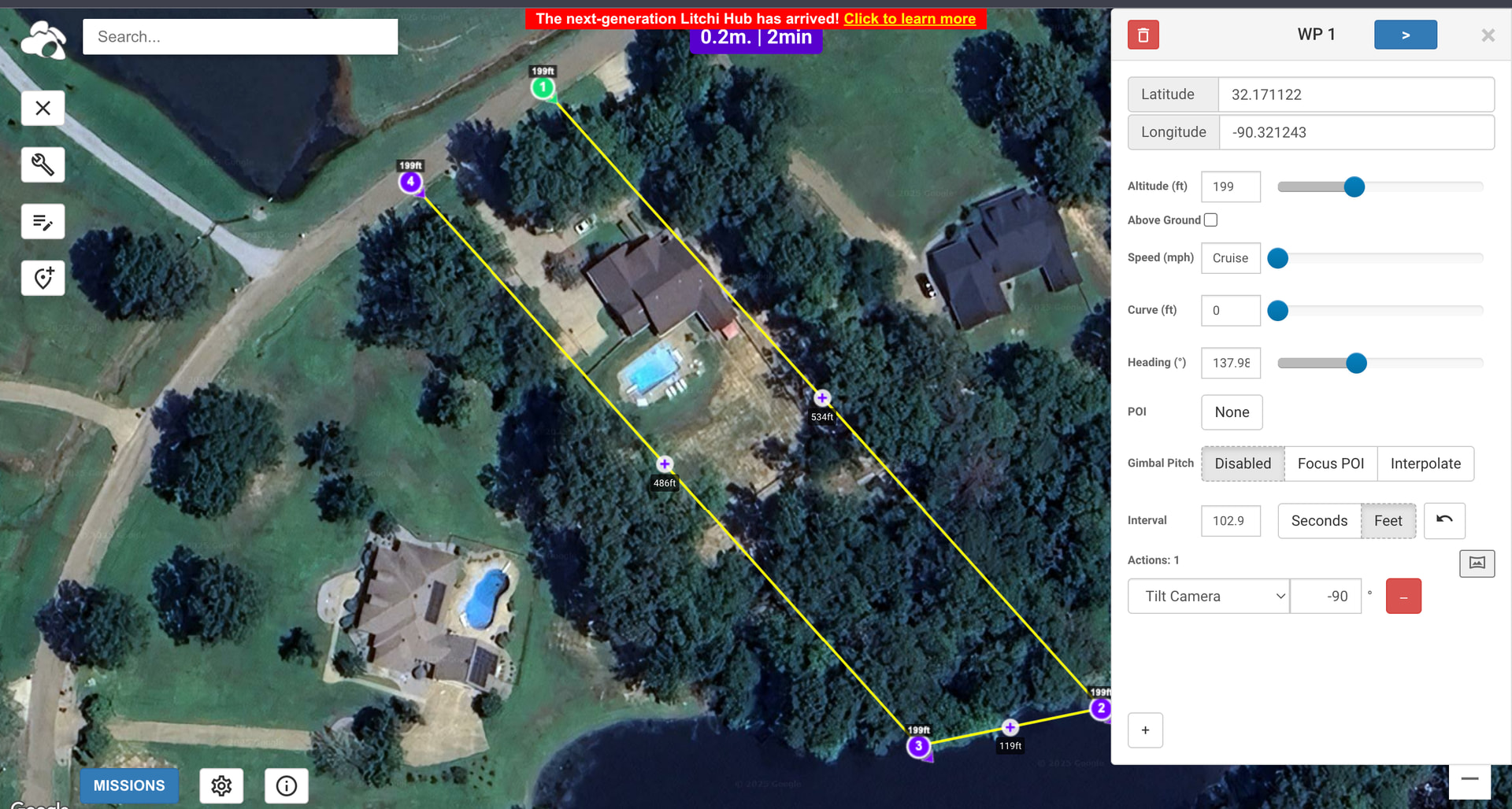

Thank you for the reply! See how in your screen shot it shows the little white circles along the flight path indicating where pictures will be taken, when I load that in the “old” hub, those disappear and when I load the mapping in the Litchi App to the drone, it will fly the route, but won’t take any pictures. Below is what I see when I create the area mapping in the “new” hub.
And this is what I get when I load it in the “old” hub.
And still not taking any pictures.
That’s normal and doesn’t change anything in the mission.
Also notice that the calculated interval is 102.9 feet.
At a speed of 10 mph (14.67 feet ps), this results in an interval of 7 seconds and should be no problem.

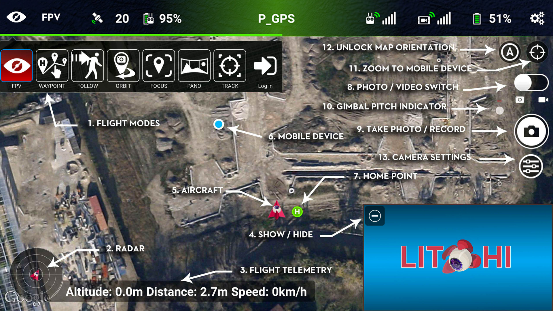

-Set the PHOTO/VIDEO SWITCH (8) to PHOTO
-Set the CAMERA SETTINGS (13) to the settings mentioned in my first reply.
-Turn OFF “Auto Record” in Litchi’s Main Settings->Camera Settings

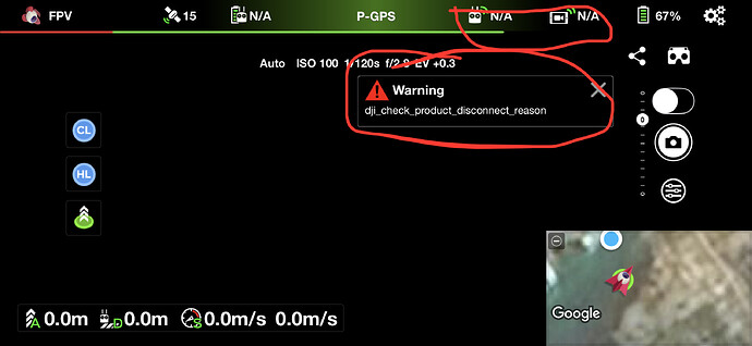

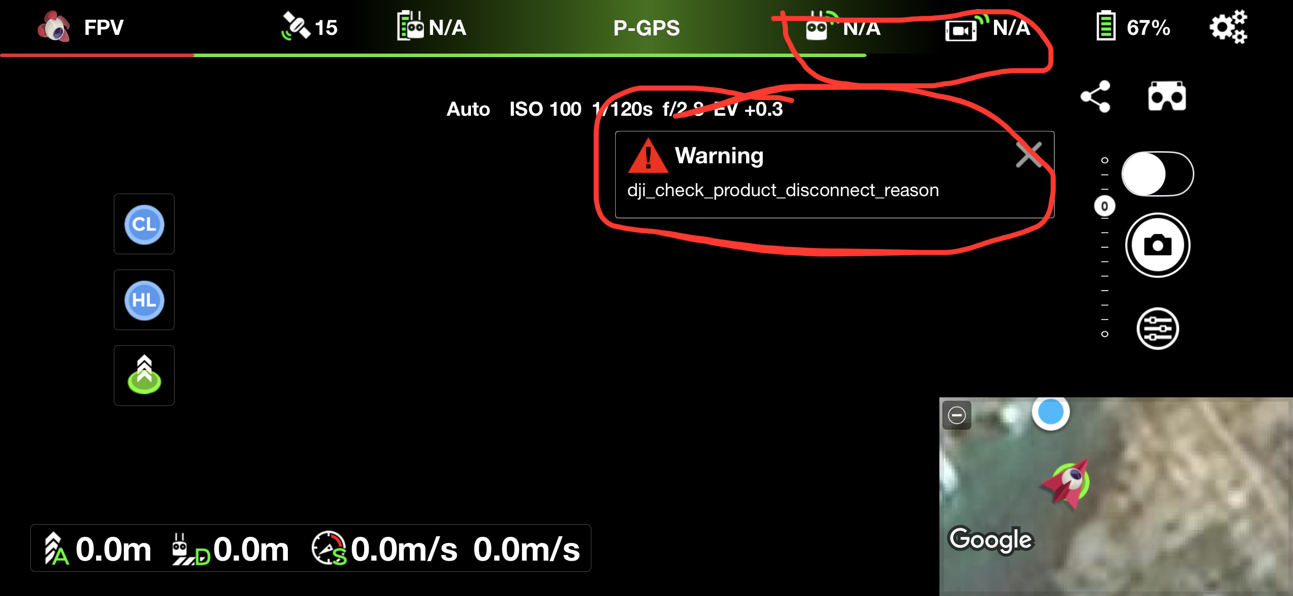

One other thing I have noticed, the app is not showing my remote signal strength nor my video signal strength. I also am getting a “dji_check_product_disconnect_reason” warning. Not sure if this has anything to do with the mission not working or not. I really appreciate the help!

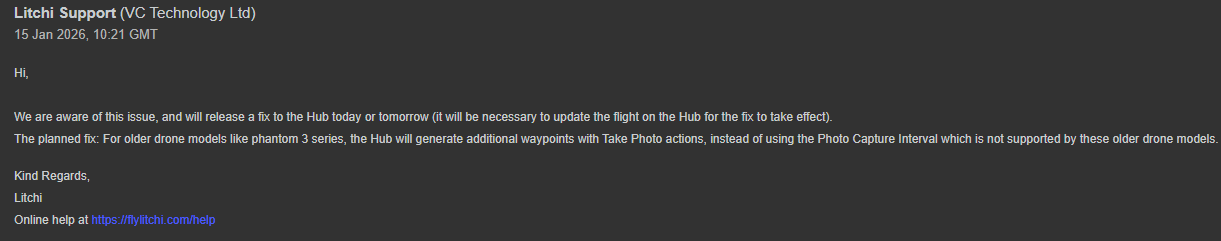

I sure do appreciate your effort in this! I submitted a request through Litchi Support to look into this further. I will update when I hear back from them.

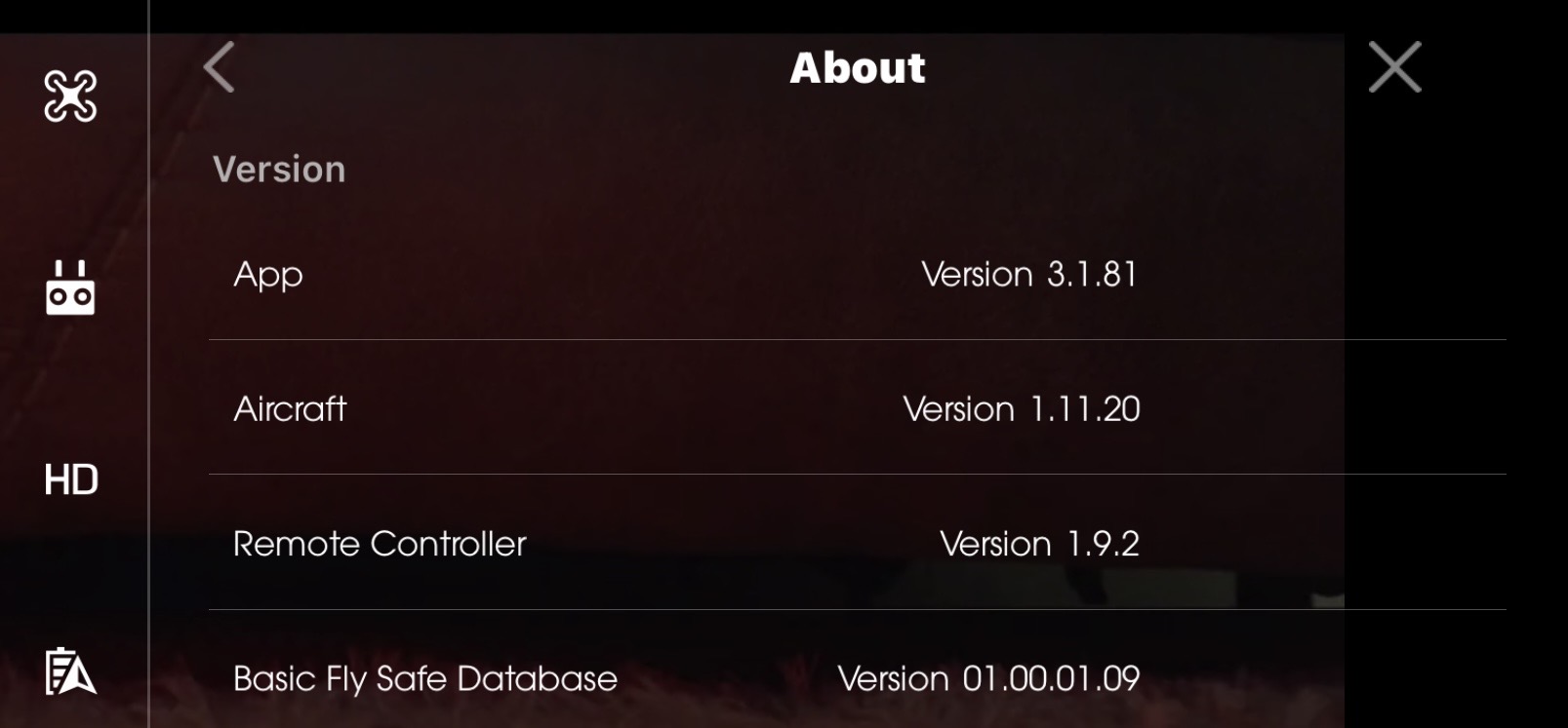

Appreciate it. Best I can tell from searching, I have all the latest firmware versions for the DJI GO app, the P3P & GL300B controller. Is there anything else I might be missing? ¯\_(ツ)_/¯. Thank you!!
I did get this message yesterday:
Hopefully, it will work!
The fix is released and live now.
For Phantom 3 and Inspire 1 series, Area mapping will now generate waypoints with Take Photo action for each required photo. This is because these drone models don’t support automated capture interval.
For any flight that was created prior to that Hub update, changing the altitude up/down will trigger a recomputation of the flight with the additional waypoints.
