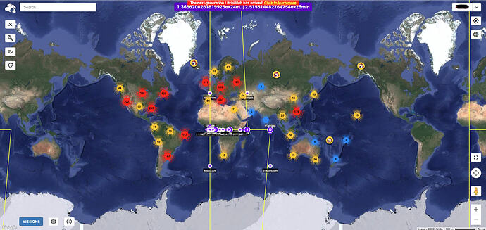

My issue; I was looking through my missions on the old hub and noticed my waypoints have been moved, and not just a few feet, it put my waypoints on other continents. I am in the USA. I attached a screenshot of what my missions look like now. I was wondering if anyone else ran into this issue and if there are any quick fixes.

If you have opened one of the missions in the new Mission Hub and selected a newer DJI Fly drone it will make the flight incompatible with the old Mission Hub. To fix this, open the flight in the new Mission Hub and select an older drone. The mission should then appear normal in the old hub.
This fixed it. Thank you!!
