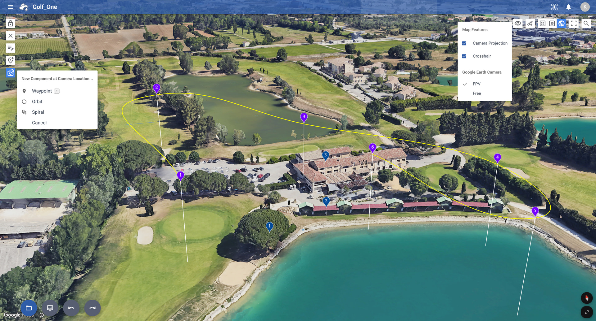

We’ve just pushed the following changes to the Hub:
Google Earth View
  • New “Add Component at Camera Location” feature
    Adds a Waypoint, Orbit, or Spiral at the exact location of the Google Earth camera.
  • New “Crosshair” setting
    Displays a crosshair to clearly show where the Google Earth camera is pointing.
  • Smarter POI altitude
    When adding a POI, both the ground elevation and the height of buildings or trees are automatically considered to set the correct POI altitude. In addition, moving the take off location (or first waypoint) now automatically recalculates the correct POI altitudes.
DJI Fly KMZ Export
  • New export shortcut
    Added a DJI Fly shortcut for quick KMZ export.
  • “Split into Multiple Flights” option
    • Each KMZ file contains up to 150 waypoints.
    • Helps prevent DJI Fly freezing when flights contain too many waypoints.
  • Interval Photo Capture Mode improvements
    • When Photo Capture Mode is set to Interval, we’ve significantly reduced the number of required waypoints.
    • The Hub also suggests the optimal interval time based on current flight settings.
    • (Note: Interval capture must be started manually in DJI Fly.)
