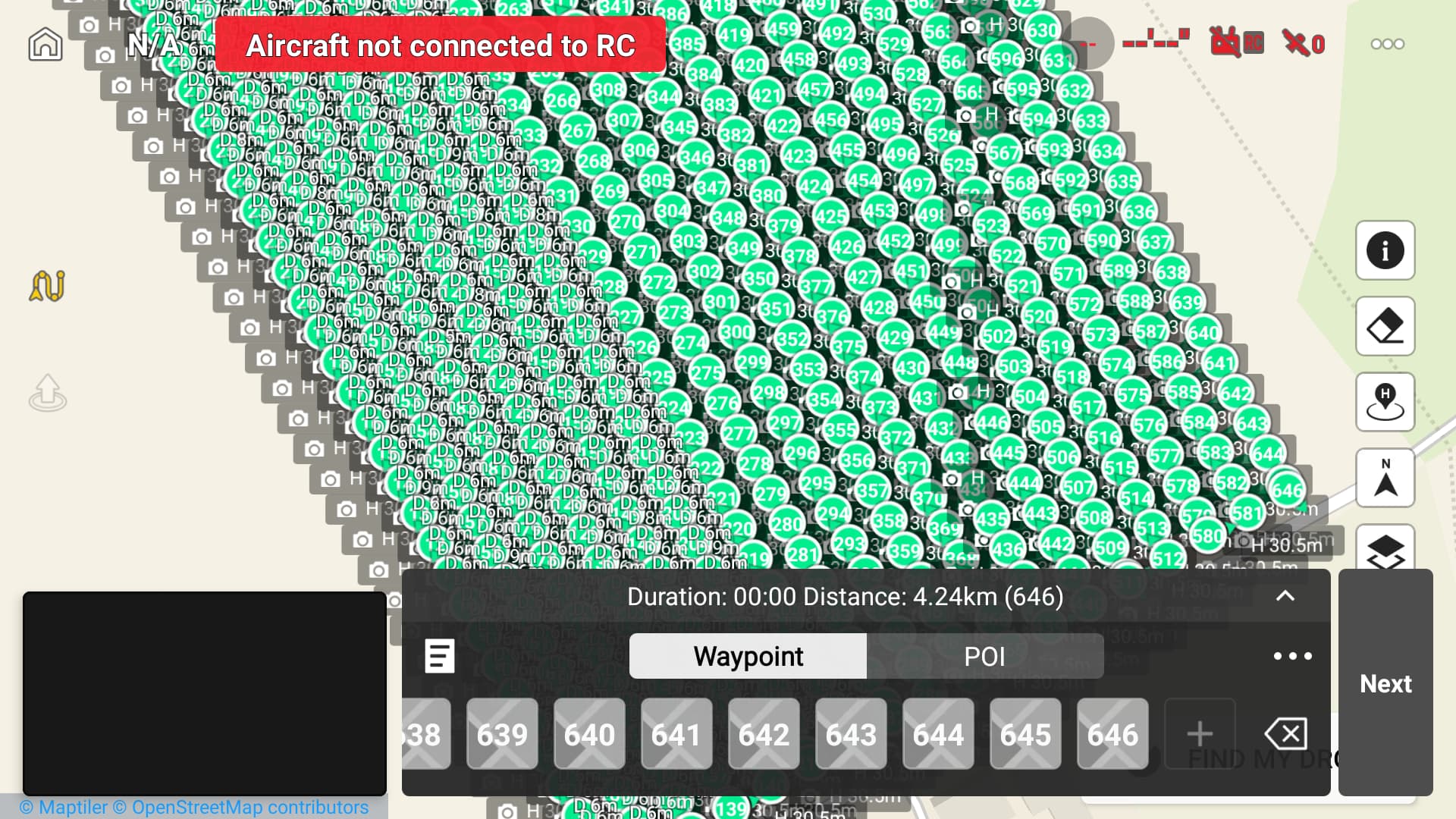

I did try with it set to sports mode but made no difference with the warning. While I’m not strictly speaking doing surveying/photogrammetry, I’m doing gaussian splatting, which I’d like to be as accurate as possible but isn’t strictly necessary for what I’m trying to create. I do think I may have come up with a workaround that alleviates my issues though. I made a large area mapping mission that’s almost 900 points with it set to photo action, this mission basically doesn’t load at all, causes the app to crash, fans to max out, and can’t properly load a new mission until the drone is restarted. I switched the mission to video instead, which results in a massive reduction of waypoints (880 down to 80!), changed the 1st point to not start video, then started a 3 second photo interval, and worked perfectly! Obviously I’d love for the original method to work for me, but I can make do.
I’m in the same boat. Mavic 3 Classic, DJI RC Pro, photogrammetry missions. I too noticed larger mission will crash the app, so need to either hide the map view (use the compass view) or as you did, turn the mission to a video mission, remove the video recording on the first and last waypoint and set a interval photo.

Yes. Waypoint actions add a lot of code to the WPML data, making the KMZ file much larger. While the WPML language does support distance intervals, apparently, DJI has not implemented that function in their waypoint engine. If they did, distance intervals could be added to the WPML code just as they can be for flights flown with the Litchi app. For now, we seem to be constrained by the memory limitations of the flying device and partially supported WPML functions in the DJI waypoint implementation.

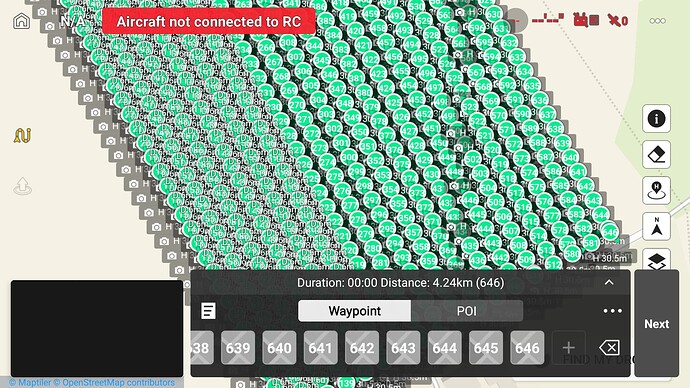

Anyway, in other news I’d updated the Fly app yesterday and it seems that even waypoint missions with over 600 points are now opening and are pretty snappy in the map.

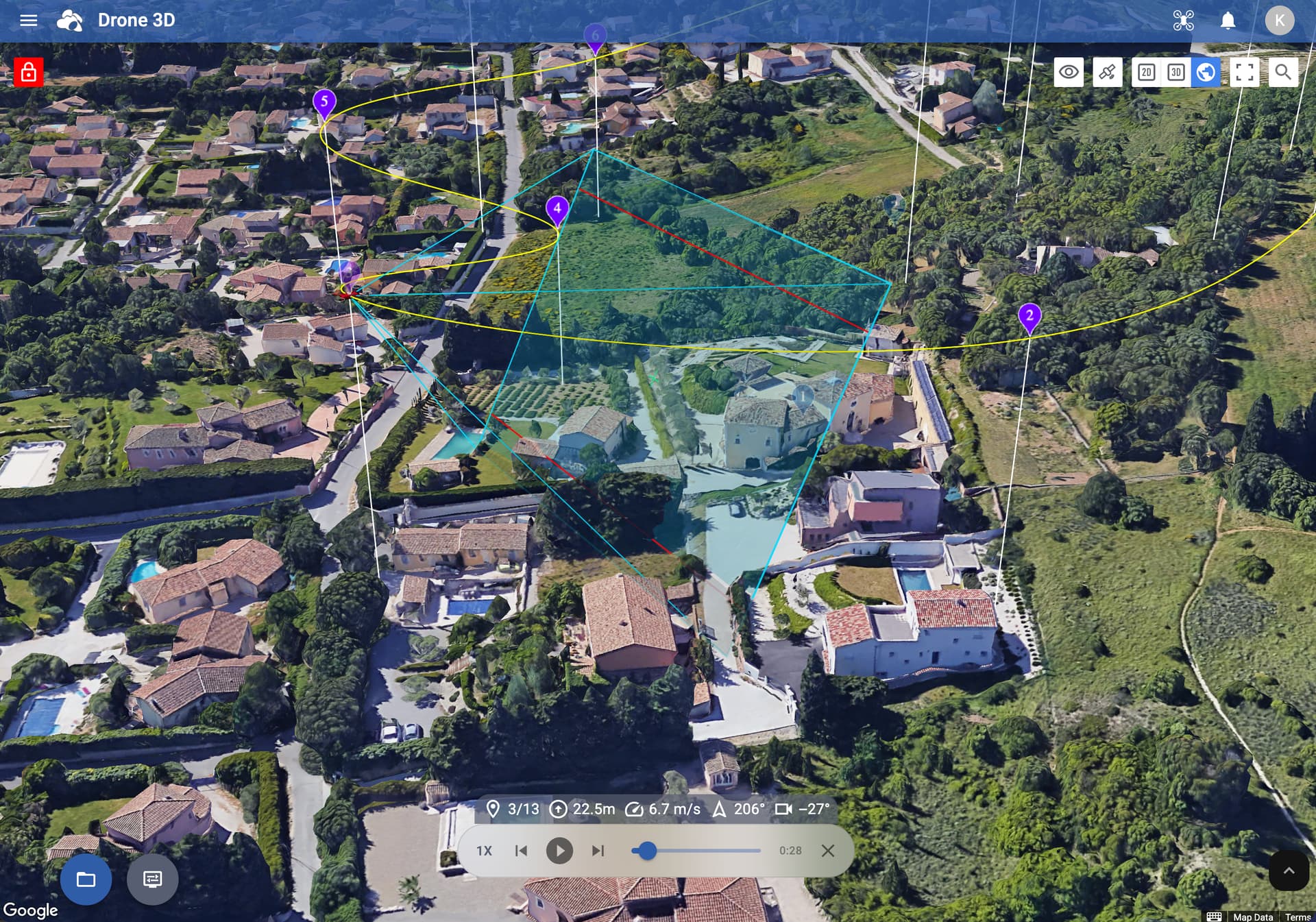

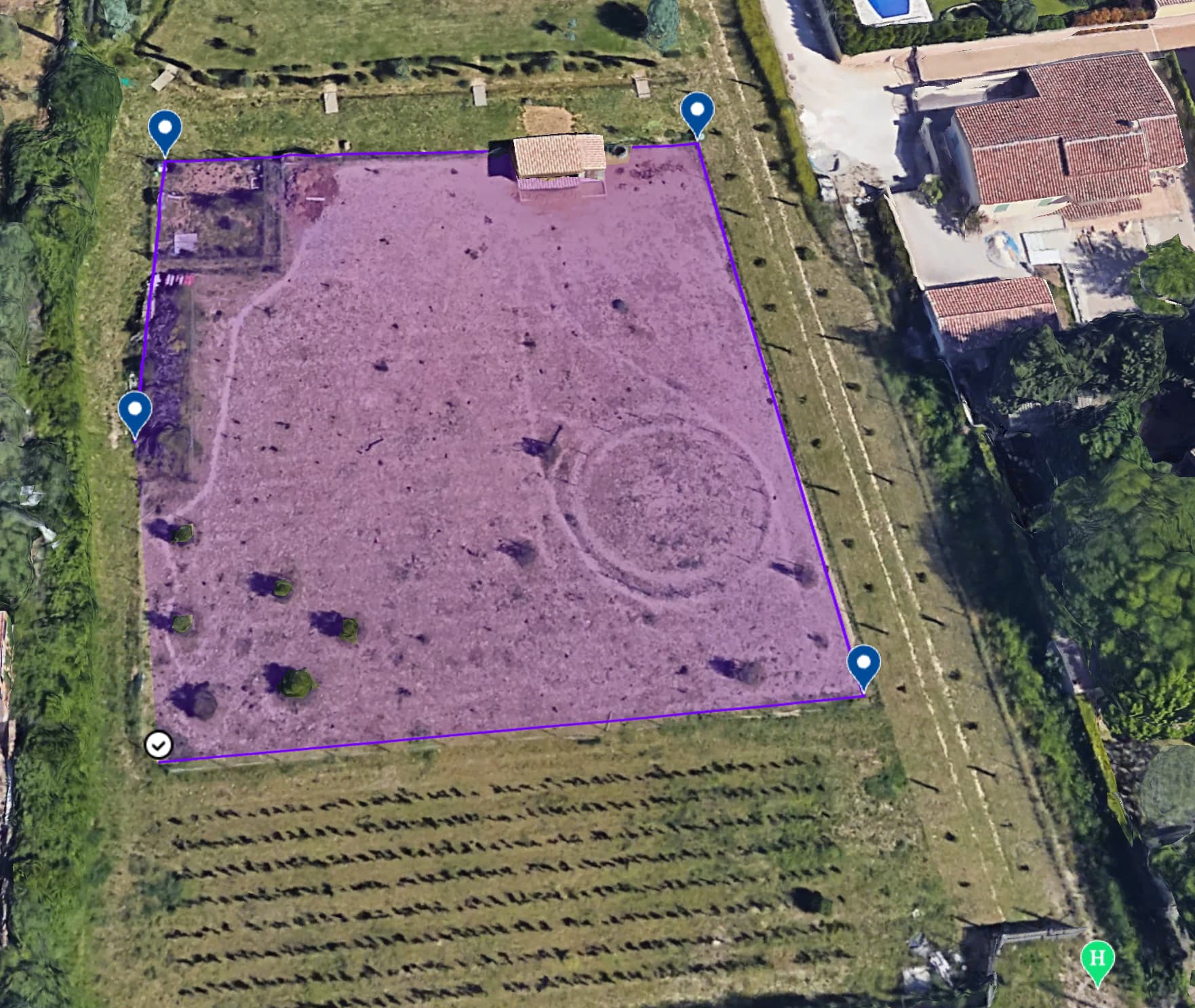

New Hub Update just released!
What’s New
Improvements
  • Improved handling of oblique gimbal angles in Area Mapping
  • It’s now possible to add components (waypoints etc) directly in the Google Earth view
  • Edge lengths are displayed on mapping area boundaries
  • Added a tutorial when creating your first Area Mapping flight
  • Speed warning shown for Area Mapping flights when the flight speed is set too high
  • Takeoff Point tooltip: hover or tap to see ground elevation at that location
Fixes
  • Fixed an issue where the camera could initialize at or below ground level in some areas when opening the Google Earth view
  • The last used drone model is now auto-populated when importing a CSV
  • Corrected inconsistent behavior when importing DEM files

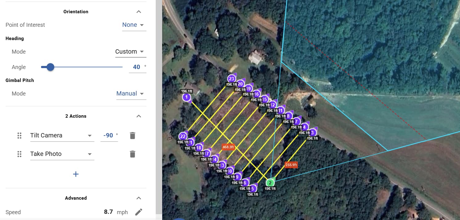

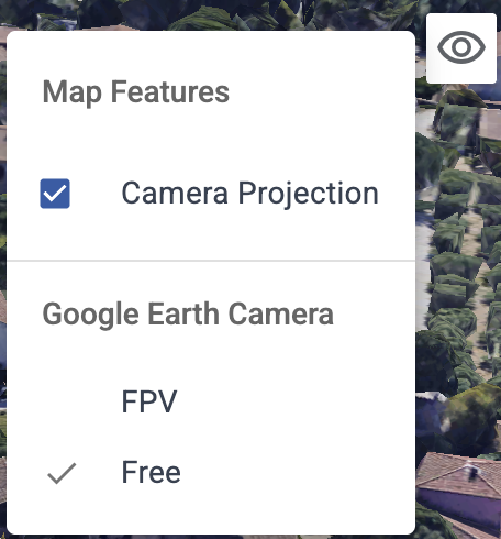

If the camera is tilted down -90° by waypoint action, should it still display the camera projection as if its facing forward? The projection simulation displays a forward facing view, even in 3D map view.
Currently camera projection is not supported for actions at waypoint.
