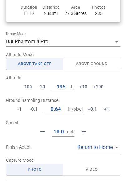

My area mapping mission configured for photos automatically switches to video mode and records. Phantom 4 Pro. I apologize if this drone series is documented somewhere as incompatible with mapping missions, but what am I doing wrong?
Take the KMZ file of this mission and unzip it. Open the “waylines.wpml” file and look at the “Action” block of the first waypoint. See if it includes a “Take Photo” action or a “Start Recording” action.
Or, send the file to me so that I can have a look.
Turn Off “Auto Record” in the Litchi App Settings.
Ah yes - thank you very much. I feel dumb.
And @wesbarris - thank you for your input and willingness to help.

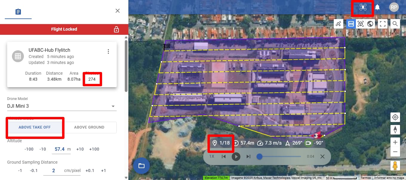

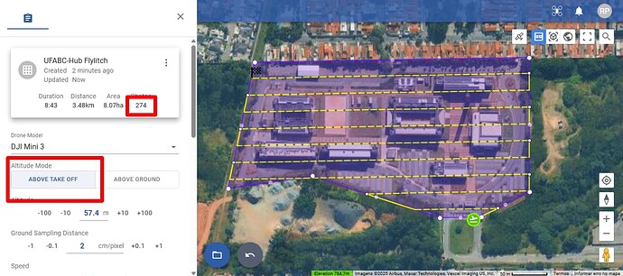

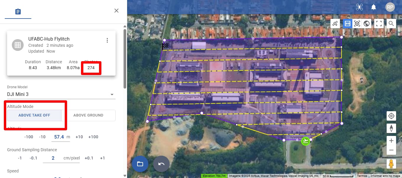

I haven’t yet field-tested the new Litchi Hib, as I noticed in the flight plan that it has some issues. I’ll post screenshots and share my impressions:
Using the “Above Take Off” option
We noticed that 274 photos are planned, while in the simulation only 18. Am I confusing photos with the number of waypoints?

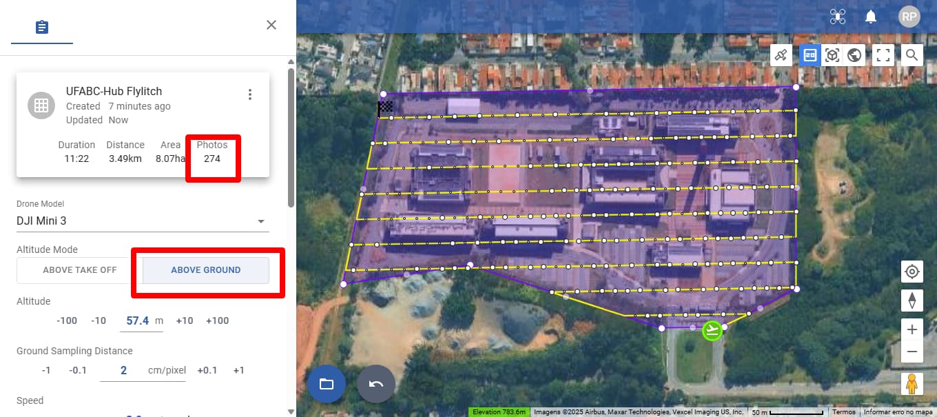

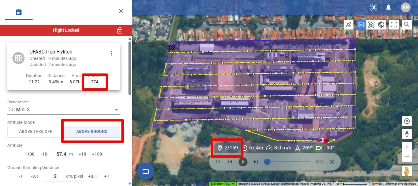

Using “Above Ground” option:
We also notice that 274 photos are planned, while in the simulation, 159. What I also notice is that it follows the terrain leveling, but there are large blank spots where the drone will skip capturing images. In this specific case:

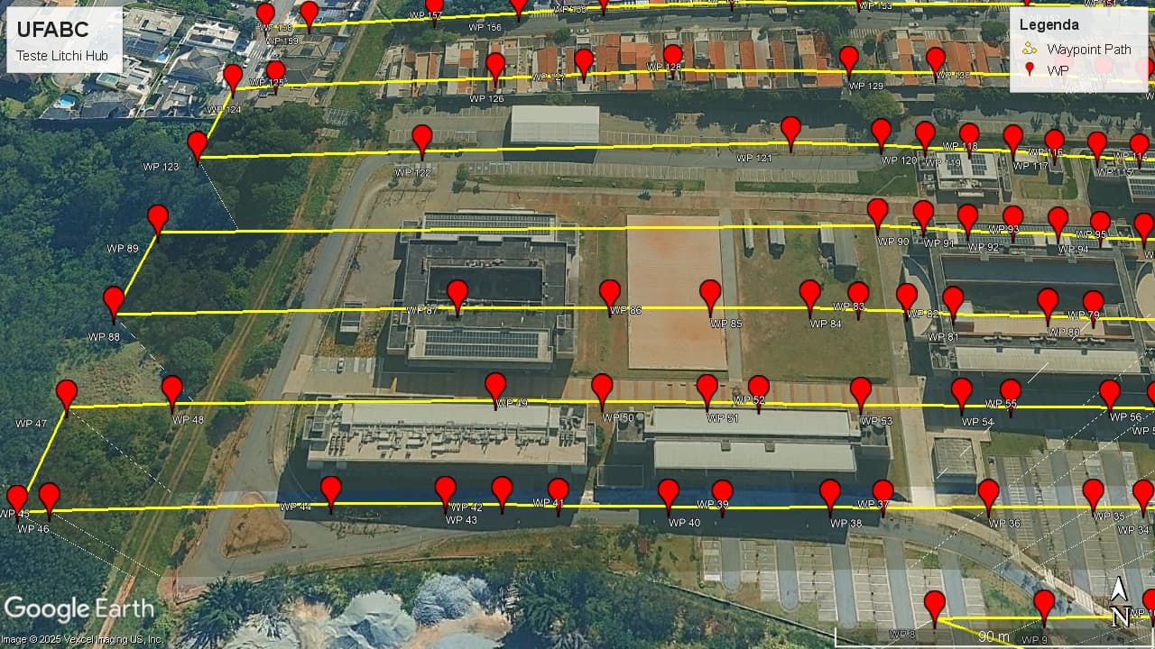

These blank waypoints are evident when we export to Google Earth:
We noticed that there is no logical or uniform filling in the path, for example, the path from waypoint 89 to waypoint 90 is more than 189 meters!

You are indeed confusing number of photos with number of waypoints. The drone will take multiple photos between waypoints where possible. The waypoints are placed where required to follow elevation changes. If the elevation does not change then no waypoint is needed.
Thank you very much for the quick response. I will test it in the future and send you feedback when possible.
Perfect, I see it now.

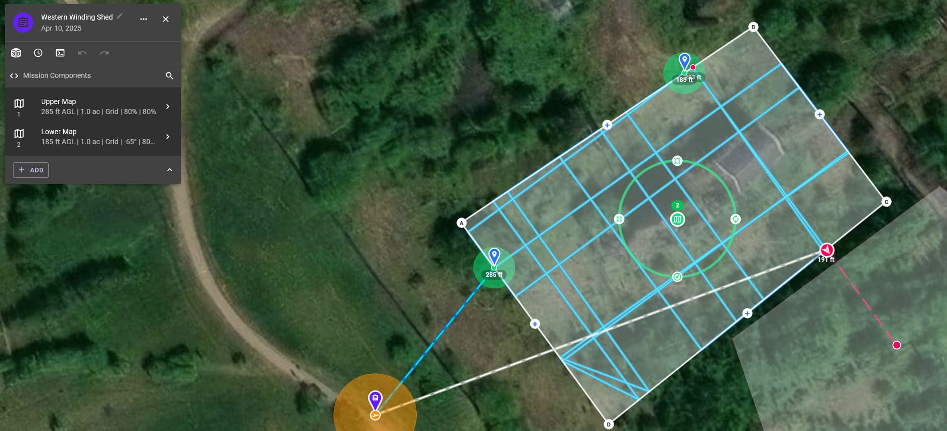

Is it not possible when doing a mapping flight to duplicate a layer, so that you can change it’s altitude and gimbal angle, for example start off with a layer at 285 feet, and a gimbal angle of - 90, copy this, change the altitude on the duplicate layer to 185 feet, and gimbal angle to - 65, so then the drone will fly the 285 foot layer, then descend to 185 feet and fly that layer
You can duplicate the mission, then edit the parameters (altitude, orientation, gimbal pitch, etc) of the 2nd mission.
I do that quite often.
Yeah appreciate that one @Sam_G, I was thinking of keeping it all in one mission like you can in other mapping software
I see.
I like to have missions pre-planned, to make it easier (quicker) to load and fly.
When the CSV export becomes available, it will be easy to export and combine various mission types into one.
