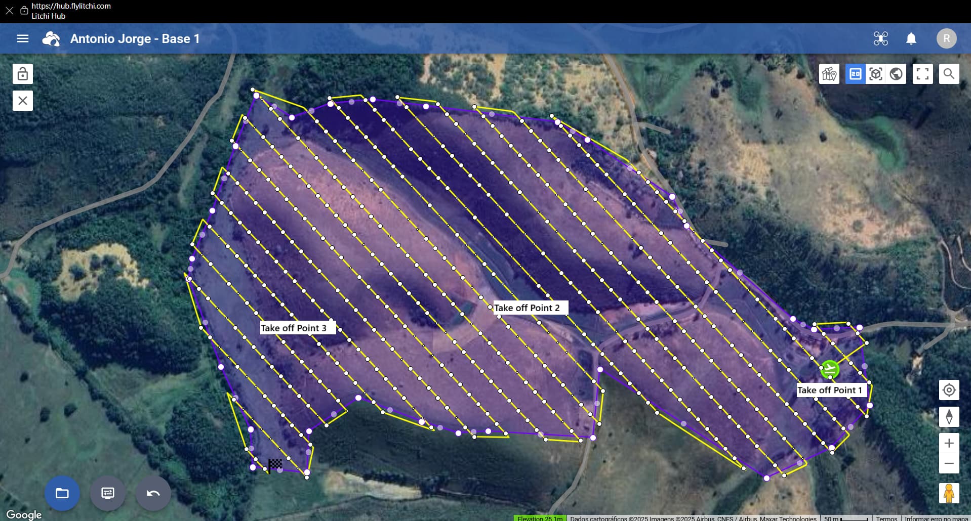

I believe it would be essential to have the ability to change the takeoff point without modifying the flight path. An option to “lock” the route would be very useful, keeping it fixed while allowing flexibility to choose the takeoff location.
This would greatly help with battery optimization, since the best strategy is to take off from the closest point to where the route begins. Currently, if I need to land and replace the battery, I must restart the flight from the original takeoff point to avoid issues with terrain following.
My suggestion is to implement a way to “lock” the flight plan, so that when moving the takeoff point, the altitudes of all waypoints are automatically adjusted to the terrain. In addition, it would be very helpful if we could also manually select the waypoint where the flight plan should start.

We are thinking of adding a feature that recalculates the waypoint altitudes just before starting the flight based on the actual take off location. This should solve your issue as it would mean you can take off anywhere and the waypoint altitudes will be adjusted automatically.

The idea is to save the elevation data for an area (perhaps 100x100m?) with the mission so it can work offline.

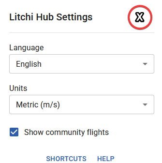

Feature Request: To be consistent with other dialogs in the Hub, the “Litchi Hub Settings” dialog should use an “X” for closing the dialog instead of requiring the user to click outside of the dialog to close it.
