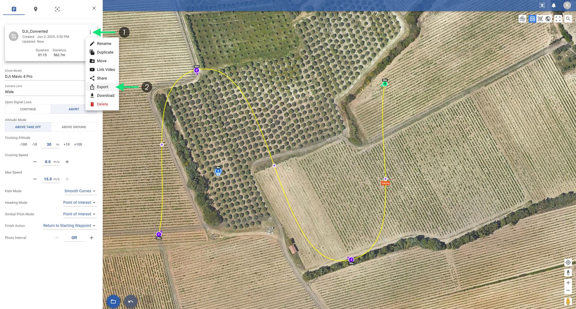

1. Plan your flight in Litchi Hub
Head to https://hub.flylitchi.com/ and open the Flight Library (blue folder button in bottom left corner). Then click on “+” and “New Flight” to create your waypoint flight making sure to select your supported drone model and DJI Fly app in the prompt.
You can then starting planning your flight within Litchi Hub and continue this guide when you’re ready to export.

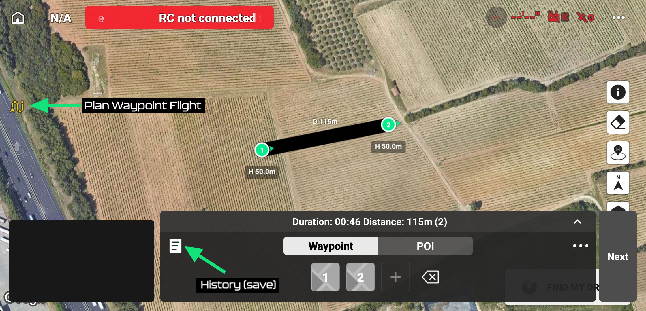

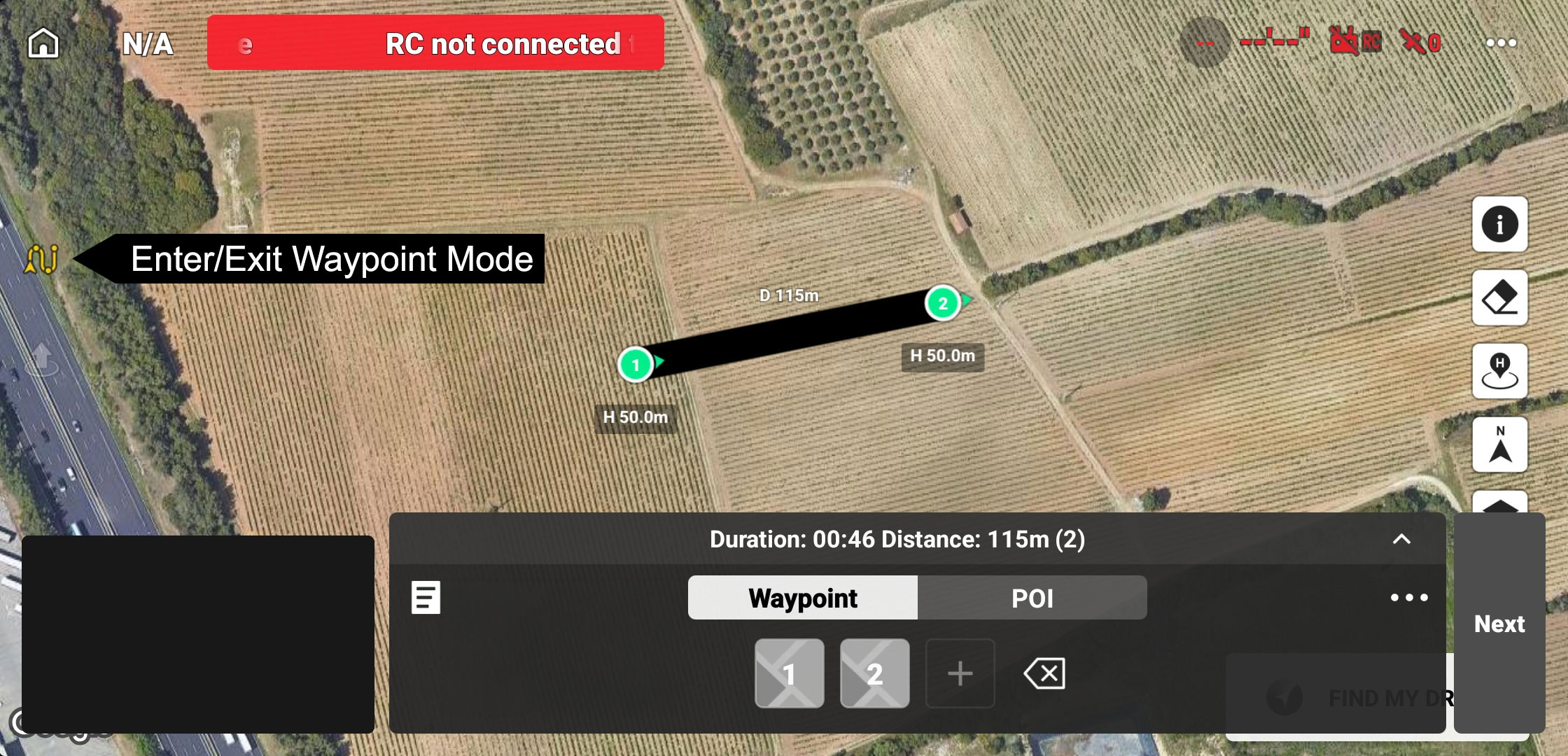

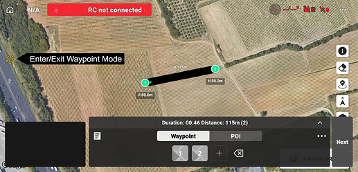

2. Create a waypoint flight in DJI Fly (optional for iPhone/iPad)
  1. Open the DJI Fly app (drone connection not required)
  2. Enter the Camera View then tap on the Exter/Exit Waypoint Mode button
  3. Place 2 waypoints on the map, preferably near the same location as the Litchi Hub flight
  4. Tap on the Exter/Exit Waypoint Mode button, then tap “Save and Exit” in the popup.

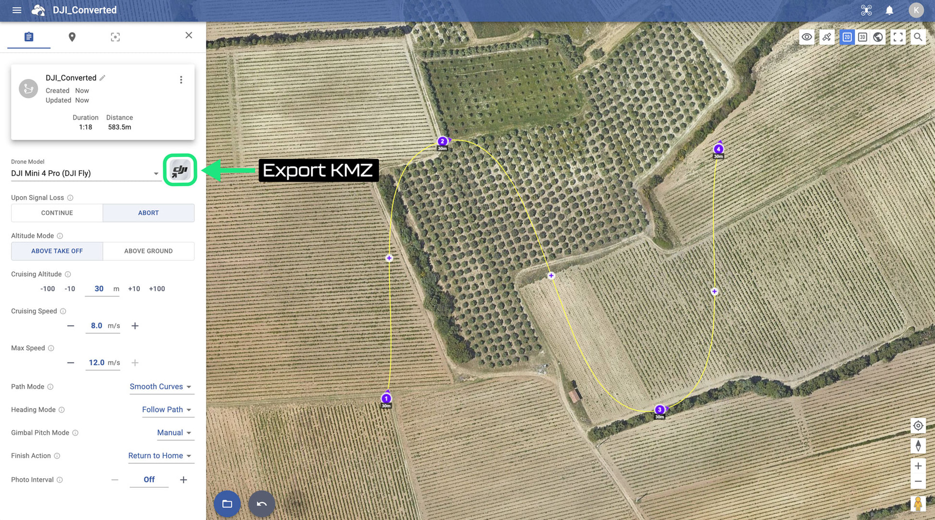

3. Export Litchi Hub flight to DJI Fly
In Litchi Hub, open the flight settings and click the blue Export button.

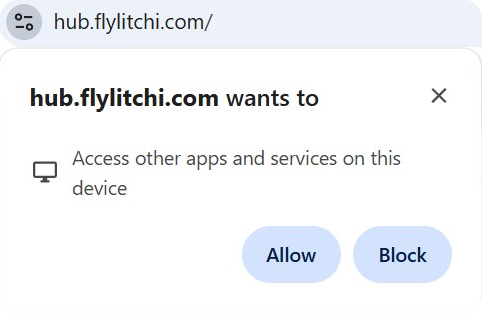

Some browsers (Chrome and others) will ask you to grant the ‘Apps on device’ permission to Litchi Hub. This permission is required for Smart DJI Fly Export so make sure to allow it.

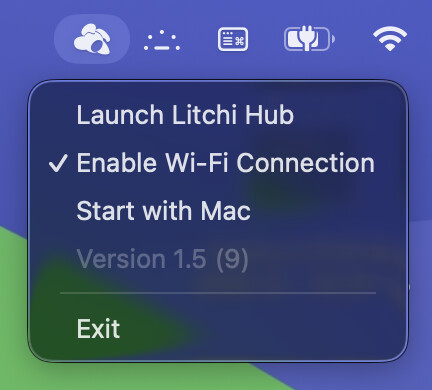

A. Smart Export using Litchi Hub Bridge (recommended)

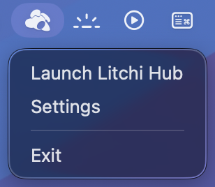

  1. Download, install and start Litchi Hub Bridge. Litchi Hub Bridge is a companion app designed to run in the background and lives in the system tray/menu bar. It includes a simple settings interface but otherwise requires no user interaction.
  1. Connect your device that runs DJI Fly (phone/tablet or the DJI RC if it has a display), unlock it, then select File Transfer USB mode on Android or tap Trust This Computer on iOS. You should then see your DJI Fly waypoint flights listed
  2. Select the flight to replace and click the “OVERWRITE” button. iPhone/iPad users can also chose to create a new DJI Fly flight instead of overwriting an existing one.
  3. The created or replaced flight will show the new Litchi thumbnail and updated status.

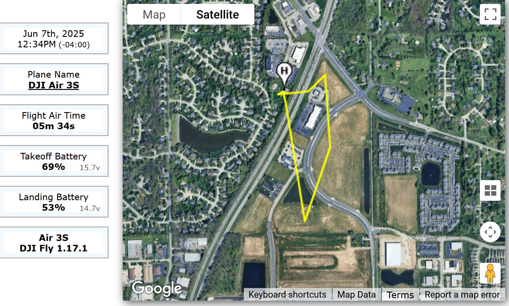

I downloaded a kmz file from hub 2.0 and used this technique to run a waypoint mission on my Air 3s. It flew a straight line mission without the usual rounding added by DJI. The drone also stopped at each waypoint. Is this the expected behavior?
I have previously used this technique with kmz files produced by Litchi mission utilities and a Hub 1.0 csv file. Those waypoint missions had the typical DJI rounding.
It is if your path mode is set to straight lines. If you sent the path mode to “Smooth Curves”, you should get your expected behavior:
