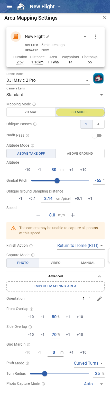

But today, while planning a 2D mapping mission, I saw that the Gimbal Pitch option disappeared…
This choice was very important because, in my case, I was doing a cross-flight with one nadir pass and one oblique pass.
Overall, I think the app is very good!
Change “Maping Mode” to “3D MODEL”

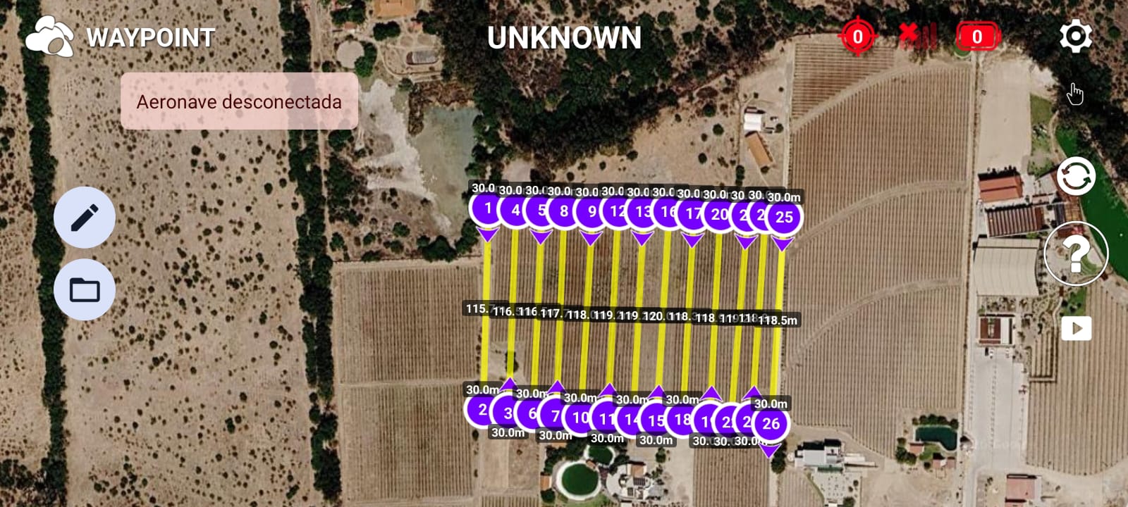

Today I tried my first automated flight using a DJI mini 3 and Litchi Pilot on a Redmi 10 cellphone. I tried first only a semi-rectangular path with smooth curves and it worked beatifully! Thank you.
I noticed there is no way to automatically create a grid, correct? I did it manually, so next time I will try that, to scan a field.
You can create a grid/ mapping mission in Litchi’s Mission Hub and then fly it with your Mini 3.
Thank you. How can I create the grid automatically?
I couldn’t find any polygon nor an option for that, so I create waypoints manually.
You need to use the Mission Hub to design your mission, not the Litchi Pilot app:
Yes thank you, I understand that. What happens is that I cannot find the icon or the command in hub to make the grid.
I can place way points all right, but I don’t know how to proceed from there to make the grid.
