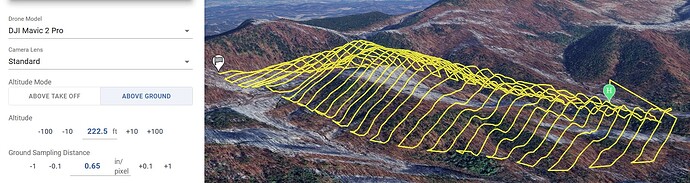

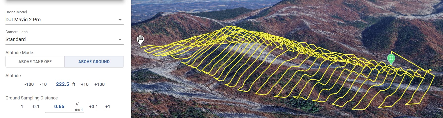

How do you make the track line curved like the example photo you shared?
In the Flight Settings, choose ‘Above Ground’ in the Altitude Mode.

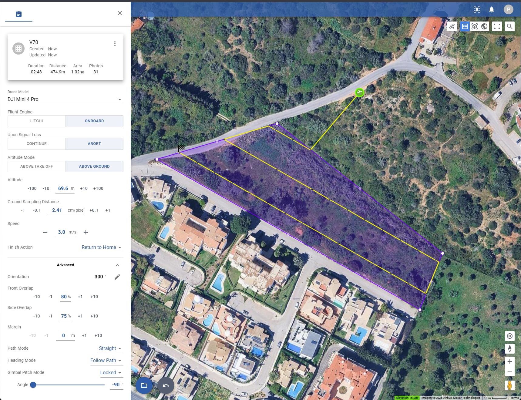

A useful feature in “area mapping” would be the ability to import your own polygons/areas, e.g. from a KML file, and the ability to switch the shooting from distance interval to time interval

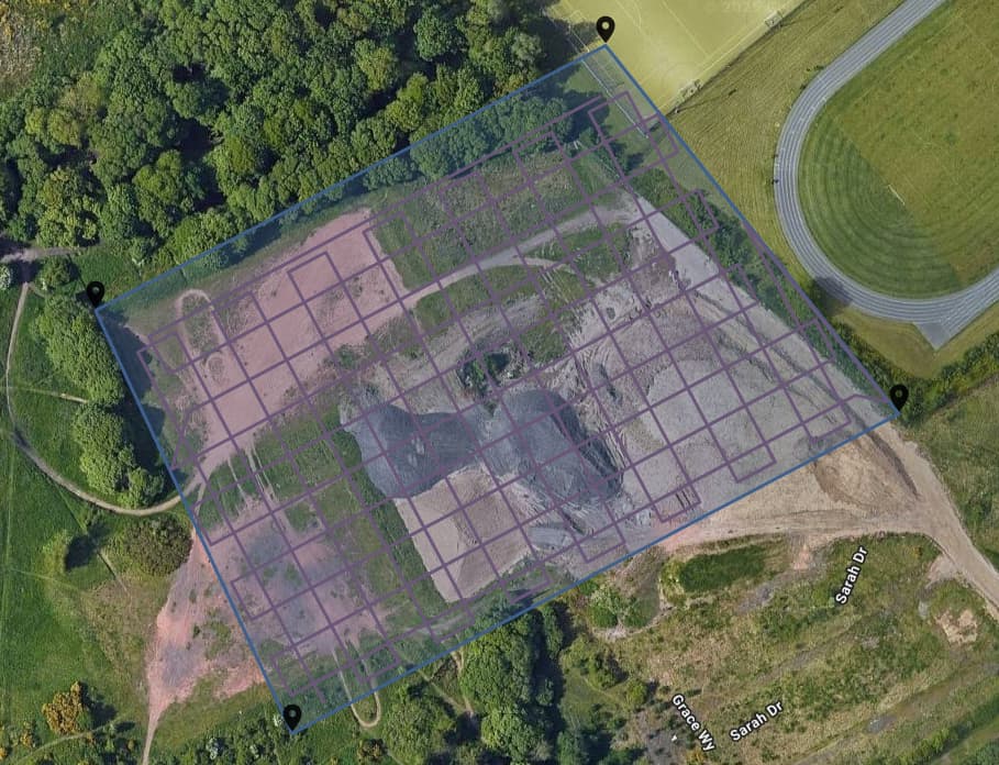

How do you create a grid mapping mission? Does this need to be done by creating two missions, one left to right and the other up and down?
I’m currently using DJI Mapper to create my grid missions but it would be fantastic to be able to created grid missions in the hub.

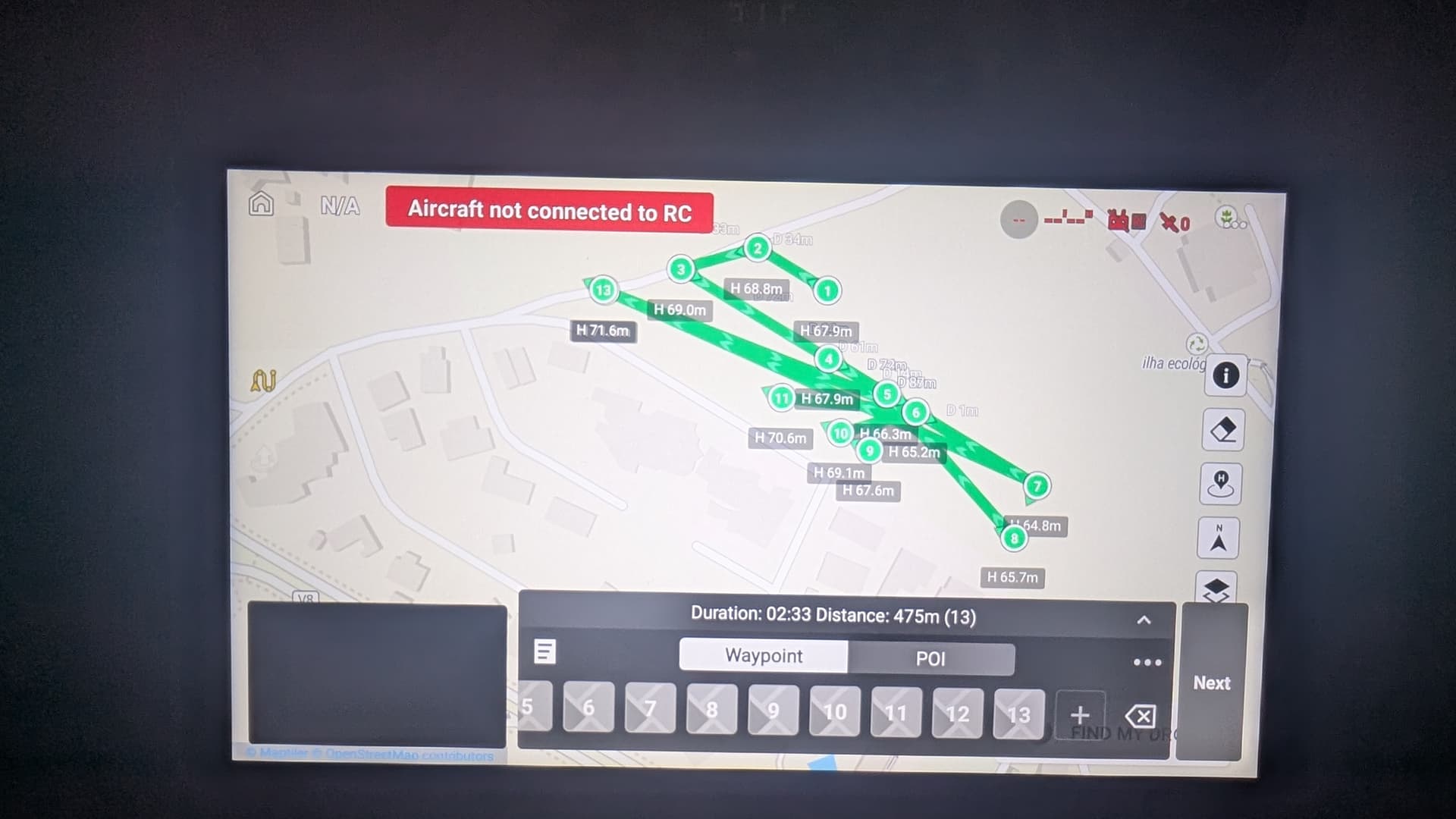

The first image is the map created in Litchi, and the second is how it looks when imported into the RC2, in addition to the fact that the number of waypoints created is random. Why 13 and not 31?
This is normal. For unknown reasons, DJI Fly displays straight line missions incorrectly. However, dispite the display, they will be flown correctly.
This is because some of the photos are captured using interval capture where no waypoints are needed. When the above ground option is used, waypoints are only used when there is a significant change in ground elevation.
In your case, since you are using DJI Fly, the mission will probably have a waypoint at each photo location.
