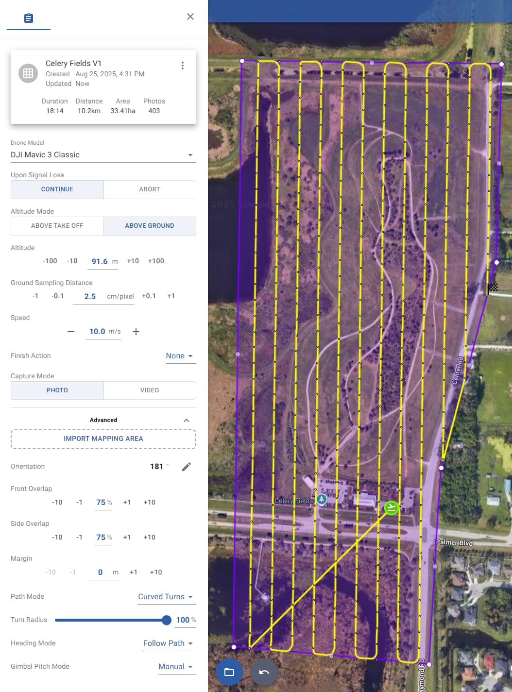

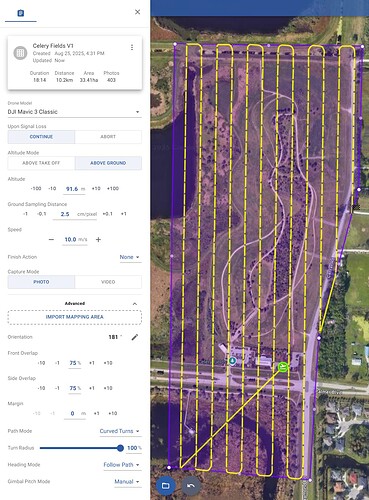

I got my Mavic 3 Classic a few days ago and flew my first area mapping test this morning with 2 missions overlapping each other, but one rotated 90 degrees to form a grid (I used DJI Fly of course). Each mission was only about 50 photos and seemed to work great. Then later I tried a larger grid mission with each one being around 300 photos, but had several issues that I’d like help with. When I load the mission and the drone goes to the first point it just immediately fails, but eventually it said something about more than 200 points, a limit I wasn’t aware of. I then tried splitting up the missions into <200 point flights, but then would have issues where it would just stop the flight at point 28 for some reason.
Is there an easy way to work around this point limit issue? I was using the ā€œabove groundā€ setting, but maybe that wasn’t a good idea either?
EDIT: I’ve done more research and testing and had trouble with a 150 point mission, but learned that there could be a gimbal pitch issue stopping it or a line trace limit? The total distance is around 8km so don’t think that’s it.

Sorry, I should have mentioned that I’m using the RC Pro, soon to be modified RC Plus. I have take photo set, but also have gimbal tilt set to locked at 75 degrees. Should I change that to manual and just dial that in before the flight since the tilt never changes? Here’s how I have it now, with curved turns to maybe help it out. Never mind about the curved turns, I realized that’s not supported on KMZ export.

"Curved Turnsā€ is short for Litchi’s way of handling curved waypoint missions. DJI Fly can handle either ā€œStraight Linesā€ or ā€œSmooth Curvesā€. I would recommend ā€œStraight Linesā€ for mapping missions.
I just tried running this with manual tilt and still could not get it to do anything other than going to the first point, taking a photo, then stopping the mission… I had backup versions that I split up into <100 point missions and just loaded them one after the other that worked fine, but way more work obviously.
