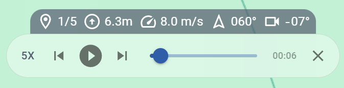

Simulation Enhancements
- The current waypoint index is now displayed during simulation
- Skip forward/back through waypoints
- The position slider works even when paused
- Added 5x playback speed
- The selected waypoint auto-updates in real time during playback

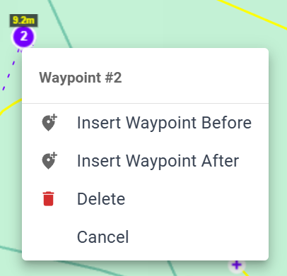

Waypoint & POI Context Menu
- Right-click on a waypoint or POI to access a quick action menu:
- Insert a waypoint before or after
- Delete the selected item

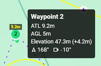

Waypoint Tooltip Improvements
- Tooltips now also show:
- Heading
- Gimbal pitch angle

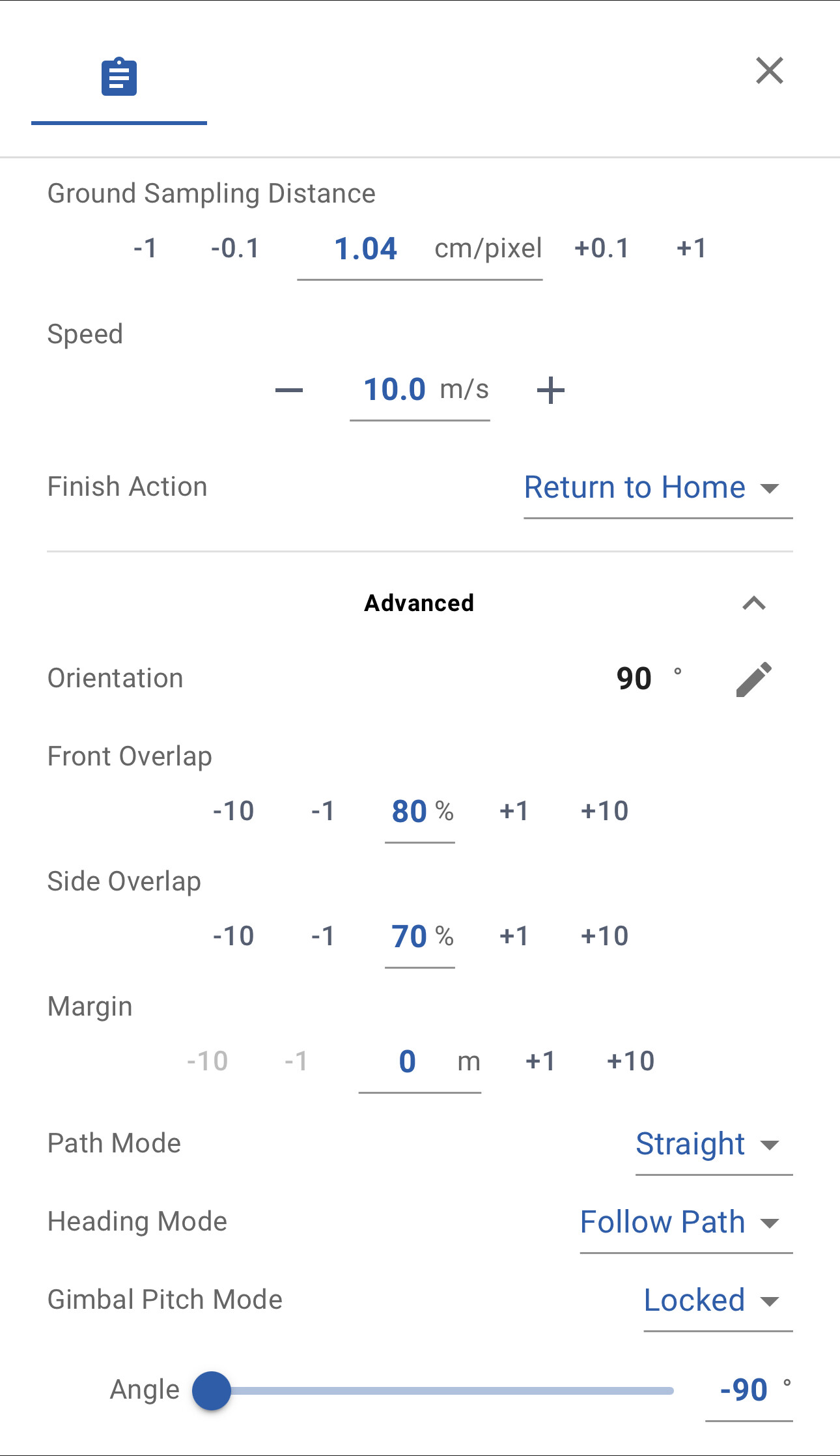

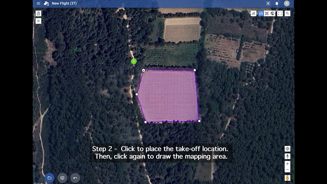

Weâve just added a new type of flight to the Litchi Hub - Area Mapping! Please make sure to share your feedback!
Get started video tutorial:
It is not clear how to specify the area to be mapped. Here are the steps I tried:
- Select âNew Flightâ.
- Select âArea Mappingâ.
- Select âCreateâ.
- Clicking on the map places what appears to be a green home point icon.
- Clicking anywhere else on the map repositions the green home point icon.
How does one specify the area to be mapped?
Check the video in the post above! After you place the take off point, clicking again should start drawing a polygon

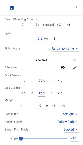

Can you specify or modify the percentages of overlap?
The front overlap can be changed by varying the photo interval. But, how do you vary the side overlap?
For me, multiple clicks just keep moving the home point around. Iâm using Firefox on Windows 10.
Found the issue, should be fixed - sorry!
