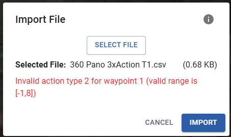

Import CSV - Panorama not supported
The Panorama Action code is 9, but when importing CSV, error msg says range is [-1,8].
2Reproduce:
  1. Create mission with a Panorama action.
  2. Switch to “old” mission hub (Mission Hub - Litchi)
  3. Export CSV
  4. Observe ‘actiontypeX’ to be 9
  5. Switch back to new/beta mission hub
  6. Try to import the CSV file
  7. Observe Error

Pano action is not actually implemented in Litchi Pilot yet. But we will fix the CSV import. On another note, CSV import needs to be updated to support new hub features, currently it only imports the old flight format.

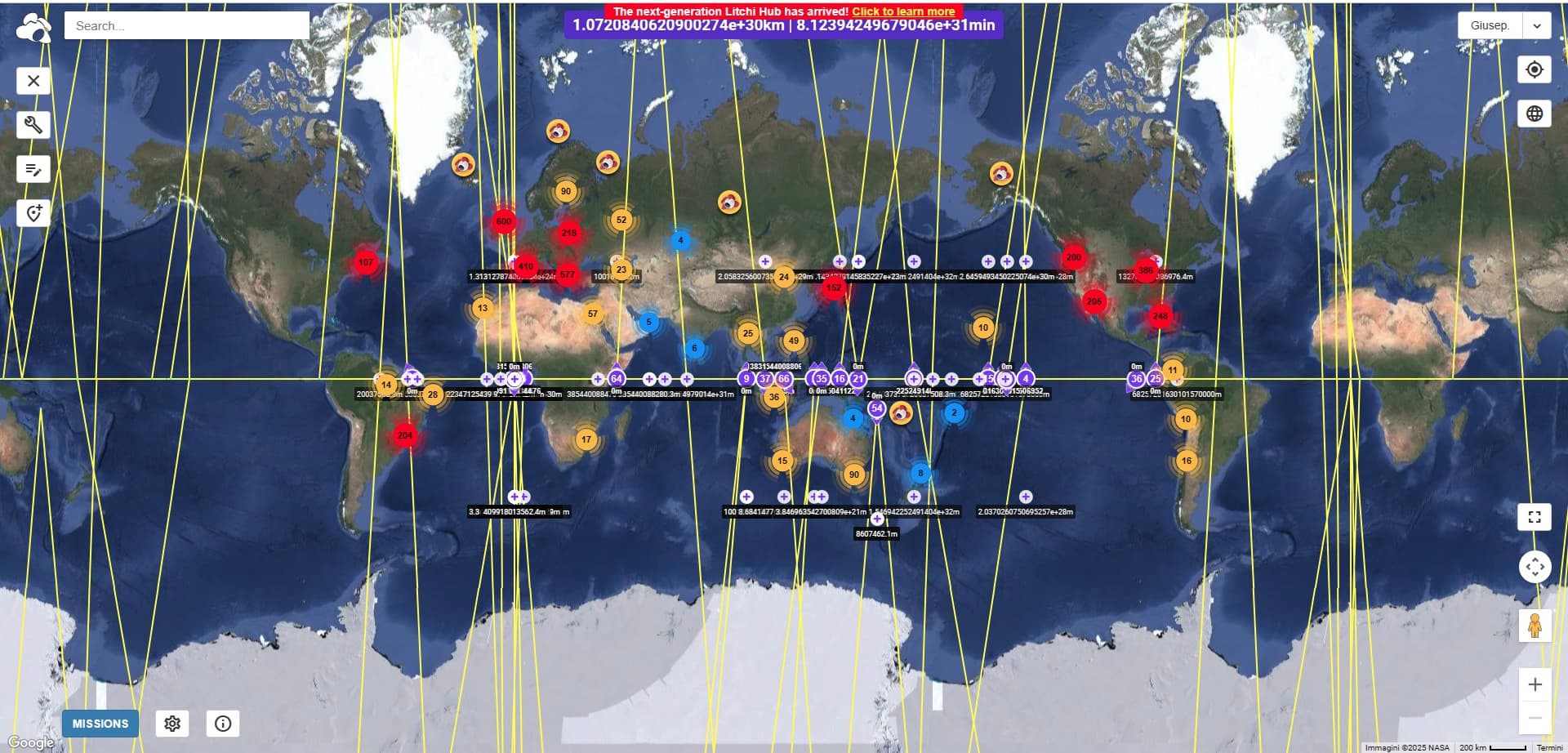

Good afternoon, I finished a mission in the new Litchi Hub mission portal and after checking with the simulator that everything was fine, I saved the mission with the same name. I exported .KML (only export at the moment) and downloaded the new .LCZH format (I don’t know what it corresponds to). Wanting to transform it into .csv with the old Litchi Hub when I go to open the mission it is not recognized and it opens all the waypoints on the equator!!! Why??? Is it normal and can it be corrected??
Thanks
As I understand it, this is because the legacy hub is currently incompatible with Hub 2.0 missions.
