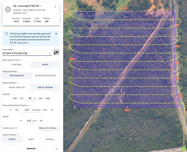

Suggestion: Perhaps a user-adjustable tolerance on the ‘Above Ground’ elevation option?
Height corrections seem to occur every 1 to 1.5 m. of elevation change along the route. For the ‘DJI Fly’ options this can easily put the waypoint count over 150 for a simple 16 min, 100m altitude, area mission over terrain with a 30m elevation change. If the correction was at 2.5 m change then this might be < 150 waypoints.
Also, the waypoints don’t seem to be visible in the editor when in DJI Fly mode. Therefore can’t assess whether the 150 count is exceeded until the file is exported.
Thanks!

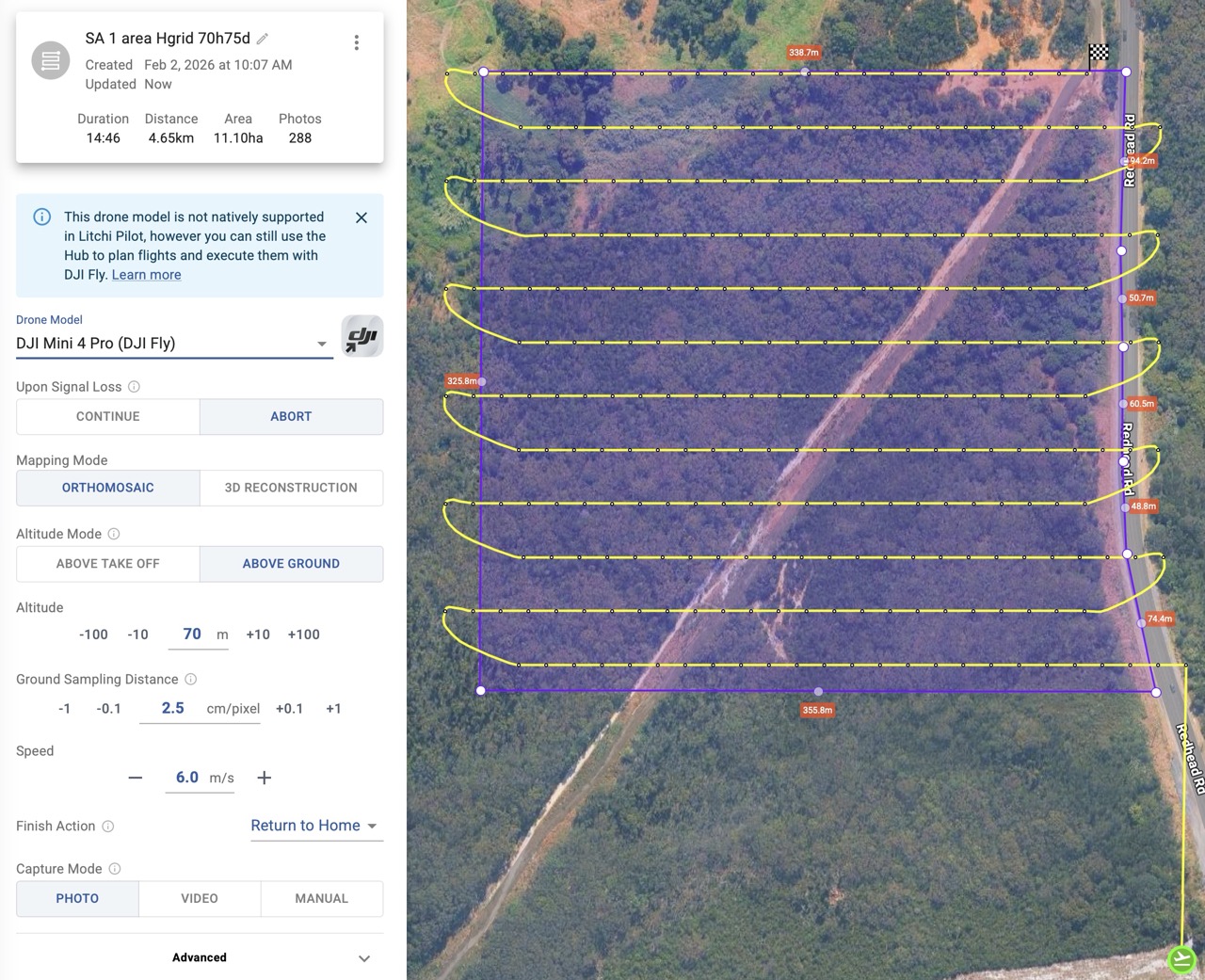

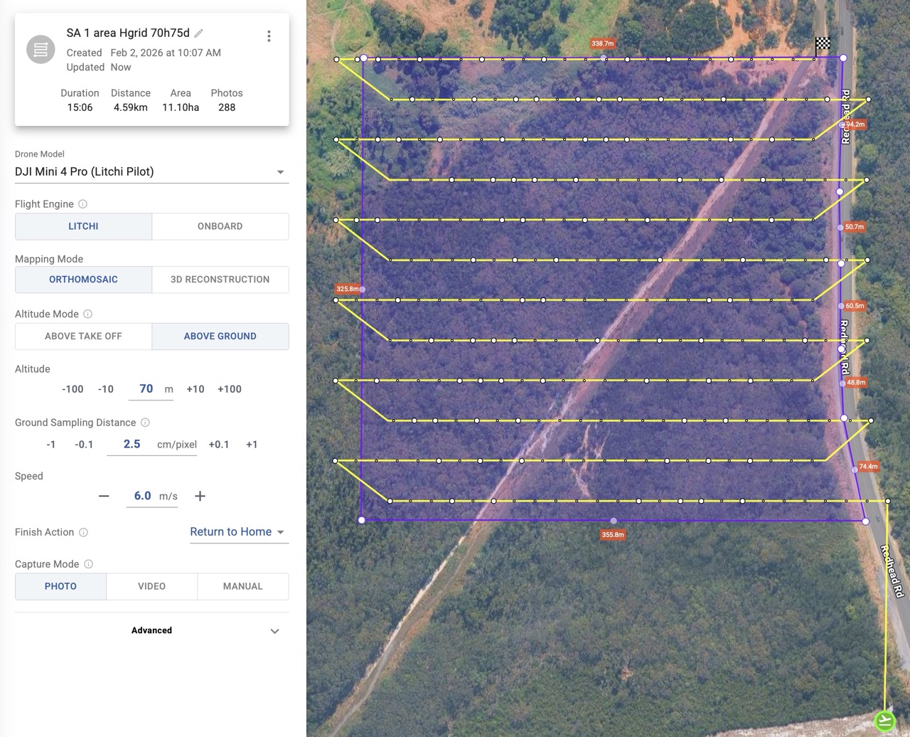

Hi Andrew. Regarding your question about waypoints not visible. I just tried selecting several different drones and all the waypoints are visible. Litchi Pilot, DJI Fly and Litchi for DJI Drones all show the waypoints regardless of which drone I select when using Firefox browser. Maybe send a screenshot of the issue. Also are you using a browser or the mobile app ? This may help to understand your issue.

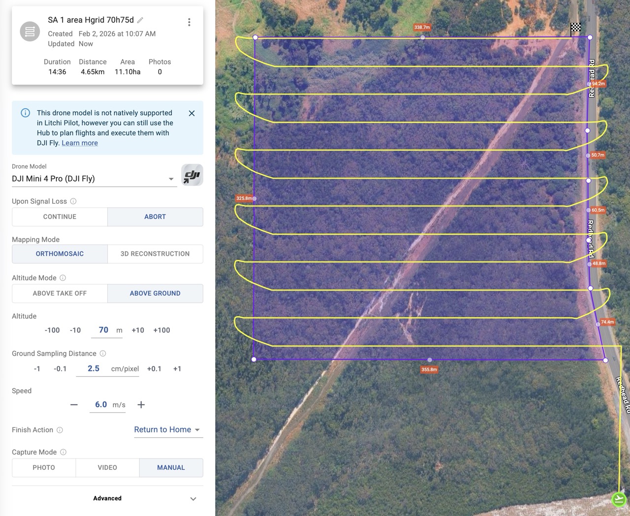

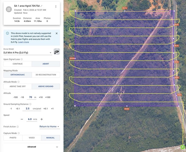

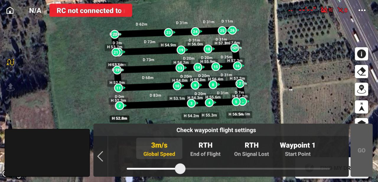

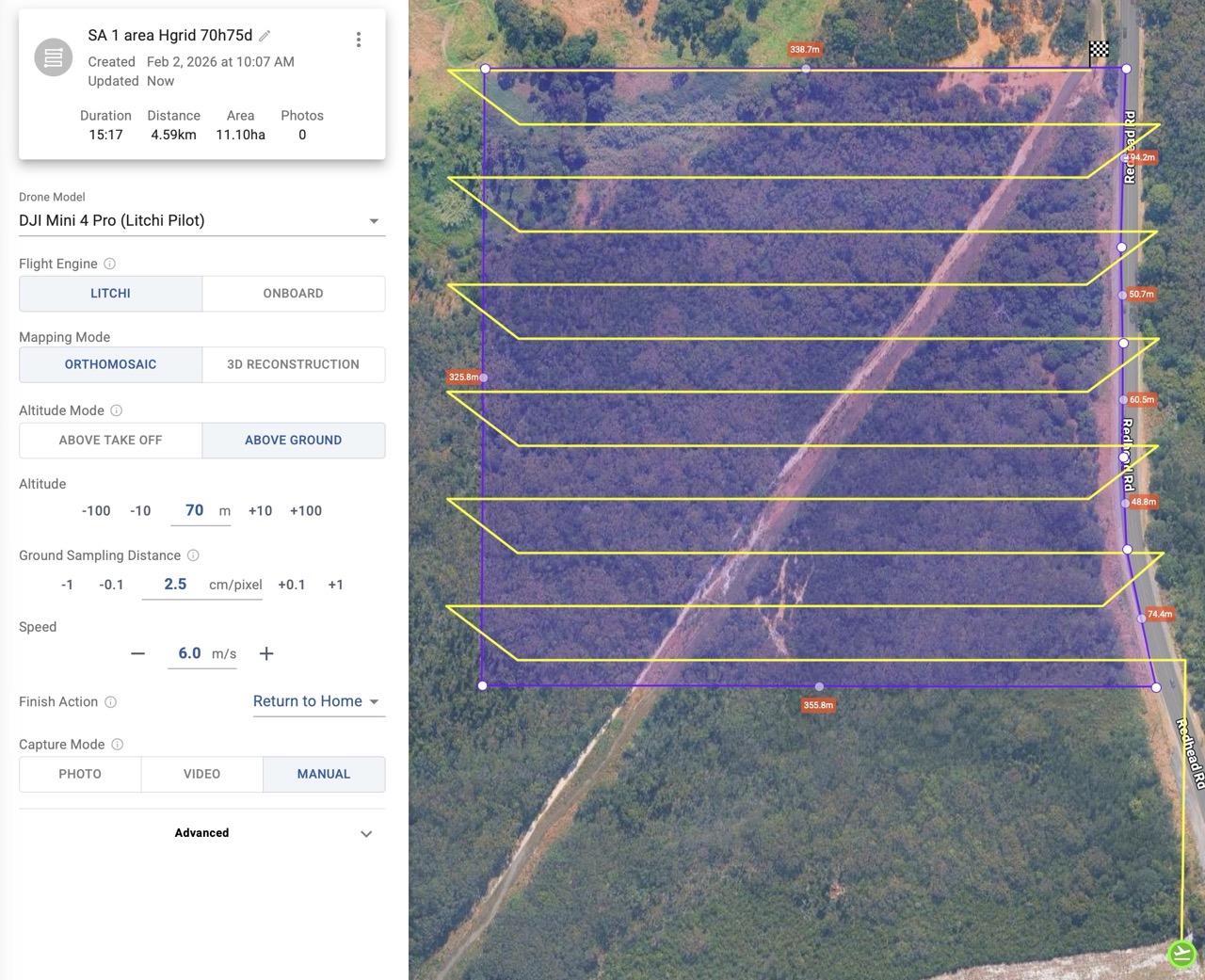

Here are 4 screen shots with various combos of DJI Mini Pro 4 (my drone) in Litchi Pilot/DJI Fly and Photo/Manual modes.
I can only fly in DJI Fly as I have an RC 2 controller.
The Litchi Pilot / Photo mode shows what I thought were the waypoints along with the photo locations. I now think these are only the height correction points, i.e not all the waypoints.
This is in Safari on a Mac M4 Pro Tahoe. Same behaviour in an Arc browser (Chrome based I believe).
[edit] Just noticed that all waypoints are visible in Photo Capture Mode → interval. I think they should be visible regardless of mode :slight_smile:

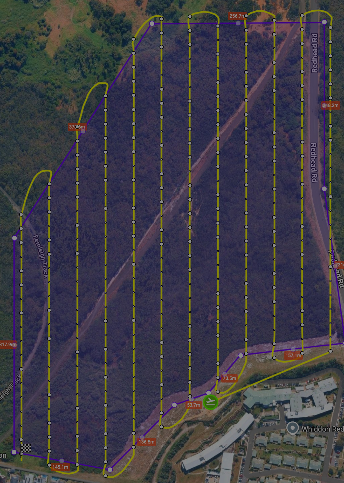

I understand. The need is related to the original post. I’d like to do an ‘Above Ground’ mission but this creates a lot of additional waypoints that then trigger the ‘split the mission’ warning. Waypoint visibility is so I can see how many points are course direction vs course elevation. Example below has 201 waypoints (the larger dots) and the ground does not vary that steeply to warrant it (I think, but still learning). My suggestion was to have a user-selectable tolerance for how frequently to correct elevation.

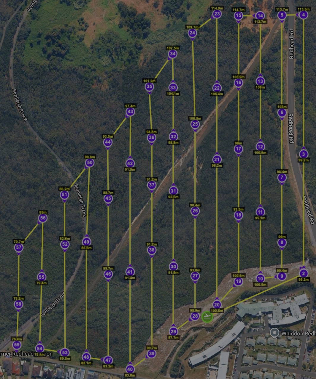

I got around this for this mission by: exporting as KMZ → converting in Mission Utilities to CSV → open CSV and then thin out the number of elevation waypoints to 2 or 3 per leg based on my knowledge of the terrain. Got it down to 60 points (2nd image) and it flew fine for my purposes (gaussian splat model after forest fire) except the battery alert after point 52.

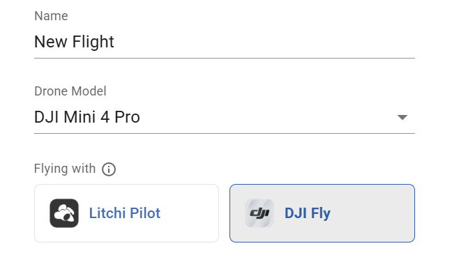

  • New “Flying with” setting
    You can now select which app you will fly with when creating a flight. The selected app determines available flight settings, compatibility, export format, and overall flight behavior.

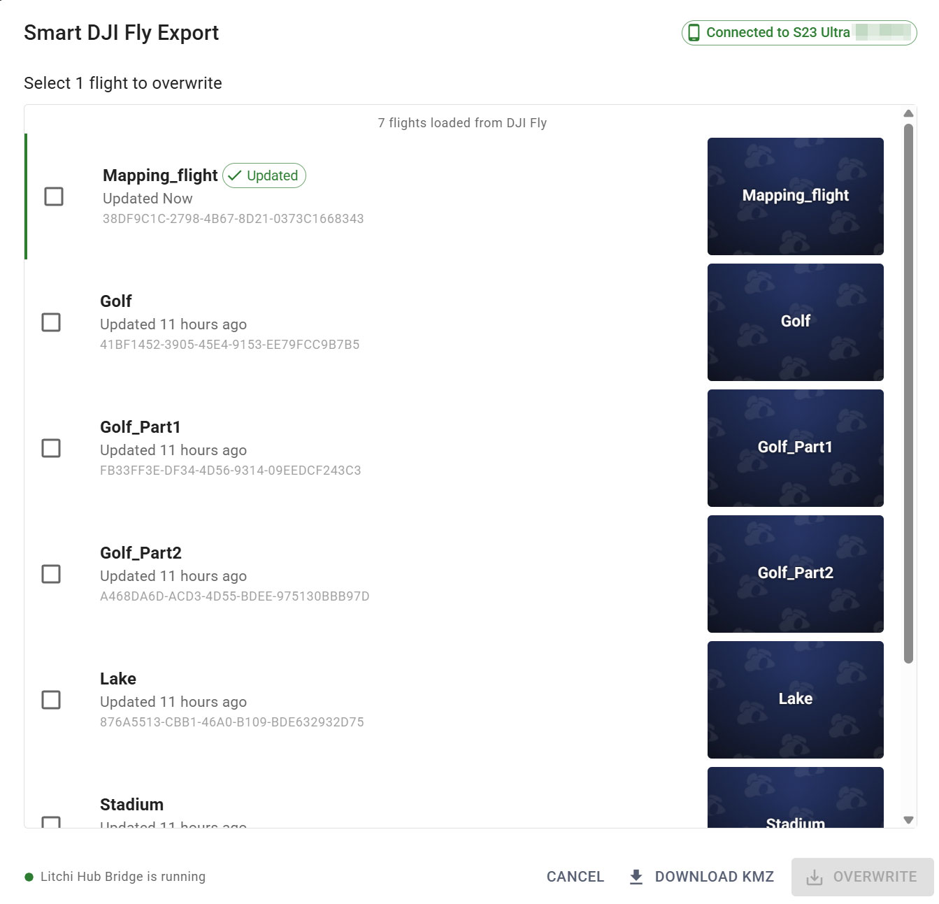

Smart DJI Fly Export
Export flights directly to DJI Fly using Litchi Hub Bridge.
The bridge automatically transfers the KMZ file to your connected device, eliminating the need for manual file transfers.
Smart DJI Fly & DJI Pilot Import
Easily import flights from DJI Fly or DJI Pilot into Litchi Hub.
With Litchi Hub Bridge, you can browse your flight library directly and import flights with just a few clicks.
Watch a short video tutorial demonstrating the new Smart DJI Fly Export feature

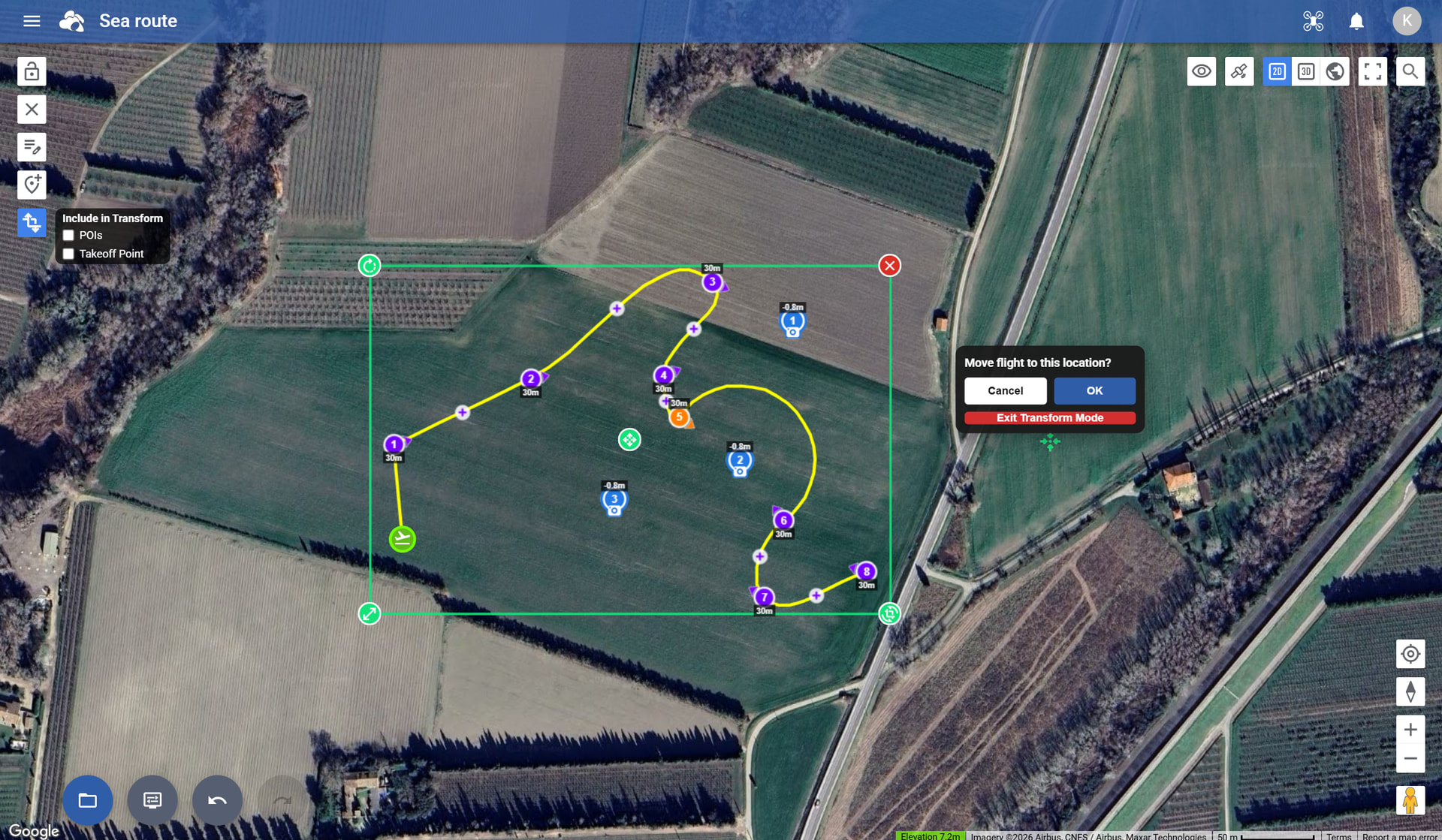

Transform Tool
A new Transform tool has been added to make it easier to adjust existing flights.
You can now:
  • Move a flight to a new location
  • Rotate the entire flight path
  • Scale the flight layout
This is especially useful when reusing a flight in a different location or quickly adjusting an Area Mapping flight.
