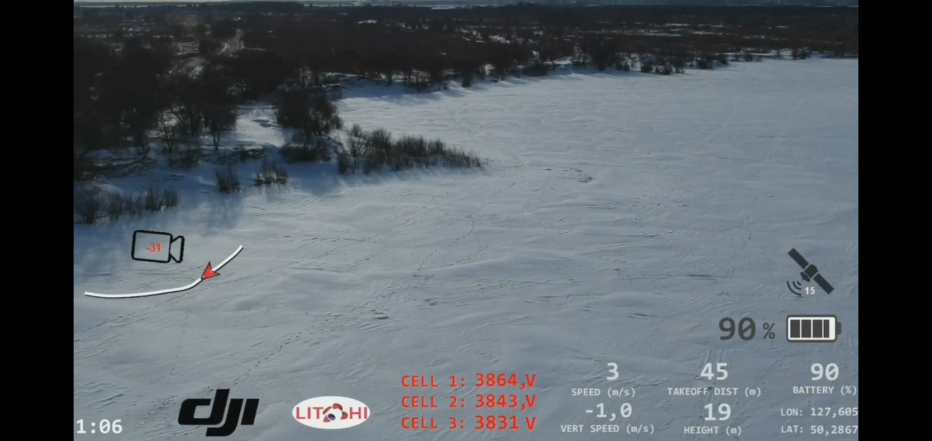

+1 Dashware, but a bit of learning.

Да я могу размещать на видео любые параметры.
Most of all, gimbal tilt and drone direction are needed in order to analyze missions.
Hi Martin, I went ahead purchased the Telemetry Software, thanks again for the heads up on this one, it was exactly what I was looking for.

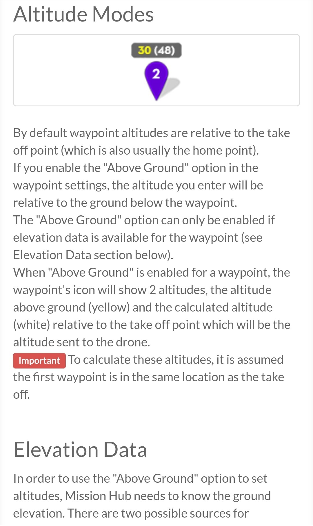

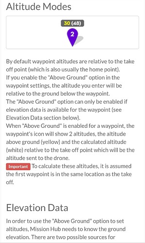

  3. When the Above Ground option is to True, it seems to be working from its originating point not where the drone is actually located. In my case I found this very misleading and potentially dangerous.

Chris. Im operating from IOS as well. I concur with your three points, particularly the potentially hazardous Above Ground/True option, which nearly sent my Air2s into Sydney harbour.

If you notice when you set the Above Ground Option to true they waypoints show your value then they show a value in parenthesis, the later is actually the value the drone is both flying on and recording to.

When turning, it makes stepped movements, which is different from smooth turns. You can upload your video files to watch
