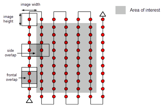

Grid missions? I’ve seen a few posts about rhis but don’t understand what it is. Anyo e explain this to me or point me to maybe a video tutorial on what it is and how to implement it.
Imagine a lawnmower going up and down a path as it moves across the lawn. A drone mission can perform that same flight path, taking photos along the way.
Some drone mappers will perform that path again, this time flying back and firth (side to side) oriented 90° from the original path.

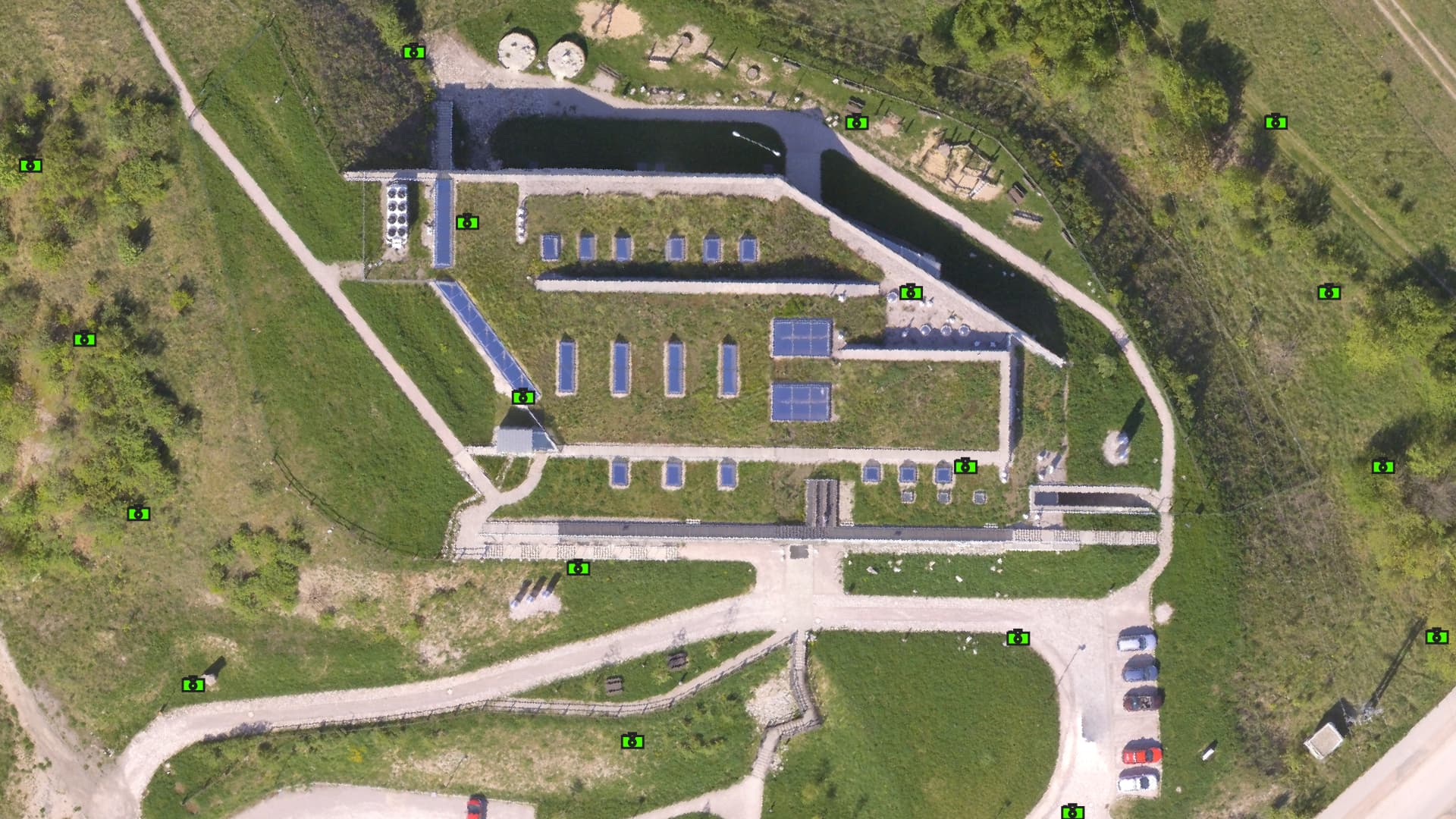

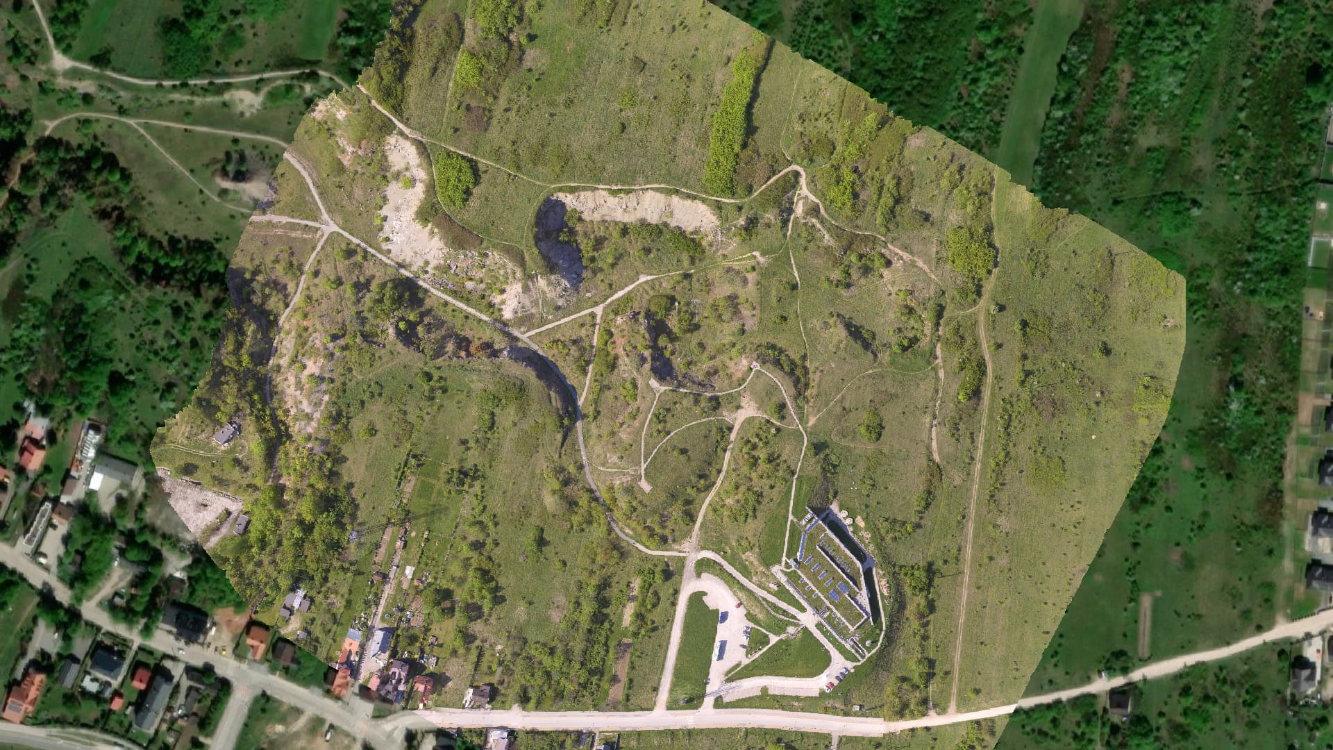

Here is a sample map processed in WebODM, in case you are curious what the final product may look like. (This was captured using a single grid mission.)
The GSD for this mission averaged 6.45 cm/pixel (2.53"/pixel). I have other ortho phots I can share from a project where the GSD is 1.6 cm/pixel (5/8"/pixel).
This image is at a scale of 1:5000.
This image is zoomed on the building and rotated to a scale of 1:1000.
And resulting orthophoto with photo locations.
