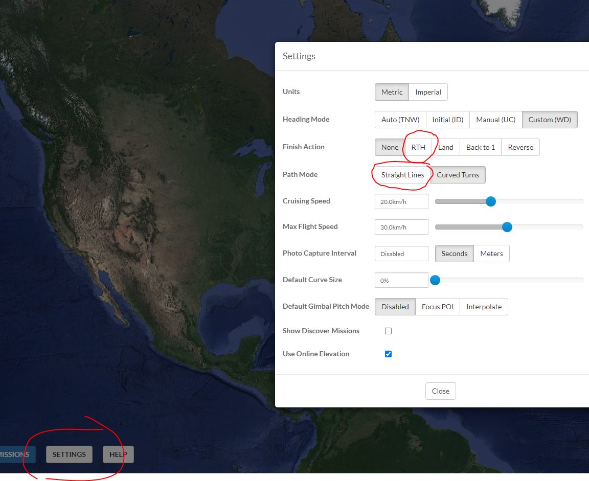

I understand, it’s enough to give the RTH command in the litchi hub settings.

EDIT: 2 More Questions, sometimes flyhub shows straight lines, sometimes it showes curved turns in the settings when loading Mission from ancient.land ? Why ist that ? Isn’t straight lines for mapping (which this tool is mainly used for i gues) he best Option ? And 2. one, sometimes flyhub shows photo capture intervall 3 or 4 seconds even if Z-Check is saved at 1, why is that and is there a good reason or should i just disable it manualy?

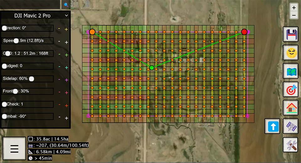

This is a screenshot of a mission I planned today:
Note how the slider buttons overwrite information - particularly Speed.
I would prefer to see Speed displayed in kmh or mph. I understand Litchi uses the m(ft)/s value for import but Litchi “Settings” are in km/h or mph.

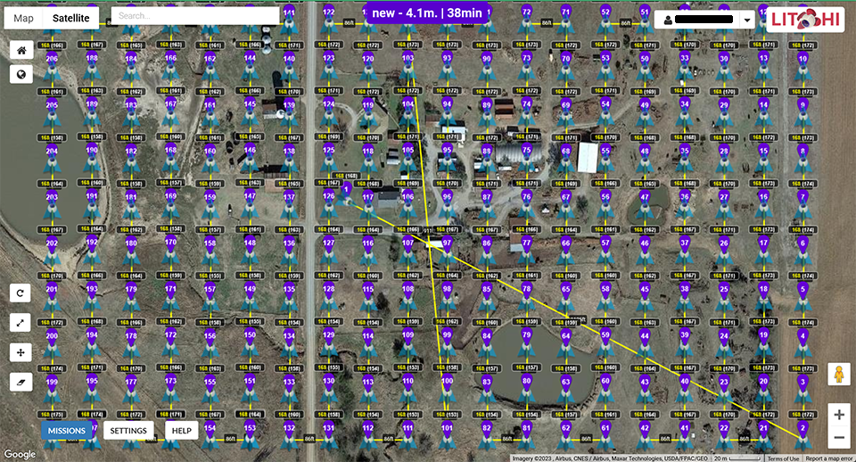

This is a screenshot of the mission imported into Litchi:
Settings: Heading mode=Custon (WD) Speed=8.7 mph
I was surprised to see the aircraft icon pointed south/180 degrees since the planned direction was 0 degrees.
The difference in estimated times between 45 for GMD and 36 for Litchi is probably due to GMD shows a path from the last point on the grid returning to the home position.
To correct the aircraft direction (I prefer to have to top of images to be oriented to north) I adjusted the direction in GMD to 180 degrees.

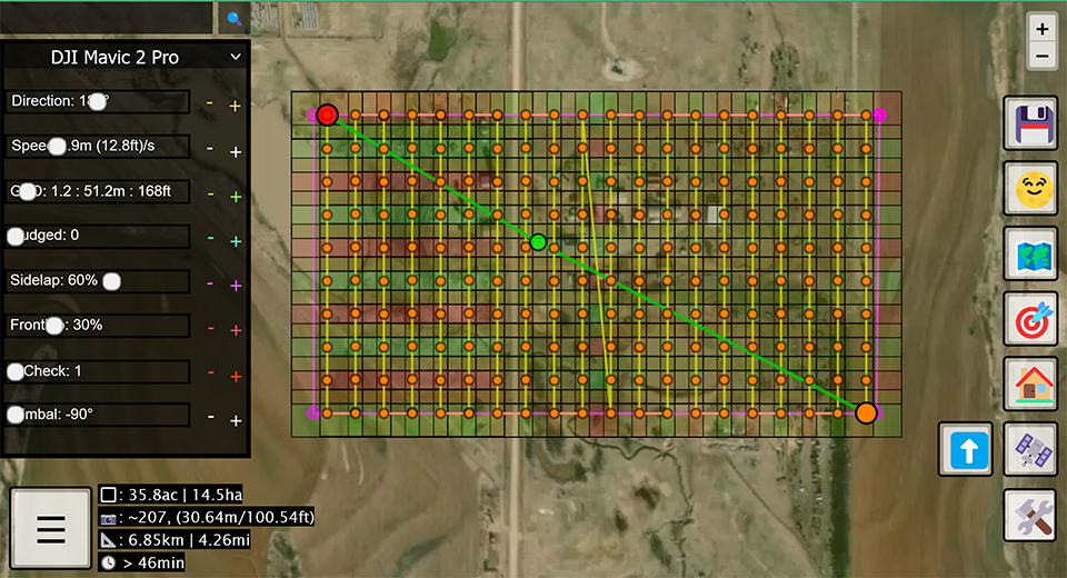

Screenshot (GMD):
Note the direction slider button overlaying the direction value.

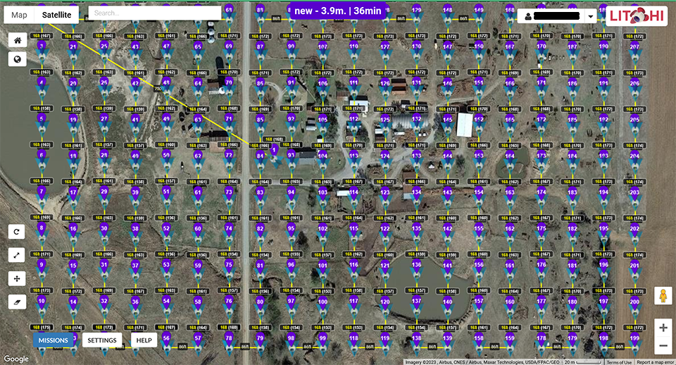

However, the primary issue is the course error seen about midway through the mission. According to the Litchi mission the error is between waypoint 101 and 102. Waypoint 101 is at the bottom of the grid and Waypoint 102 is at the top of the grid. The grid starts with Waypoint 2 - the orange circle at the lower right corner.
Screenshot (Litchi):
The path error only occurs when the direction is changed from 0 to 90, 180 or 270 degrees.

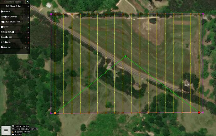

@Jim_Smithheisler ,
Here are a couple of things you can try. You may like them or not, just options.

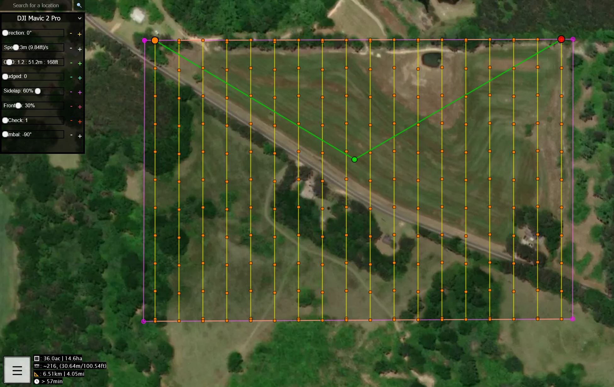

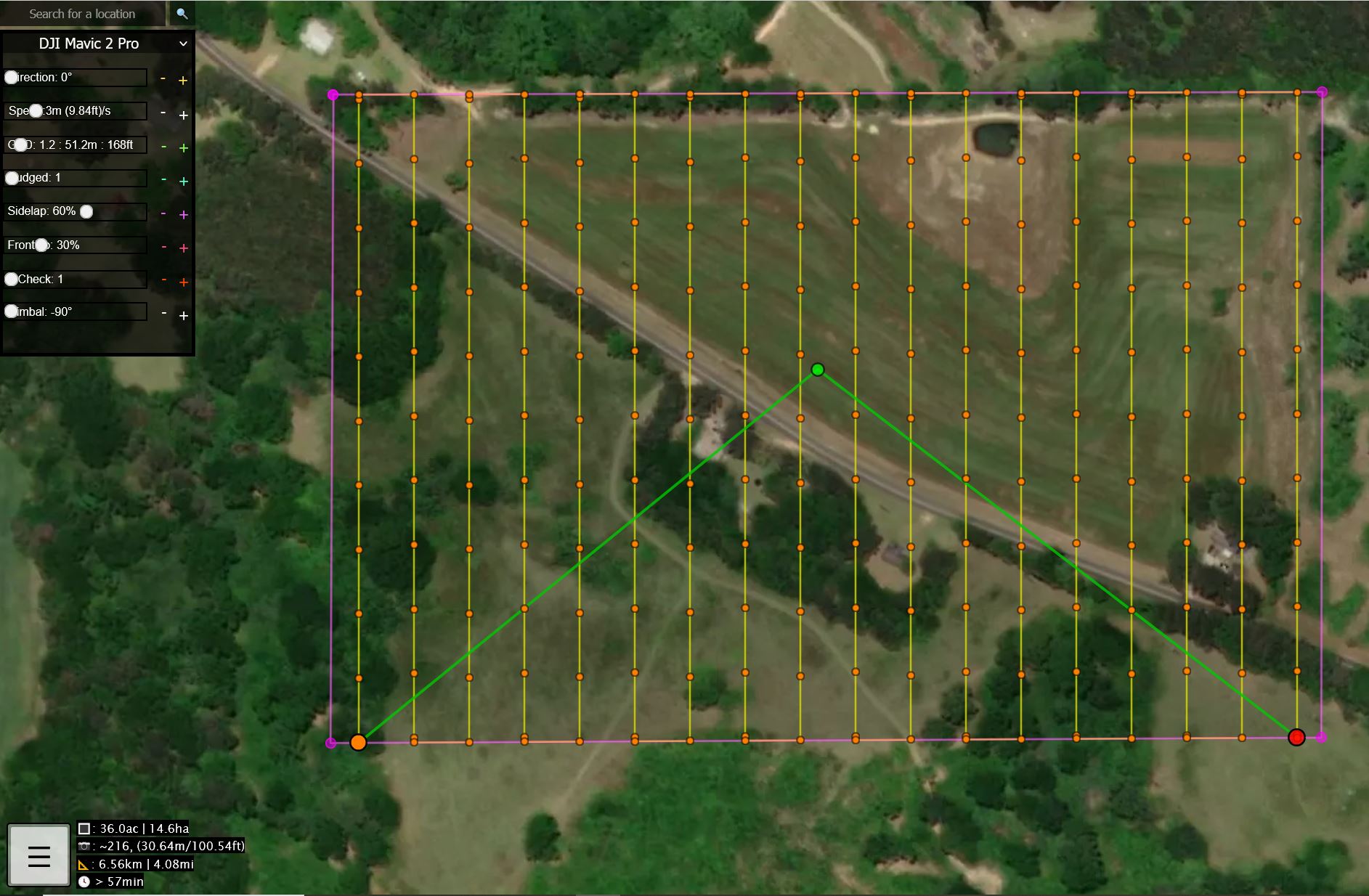

I created a mission in AncientLand similar to yours. The START and END points are on the North side of the mission, like yours were. I turned the image footprints off to make it easier to see.
Just by changing the ‘Nudge’ factor from 0 to 1, it changed the position of the START and END points.
I didnt have to Rotate the mission. I did rotate it to 180° which caused the course error, like you saw.
The Nudge is an easy way to tweak a bit.

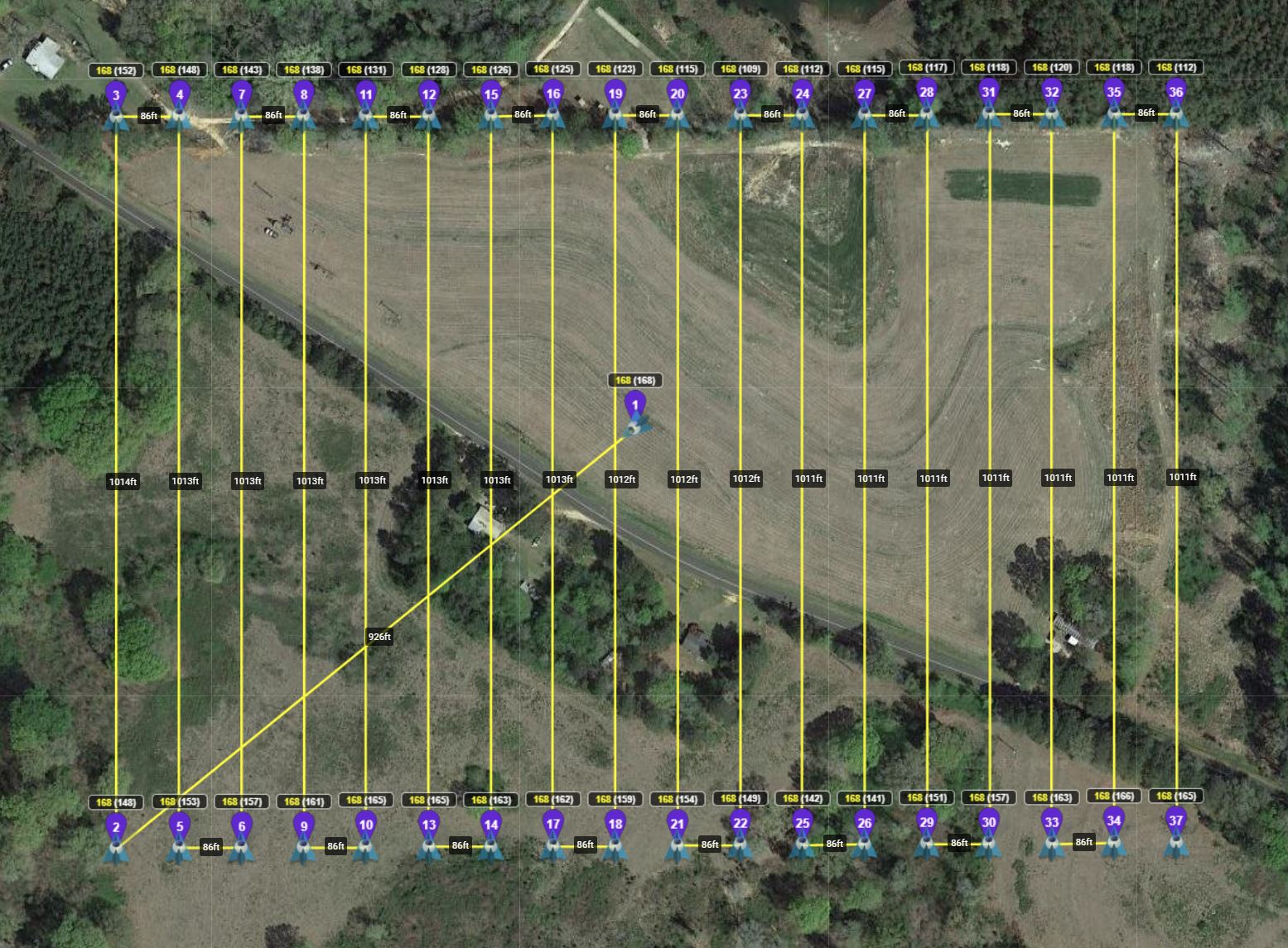

Another option for you to try, if you want to eliminate all of the waypoints along the vertical paths (but leave all of the turn-around points) is to use the Z-Check. I bumped it up to 11 and this is the result.
When this mission is imported into Litchi, it looks like this.
To me, it gives me more flexibility to change the Photo capture points by varying the Cruising Speed and Photo Capture Interval.
