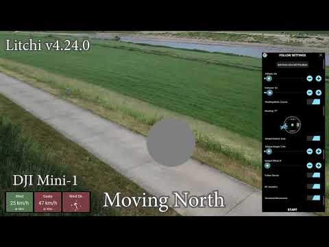

FOLLOW settings on Android vs iOS:
(iOS doesn’t display a compass)
Difference between “Heading Mode:” ‘Course’ and ‘North’:
Litchi FOLLOW Mode Animation 720p2
For “Heading Mode:” ‘Course’ to work you have to be moving at a speed of at least 1 m/s.
More information:
Short example on YouTube:
