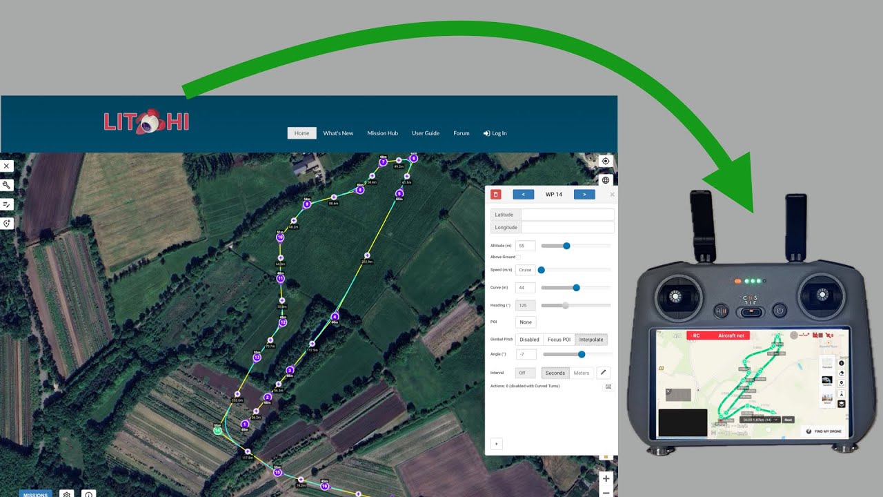

Sorry im having a senior moment. So im using the dji mini 4 pro with rc2. So under so under drone model select the dji mini 4 pro under dji fly. How do it get the saved waypoint from the litchi hub onto the rc2(dji fly).
You need to export the flight to KMZ (for DJI Fly).
Follow this guide How to use Litchi Hub with DJI Fly (for drones with no SDK support)

Is it possible to use it to create missions between Litchi and the RC2 remote control without connecting my DJI 4 Pro drone?
Yes. You can create a mission in the new Mission Hub, then export it as a KMZ file, then connect the RC2 to your computer (without the drone turned on) and transfer the KMZ file to the RC2.
