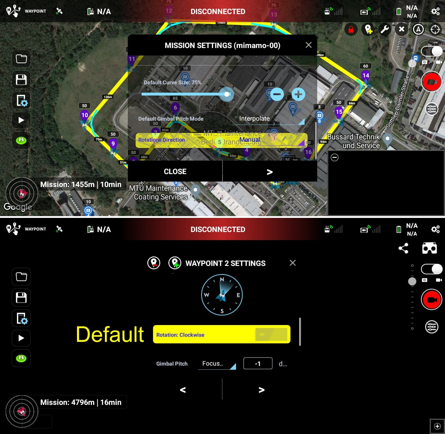

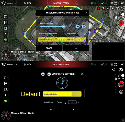

Check out my mission settings and drone direction in wp1 and wp2.

Actual cause of spinning drone (and a fact I did not know about).
In Mission Settings in the App there’s 1 Setting NOT available in the Hub:
-‘Rotation Direction’ (Managed (Default) or Manual)
Consequently there’s 1 Waypoint Setting NOT available in the Hub:
-‘Rotation’ (Clockwise (default) or Anticlockwise)
When ‘Rotation Direction’ in Mission Settings is set to Managed, the drone takes the smallest turn-angle between 2 waypoints. This can be CW (ClockWise) or CCW (CounterClockWise).
So when you set ALL waypoints to either CW (default) or CCW, situations can occur where the drones keeps spinning around.
This can/will happen when you plan a mission in the Hub, then in the App you change the Mission Setting ‘Rotation Direction’ from Managed to Manual. As a consequence ALL waypoints will default to Clockwise.
In the Case of mimamo, Rotation Direction is set to Manual and ALL waypoints to Clockwise.
From WP4(59°) to WP5(46°): 347° CW
From WP5(46°) to WP6(23°): 337° CW
From WP6(23°) to WP7(155°): 123° CW
From WP7(155°) to WP8(110°): 315° CW
From WP8(110°) to WP9(200°): 90° CW
From WP9(200°) to WP10(178°): 22° CW
From WP10(178°) to WP11(109°): 291° CW
That’s a total of 1525° or just over 4 complete CW rotations.

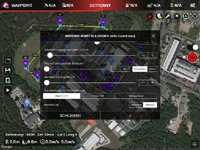

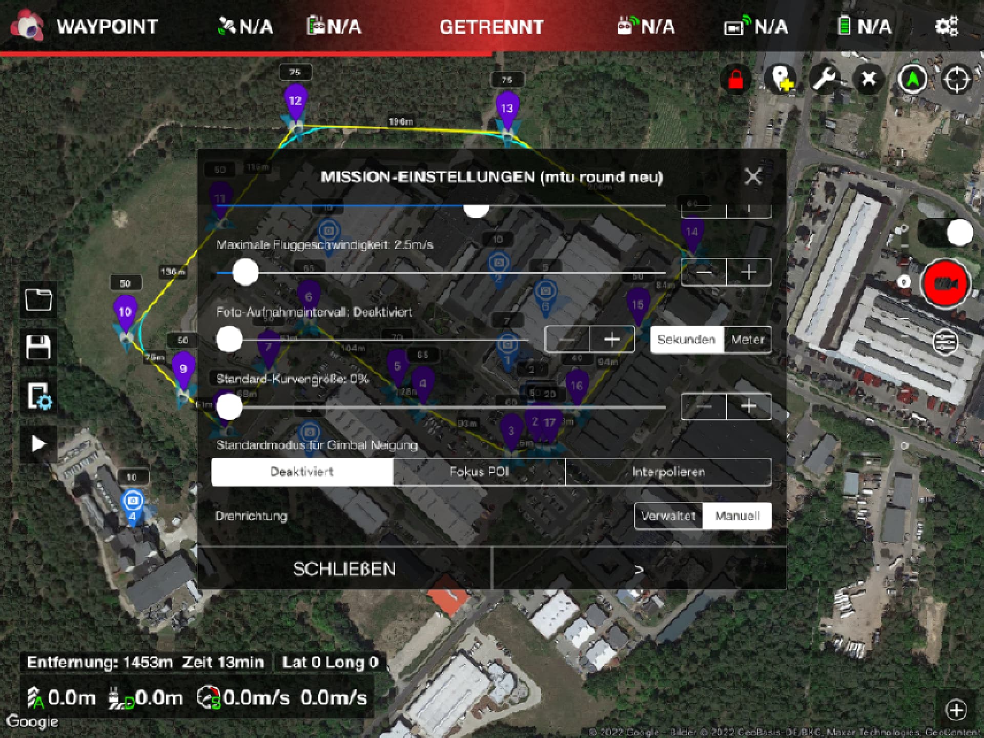

I didn’t watch the mission. But the author never posted his screenshot from the phone.
Because it is from the phone that he launches his drone, but not from the computer and the mission hub. I also agree that he ran once and did not try to run this mission again.
YES he did, post #33 d.d Mar 23
