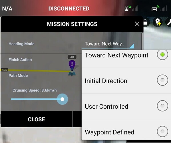

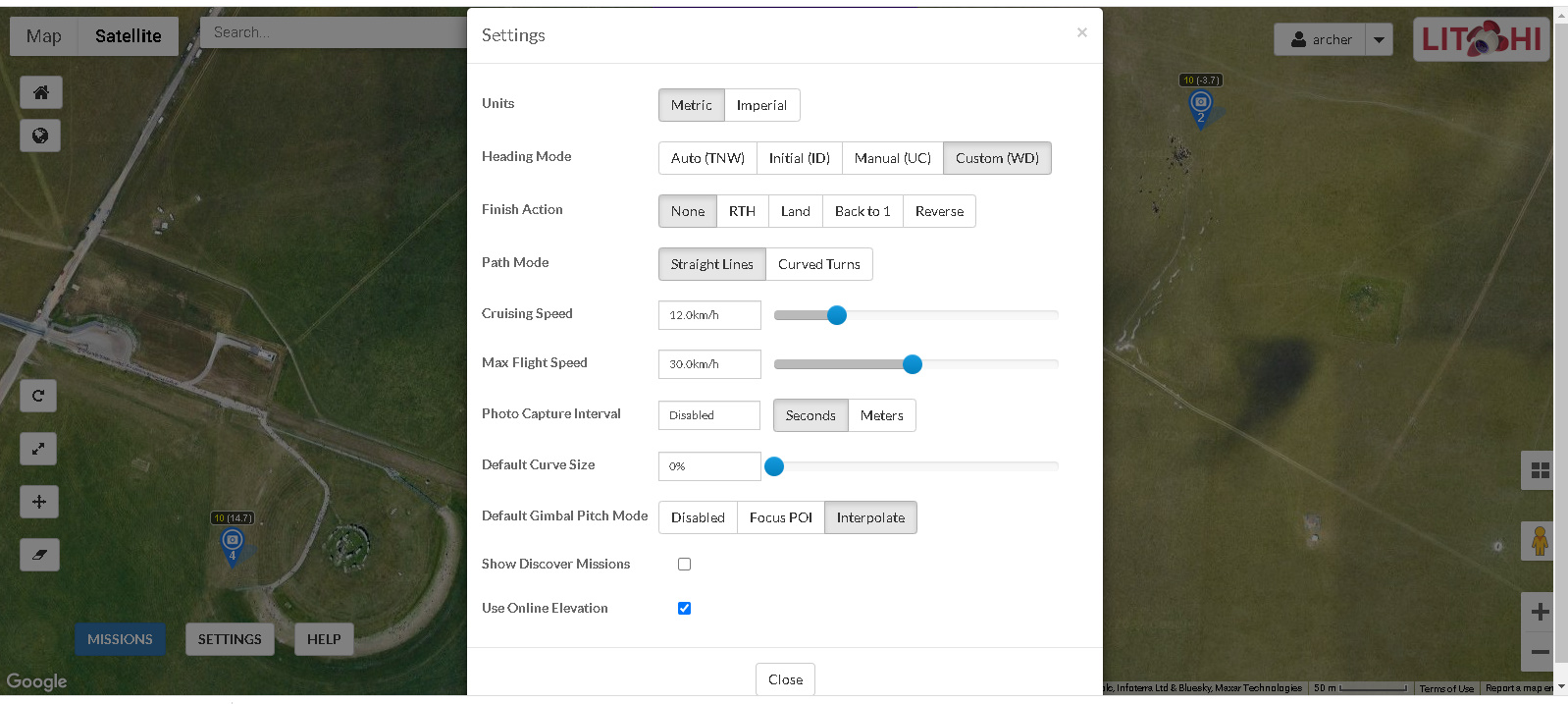

Show your mission settings.
Do you have rotation enabled?
No, all headings directly to point of interests.
Heading mode change 1
And default gimbal pitch mode

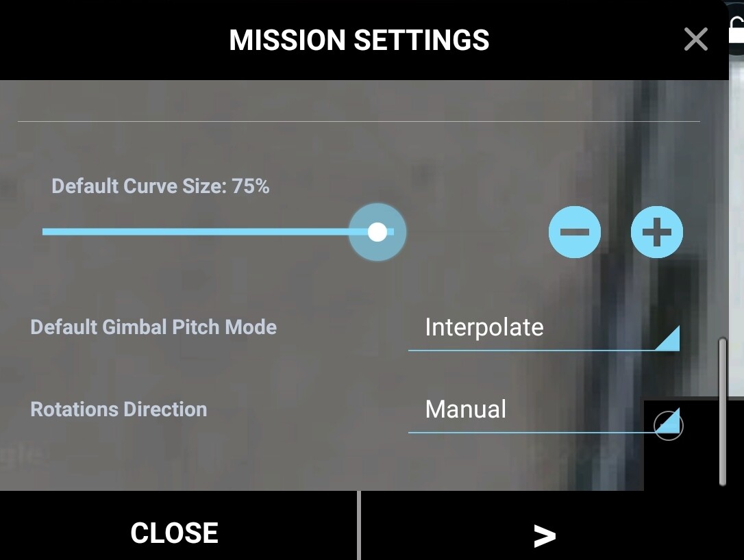

Gimbal pitch is completely irrelevent to any of this, it is a separate function that does
not affect steering directions.
I told you about rotation direction
You don’t see this option in your settings.
Drone rotates to look at the next waypoint.
