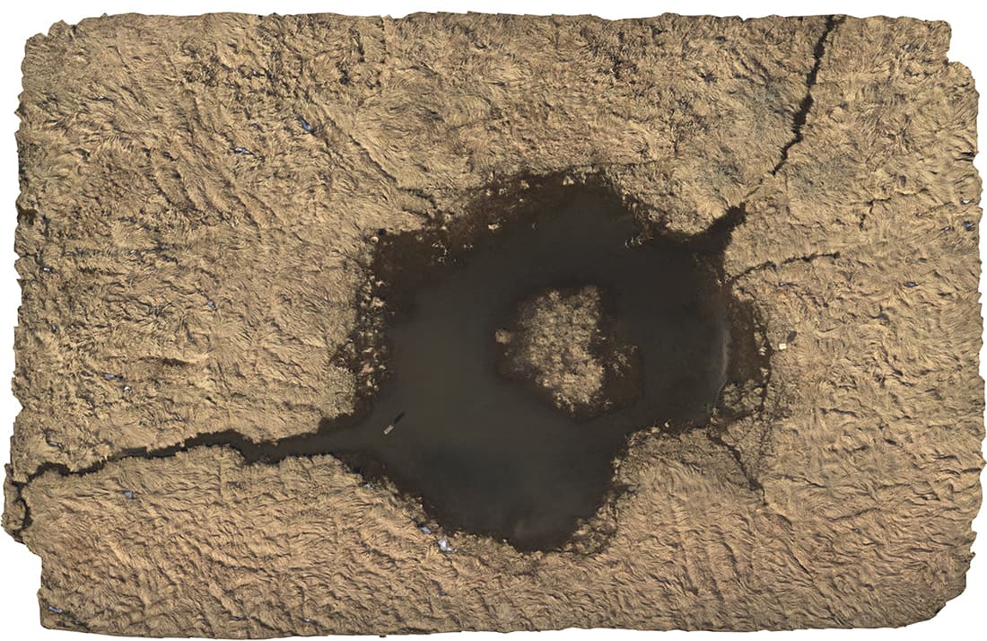

I guess it’s time to show you the difference in what Litchi Release Version and Litchi Pilot look like side by side. Litchi Release was done with Mavic 2 Pro/iPad, Litchi Pilot was done with Mini 3 Pro/ RC Pro
these were done less than 10 minutes apart. What your looking at is how the same Mission Plan came out without adulteration after being processed with Metashape 2.1
Photo 1 is Litchi Release Version and DJI Mavic Pro 2, iPad, Photo 2 is Litchi Pilot Mini Pro 3 and RC Pro…note color inaccuracy. Overall red cast and green cast along edges as well as missing photos. The composites were processed with Metashape 2.1. These composites of 370 waypoints ea. have not been changed in any way other than a reduction in size for viewing here…a picture is indeed worth a thousand words…I know a bit about color accuracy having set-up digital imaging systems for publication during the infancy of conversion from analog to digital for newspaper and magazine publishers. I only mention this because I sometimes think that some of the questions asked wonder if it’s user error rather than something else (it’s possible)…which indeed I guess they need to ask since they’re unfamiliar with me and where I’m coming from with regard to reporting bugs…All The Best, I forgot to mention this beta testing has been a bit arduous which is why when I do it I also do it with equipment and software which works at the same time I’m testing the beta version so that I’m getting my work done for the client as well as the testing.
The two drones that you are using handle waypoint missions completely differently. The Mavic 2 Pro is able to load a mission (99 waypoints at a time) into the drone and then fly that mission and take photos completely autonomously (without a connection to the remote). The Mini 3 Pro is a “virtual stick” drone where the mission is not loaded into the drone. Instead, the mission is kept on the controller and virtual stick commands are continuously being sent from the controller to the drone. Missions run using virtual sticks are prone to momentary disconnections depending on the distance and terrain between the controller and the drone.
Have you loaded your flight logs to AirData and had a look at the “Signal Map” for this flight? That would tell you something about the signal strength during this mission. It looks like most of the holes are near the top of that image. Were you standing at a location near the bottom of that image?
I would hope not!
Thanks very much for your explanation of the two methods …as you can see there are no trees
or anything else which would corrupt transmission nothing about 3 feet high especially this time of year when no growth takes place…it is also rural with nothing nearby which could corrupt the signal and the distance from the controller is not very far away I’ve never measured it but suffice it to say that at all times that small drone can be seen with the naked eye. Tomorrow I’m going to compare results from the Mini Pro 3 and Air 2S…do you know what method they use for that one? What do you think about the inaccurate color? Do you think it’s Mini 3’s shortcomings or software related? Thanks again for explaining the difference in how they handle waypoints but if the short distance from controller to drone is what causes this I’d be quite surprised…Here’s another interesting aspect I’m just now thinking about…the other site the drone is much further away both in flying the waypoints and the distance it needs to travel just to start the mission and it’s had considerably less (missing images if any) when it’s flying but I still notice a variance in the period of time at both sites between the click sound of the camera. Later flights seem to have more difficulty but there is ample empty space on the cards upon fining the missions.
I’ve forgotten to answer your above question…I will do what you suggest, however I have looked at signal strength periodically prior to flight and it always been bright green.
