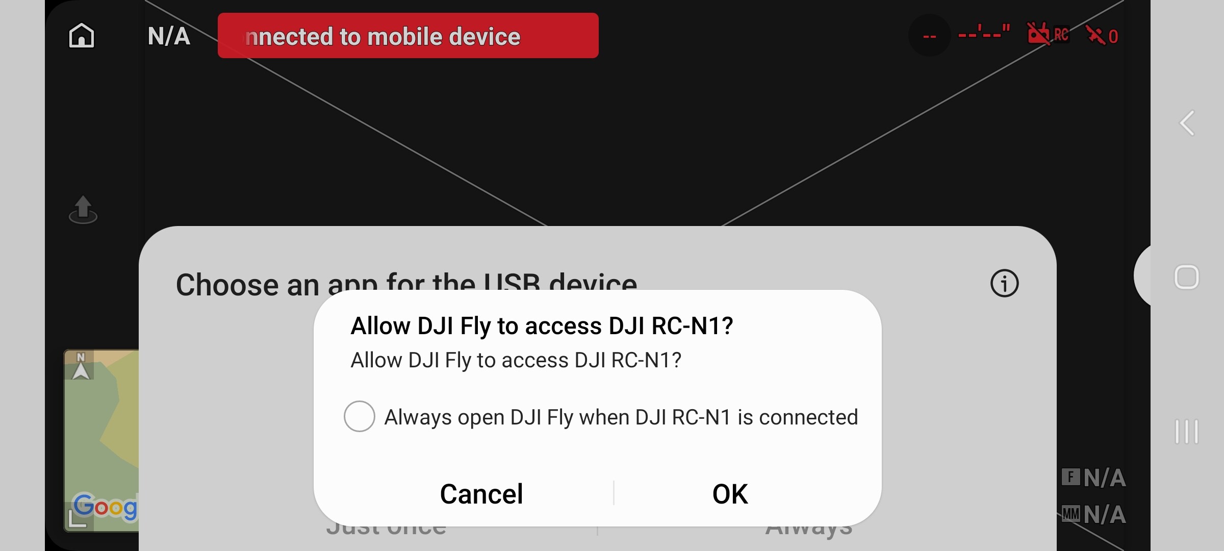

Not sure if this makes sense if you’re not using an Android phone but this is what I get when I power up the DJI RC-N1 for my Mini 3 Pro. I can choose either DJI FLY or Litchi Pilot.

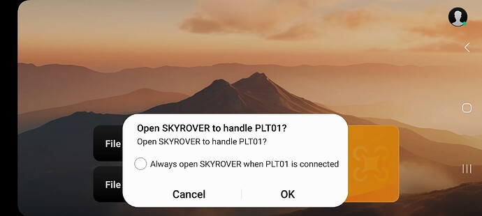

This is what I get when I power up the Skyrover X1 remote (it is a DJI RC-N1 look-alike, slightly smaller, charcoal color). I can only choose the X1 app, Litchi Pilot is NOT an option. That would suggest that Litchi Pilot is not hooking into whatever is needed in the phone’s USB interface. Hopefully the Litchi developers understand.
Litchi is very unlikely to work with this drone unless DJI adds proper support in the SDK which I doubt would happen.
