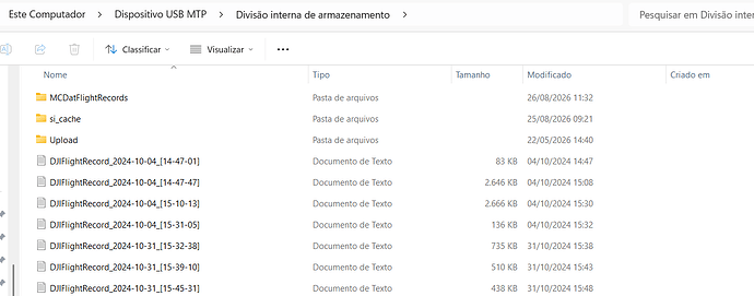

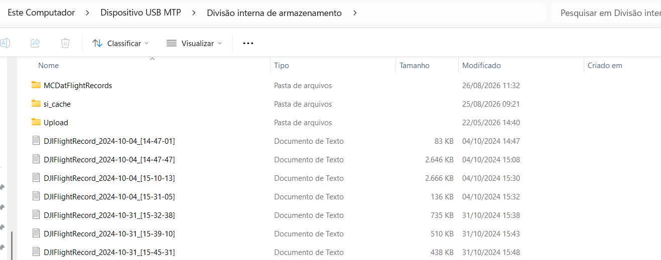

After you connect your DJI RC to your computer can you manually navigate the DJI RC file system using the file explorer?
Aparece apenas a pasta “Divisão interna de armazenamento”

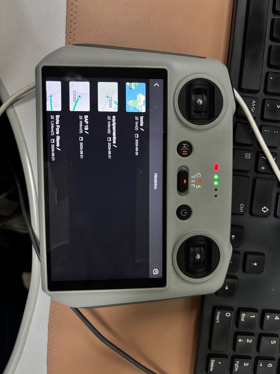

Did you create a (dummy) waypoint mission in DJI Fly?
Está criado.

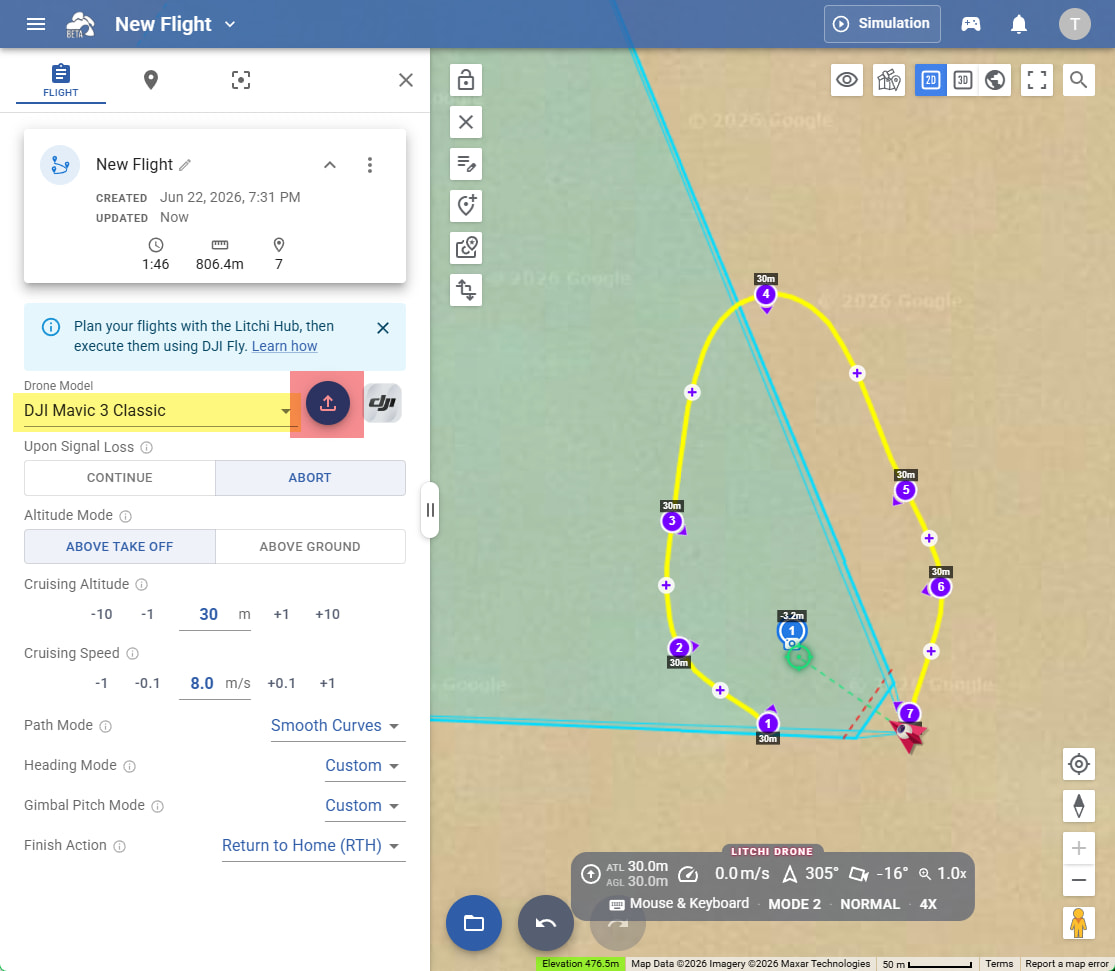

Did you select the correct Drone Model in the Litchi Hub?

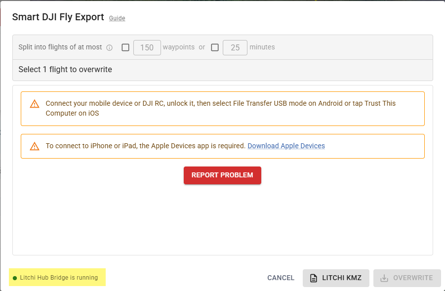

When you press the blue Export button (marked red in the screen shot), does the “Smart DJI Fly Export” popup windows appear?
It tells you in the lower left corner if the Litchi Hub Bridge is running.
The DJI RC 1 is not supported for flight transfer as it does not expose its entire file system. DJI RC 2 is supported
