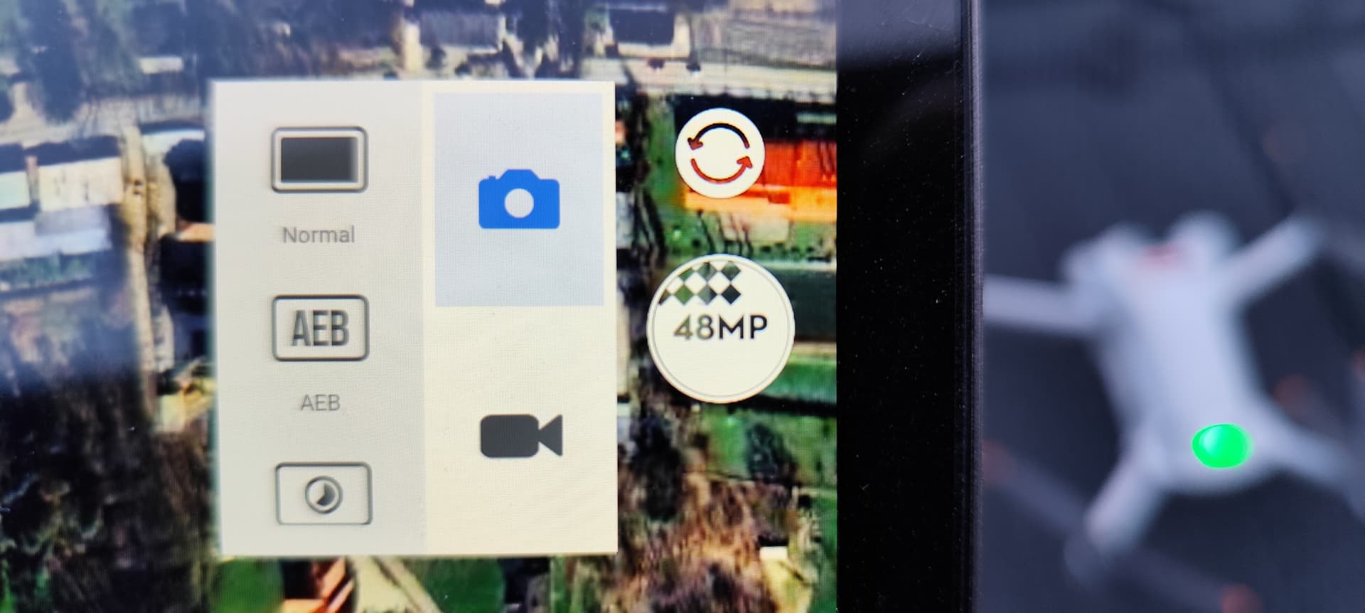

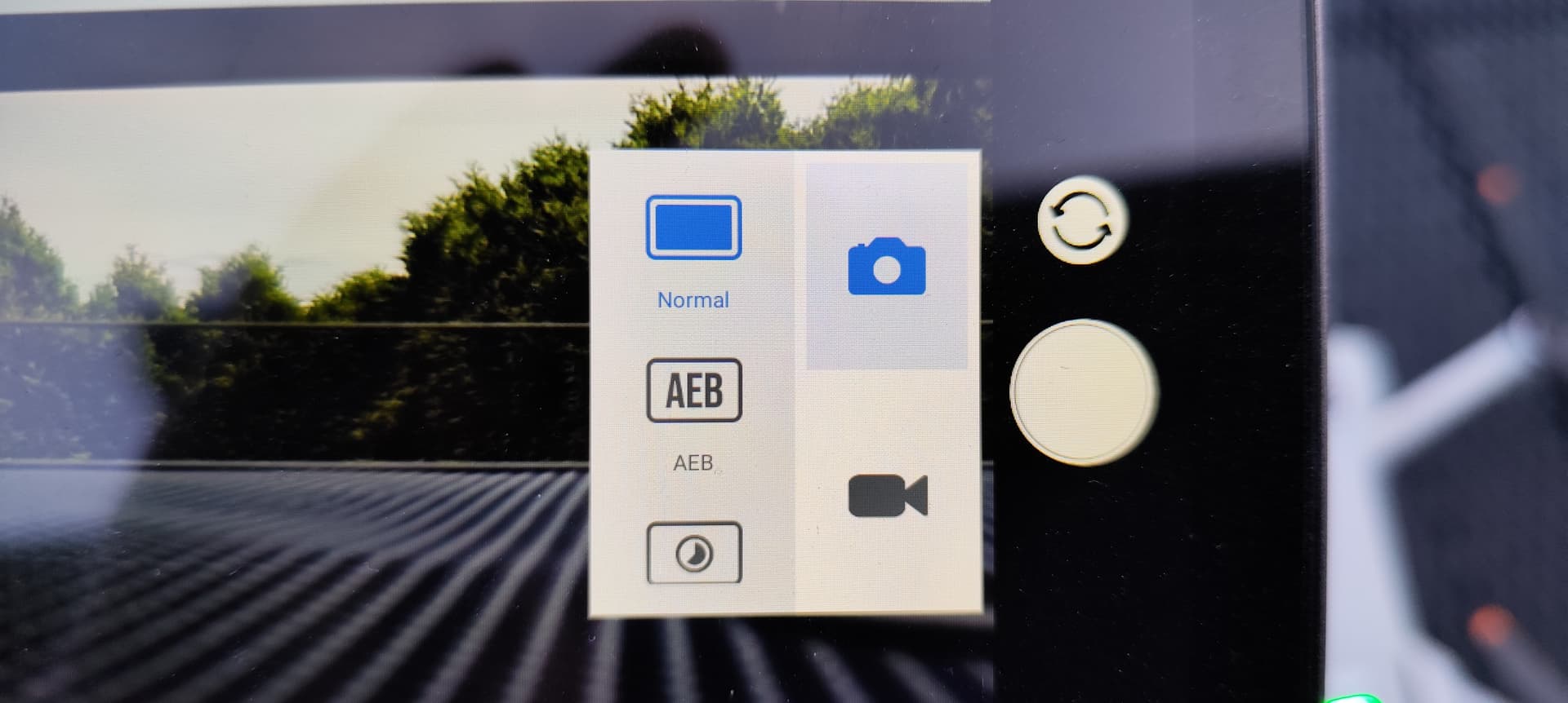

I can’t select the 48mpx mode for the mini 3. I have to start DJI Fly and when I change it to 48mpx, it also shows up in Litchi Pilot. Until I change the mode. Tested on the latest version.
