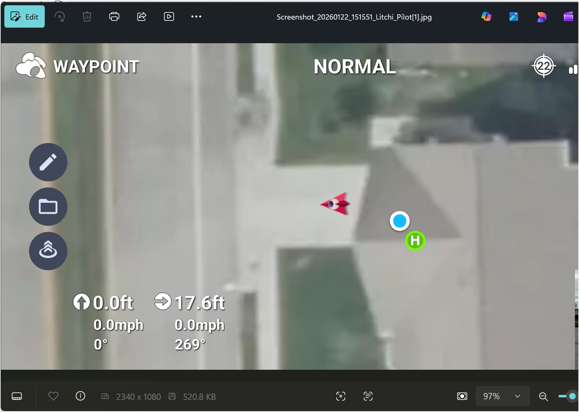

Lately I’ve experienced very inaccurate RTH location determination, going 20 ft or more off center. DJI Fly is still accurate, but Litchi Pilot is very poor. Drone is Mini 3 Pro. KP Index is 7, but if this is the cause why is DJI Pilot not impacted yet Litch Pilot is? (So don’t tell me this is the cause). Any ideas?

Is the best practice to start DJI Fly first and get the Homepoint set there, then launch Litchi Pilot after that? Or does it matter if I directly Launch Litchi Pilot first? Here is what I got with 22 Satellites and note the large offset (20 feet off the drone location) of the Homepoint.
No need to use DJI Fly.
The home point is set when you take off. RTH precision should be the same as DJI Fly, except possibly in cases where the drone supports precision landing and takes a photo of the landing spot when taking off. Use of automatic take off might help.
