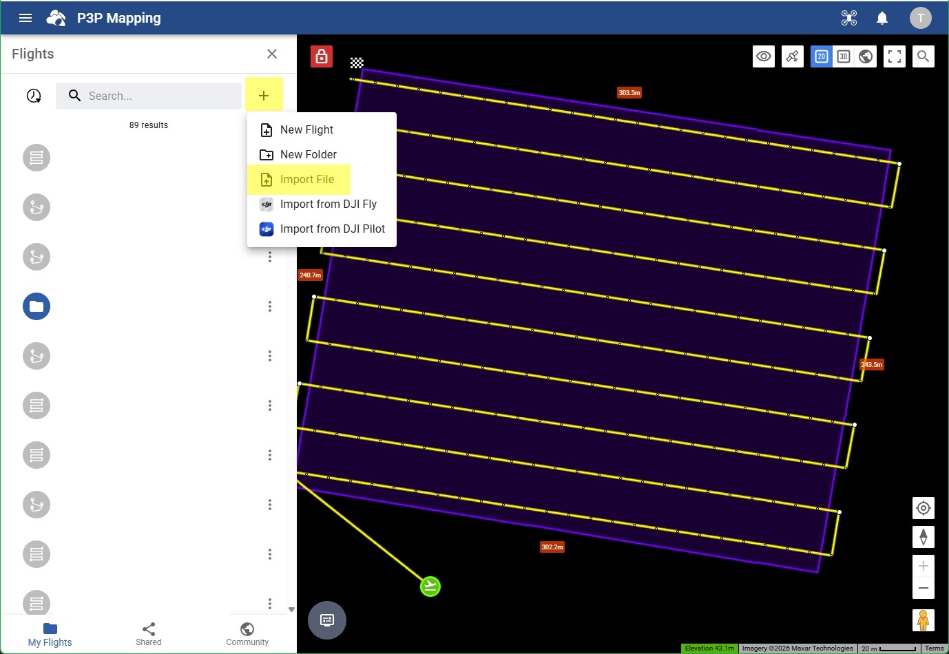

i selected dji model mini5 pro, and created a test route. But when export, it still shows KML/CSV option. No KMZ?

or when the “Litchi Hub Bridge” is installed:
What’s new in the Litchi Hub
Flight Settings
New “Flying with” setting
You can now select which app you will fly with when creating a flight. The selected app determines available flight settings, compatibility, export format, and overall flight behavior.
[image]
New Litchi Hub Bridge companion app
Litchi Hub Bridge enables seamless transfer of waypoint flights between Litchi Hub and DJI Fly or DJI Pilot. It allows you to export Litchi flights to DJI Fly and import DJI Fly/Pilot flights in…
