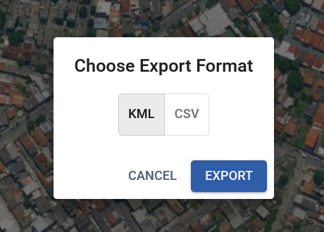

Is this option GONE? I successfully used it a few times last year (great feature!) but this week I was planing a new mission and this options is no longer available… When I select “Export”, the only options that come up are KML or CSV (the KMZ DJI FLY used to be between them).
Will it come back? Please!
No.
You have to choose a KMZ compatible drone model.
(The option is not available for Litchi and Litchi Pilot compatible drones)
It worked! Thank you!!!

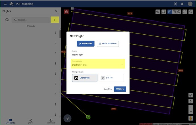

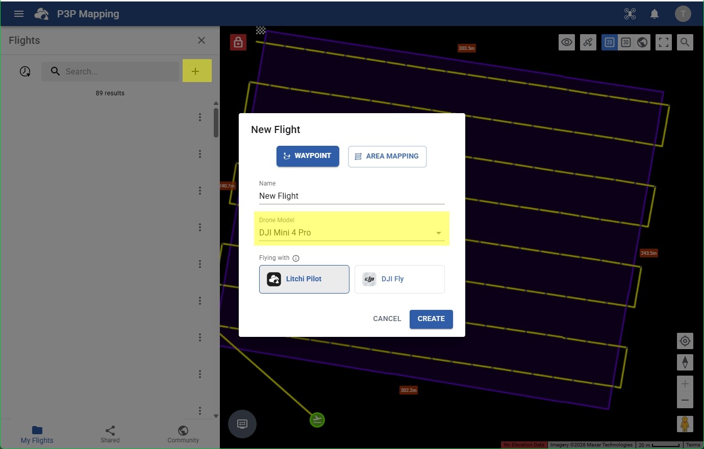

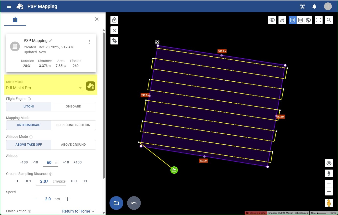

how to select drone model?
How it works? I can not find a place to select drone model
New Litchi Hub Beta:
When creating a NEW flight:
Within an Existing Flight:
