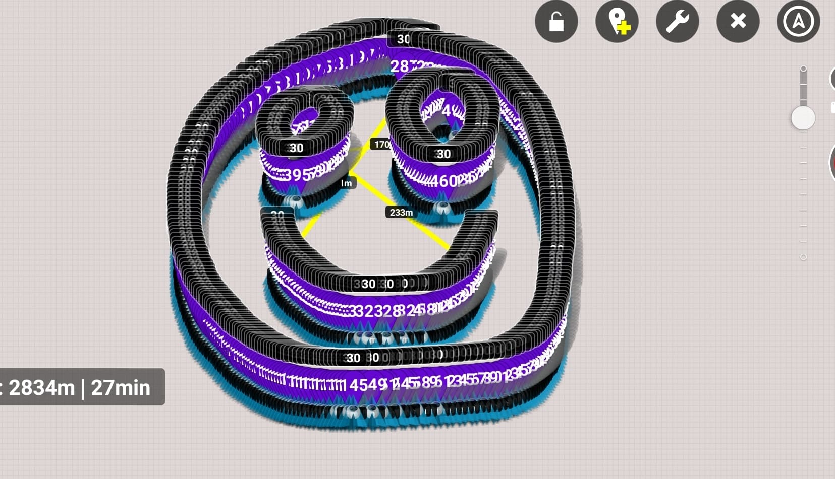

NEW 10,000 waypoints!
Only the new version of the application is wrong and always sets more distance than specified in the settings. To set 3m you need to zoom in on the map
493 waypoints created in 1 minute.
As you can see reaching over 100 waypoints is very easy.
Holy mackerel Paxxa. I am speechless. You are da man. I thought I was a Litchi Meister with a 7th-degree black belt, but now I realize I am nothing but another young grasshopper who has many roads to travel and many lessons to learn.
However, I would like to ask Litchi. Why when I do a drawing like the one above in the app, I set the distance to 3 meters, but I get 30-50 meters depending on the scale of the map. If you zoom in very close to the map, you can achieve 3 meters.
Can you help me?

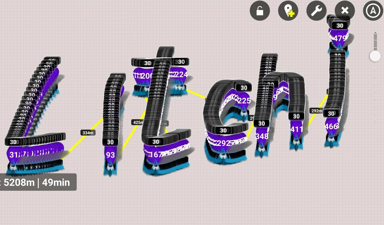

Hi, I routinely run missions with hundreds of waypoints on my Mavic 3 Pro. This is an example of one that has 391 WP’s. I use Wes’ utilities to achieve this.
