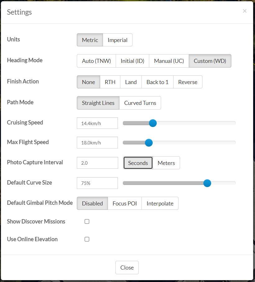

The mission settings for the v2 (straight lines) were like this:
Yeah, I thought of that guys. But why am I getting smooth video feed when you say signal is the cause? As you can see at 1:33 of the video, the oscillation continued even when the signal was at 4 bars for over 20 seconds until I stopped the mission at 1:56. Does that mean only full 5 bards can guarantee me working waypoints with Litchi?

Control signal and Video feed signal are two different signals. Only Control signal is used to fly the drone.
This signal is also used for feedback to the controller and Litchi, like the drone position. When there are gaps in this signal the actual position of the drone and the transmitted position of the drone do not match.
While flying manually your feedback will be by vision (your eyes), using the Video feed signal.

So @TriBar you were right the EXP settings had (fortunately) no influence and the only factor was signal strength. As soon as the signal fell on 3 bars it was never possible (tried 3 times) for the aircraft to reach waypoint and perform action. As soon as I moved and signal was full, the mission continued ok. Sometimes even 4 bars were a problem.
Probably slightly different RC location with better signal (4 bars over 3 with Beta) in my test with non-beta Litchi was the reason why the Beta performed worse on first two waypoints. So it’s not related to Beta either.
But somehow I have a feeling Litchi could do better job here. I believe I - just based on the instruments (no looking at the drone) - could be reaching waypoints manually better. Litchi somehow overreacts on the small delays/outages of the data.
