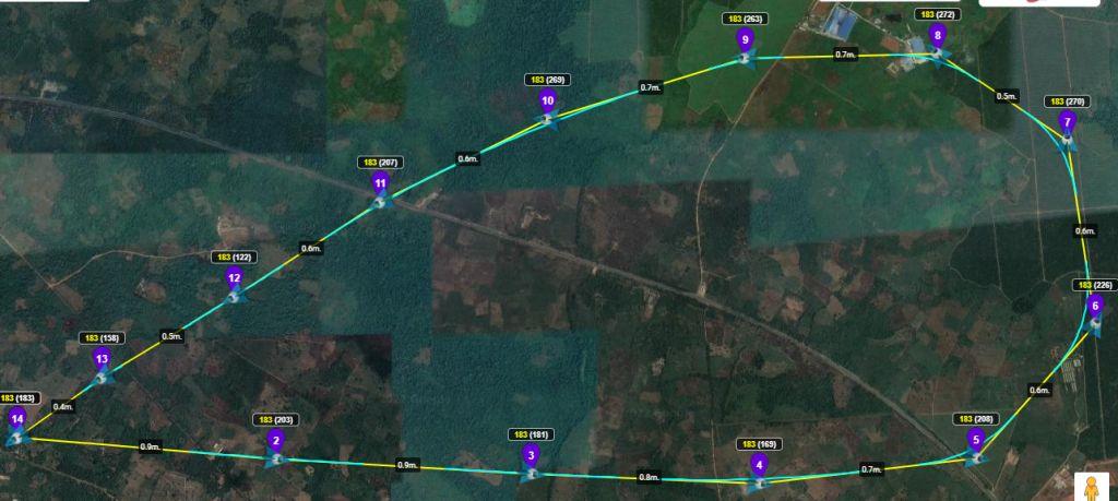

Maximum Distance Possible on a Mavic Pro1 Flying Litchi Waypoint Missions
Those after-market batteries are the Achilles heel of the old Phantom 3 drones. The crash came literally in the last 5 seconds of an 8.5-mile round trip when the drone’s motors were very loud and real close. Using the Litchi flight path as a guide, I expect to fish the drone out of a tree when dawn breaks.

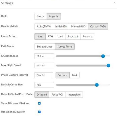

Litchi Global Waypoint Mission Settings
In Litchi’s global waypoint mission settings shown above, I’ve set my cruising speed for all waypoints at 29mph whenever the speed slider-selector is left at the default of “cruise speed”. as shown below in the settings page for an individual waypoint.

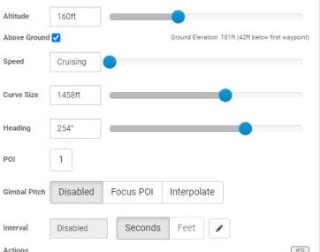

Litch Individual Waypoint Settings

Max flight speed is the speed that can be turned on if you use the left stick during a mission.
Cruising speed is the total speed for all waypoints, but it is by no means the maximum.
Why you and tribar use the term maximum cruising speed is beyond me.
You also have nothing to stop you from setting 29mph for each waypoint, and the drone will also fly at maximum speed.
