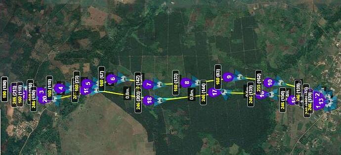

I was in such a hurry to launch my 7.9-mile round trip Litchi waypoint mission that I clean forgot to remove the goldfish bowl covering the camera, which of course resulted in poorly focused footage, reminiscent of my vision after a beer or two, getting recorded en-route.
Up until the moment that I played back the recorded footage, I was convinced that the mission had been a resounding success and that the drone had covered 4 country miles outbound, then circled a friendās house at the other end of a gigantic palm tree plantation, before heading back to base. I typically turn off my controller once the drone is on its way, so as to prevent the disconcerting break-dancing gimbal effect that sometimes occurs when the link between controller and drone starts to break up mid-flight.
When I looked over the footage recorded during this flight, however, I noted that the drone had other ideas, after computing the battery power it would require to complete my programmed mission. Just 200 yards short of the turn-around point, the Mavic Pro slammed on the brakes, spun around, rose to RTH altitude, and called it a day by returning to base while the going was good.

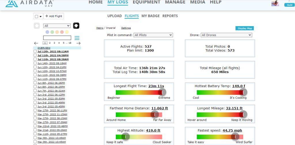

Ignoring the last couple of flights that traveled at 25 mph, my total distance stands at 140 hours multiplied by 17.9 mph, which comes to 2,500 miles. Over in the Mavic Pilot forum, I thought Iād set a record when my dronesā cumulative mileage exceeded 2,000 miles, but then someone else published their Air Data page as evidence of over 7,000 miles logged. So much for that attempted boast haha.
according to that, your total mileage is 650 miles

After writing the above you posted an Airdata overview of your flights, including the one you wrote about above (Jul 12th, 2022 08:12AM).
This overview shows 'Farthest Home Distance: 11.062 ft".
This is still withing the 2.48 miles / 4000 meters range.

UAV Air Data only records miles covered within the RC controllerās signal range. To arrive at the true figure, Iāve had to rely on the accurately tallied cumulative number of hours flown, which I then multiply by the speed of 17.9 mph, to arrive at the true distance covered both within the controllerās signal range and beyond it.

I do find that Farthest Distance from Home tally baffling because that is barely two miles, whereas my drones have flown numerous missions where the turnaround point was 3 miles away from the launch point. I can only presume that the figure of under 2 miles is based on a flawed or incomplete computation by UAV Air data.

Using Google Earth Proās distance measuring ruler tool, the one-way distance between the launch point and turnaround destination point is precisely 3.75 miles, just a hair short of the 4 mile distance I presumed it to be. The total round trip distance of the Litchi waypoint route is therefore accurate at 7.9 miles, given that I always use gradual turns that cover a bit more distance than a sudden about-turn at the destination.

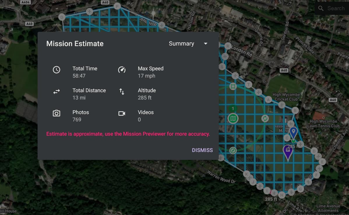

This is a 13 mile long mapping mission, with a maximum speed of 17 MPH, it takes just under an hour, so lets say the average speed is 13MPH thatās 4 MPH slower than the maximum speed, so thatās 23% slower

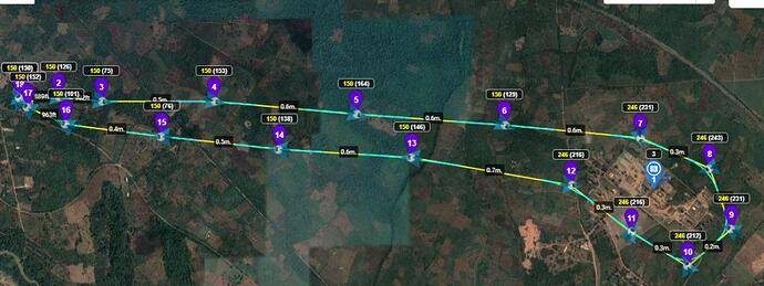

Pushed my luck a tad too far today, and my Phantom 3 Standard is currently AWOL. Heard it homing in over a tree canopy within 75 meters of the launch point at the end of an 8.5-mile round trip but then the engines abruptly shut down. The search resumes at daybreak tomorrow, and I suspect the drone is up in a tree, rather than in the undergrowth.
My internet forum research suggests there is a consensus that a Phantom 3 or Mavic Pro1 cruising at a decent clip of about 27mph would indeed maximize its distance covered per fully charged battery, so I decided to see how the Phantom compared to the Mavic Pro in terms of distance covered without reverting to smart RTH due to low battery levels en route.
Even before I locate the Phantom, my hunch is that the after-market battery in that drone shut off suddenly rather than retain enough power to make possible a controlled landing. This happened once before on arrival from a 6-mile round trip Litchi mission, and that Phantom 3S plummeted onto the hard ground in front of me from 140 feet AGL, showering camera parts on impact.
