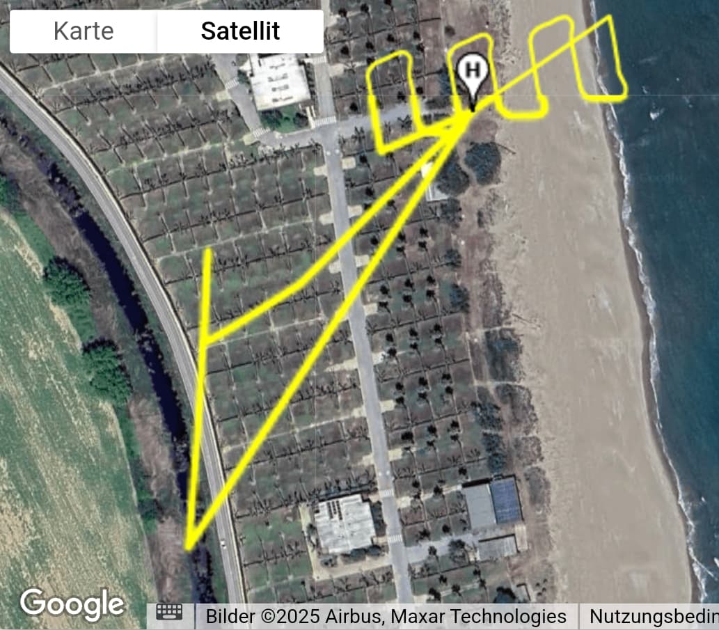

The new area mapping feature is great. I tried it for the first time: the specified area was flown correctly – 27 images from a height of 35 m. At the end of the mission, the drone – DJI Mini 3 Pro – was supposed to fly back to the starting point. However, it flew over the starting point and continued for another 200 m before attempting to land in unknown terrain. Only when I switched to sport mode was it controllable, and when I pressed the RTH button, it returned to the starting point.
I couldn’t determine the cause of the continued flight.

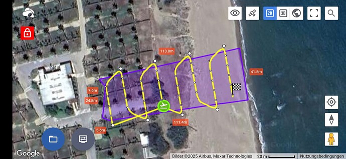

This is what the planned mission looked like:

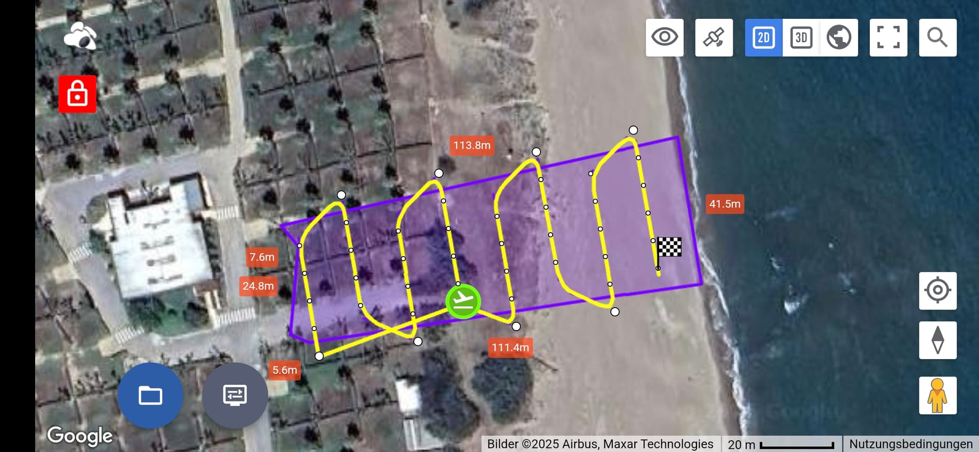

And this is how the flight went:
Most likely you added one or more extra waypoints by accident while zooming/moving the map view.
Make sure the mission is locked when you load it.

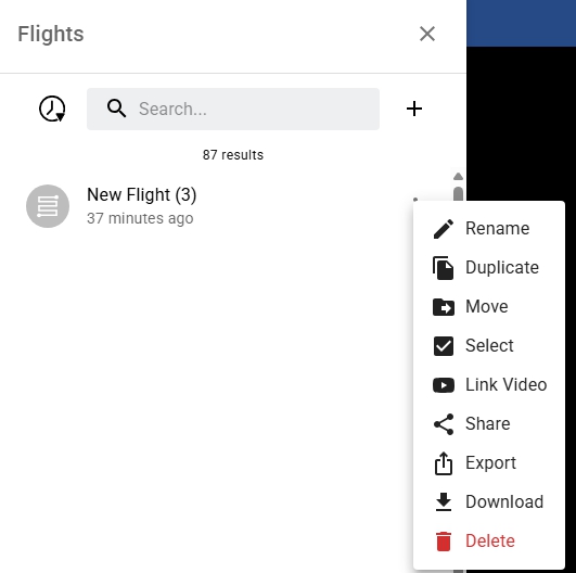

Is that right? I’ve never done that before.
I hope it was my mistake and not Litchi’s.

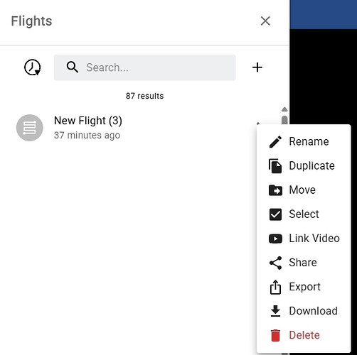

You have to make the mission Public by clicking the 3 dots right from the mission, then Share, then toggle the Public switch.
I have had a look at your flight log. There are some curious details in it.

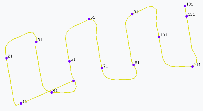

The portion of the flight that was controlled by waypoints (Joystick mode in the log file), was unremarkable. The drone executed the mission and went into return-to-home mode as soon as the mission completed. Here is a picture representing the portion of the flight in waypoint mode:

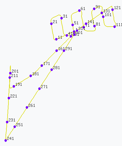

Now for the more interesting part.
At time=2 Min 48 s (point 124 in the diagram below): The drone completes the mission and switches to “Go Home”.
At time=3 Min 18 s (point 147 in the diagram below). The drone is as 185 ft altitude and switches to “Auto Landing”. It is hard to see but point 147 is really close to your home point. So far, the drone is behaving perfectly normal.
This is where it gets interesting.
At time=4 Min 13 s the log shows the drone at an above take-off altitude of 0 (zero) but then it begins to rise and it is traveling to the southwest.
At time=5 Min 24 s after the drone has ascended back up to 40 feet, the drone is placed into “Tripod” mode for a short while with a speed of 0 (zero).
At time=5 Min 40 s (point 247 in the diagram below). The drone enters “Go Home” mode again.
At time=6 Min 35 s (point 304 in the diagram below). The drone enters “Auto Landing” mode again and lands near the home point.
The strange portion of your flight is between points 150 and 241. During this time the drone was in “Auto Landing” mode. It might appear that the drone was being blown off course. There is data in the log file that would help to confirm that but I am not experienced enough to decipher it. According to AirData, the wind was out of the north (346 degrees) at 23 km/h.
My best guess (and it is only a guess), is that your drone was being blown off course. Did it feel very windy at the time of this flight? Know that wind speeds generally increase with height.

To clarify, it is not possible to add a waypoint with Litchi Pilot because the app has no native flight planner and missions need to be edited in the Hub. In addition, area mapping does not allow waypoints to be added so this cannot be a planning error.

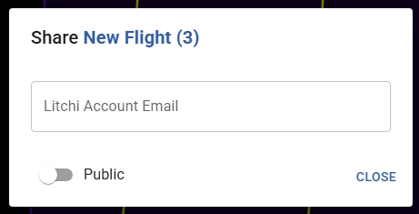

I think the flight schedule is public. I clicked on the 3 dots and activated public. Then I clicked on close.
Do I have to enter something in the “Litchi account email” field?
What should be in the “shared” section? If the flights I shared are supposed to be there, I don’t know what to do next. Help is needet.

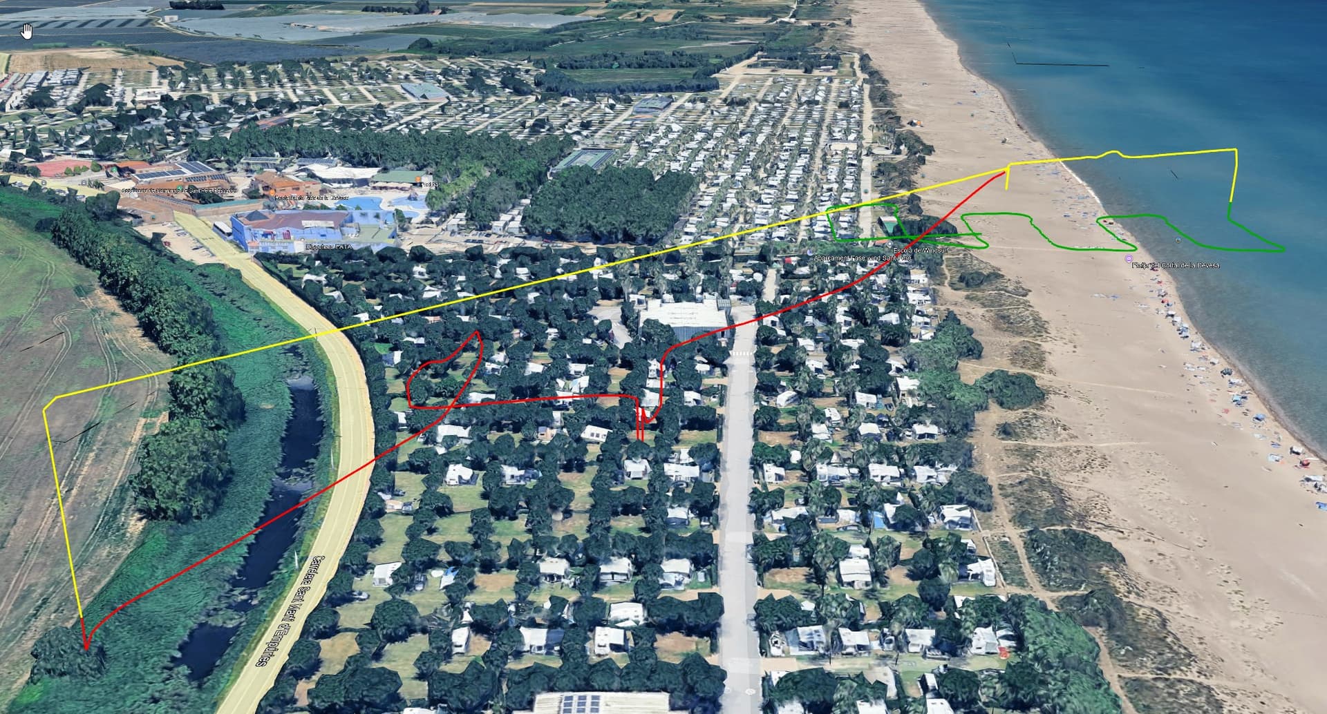

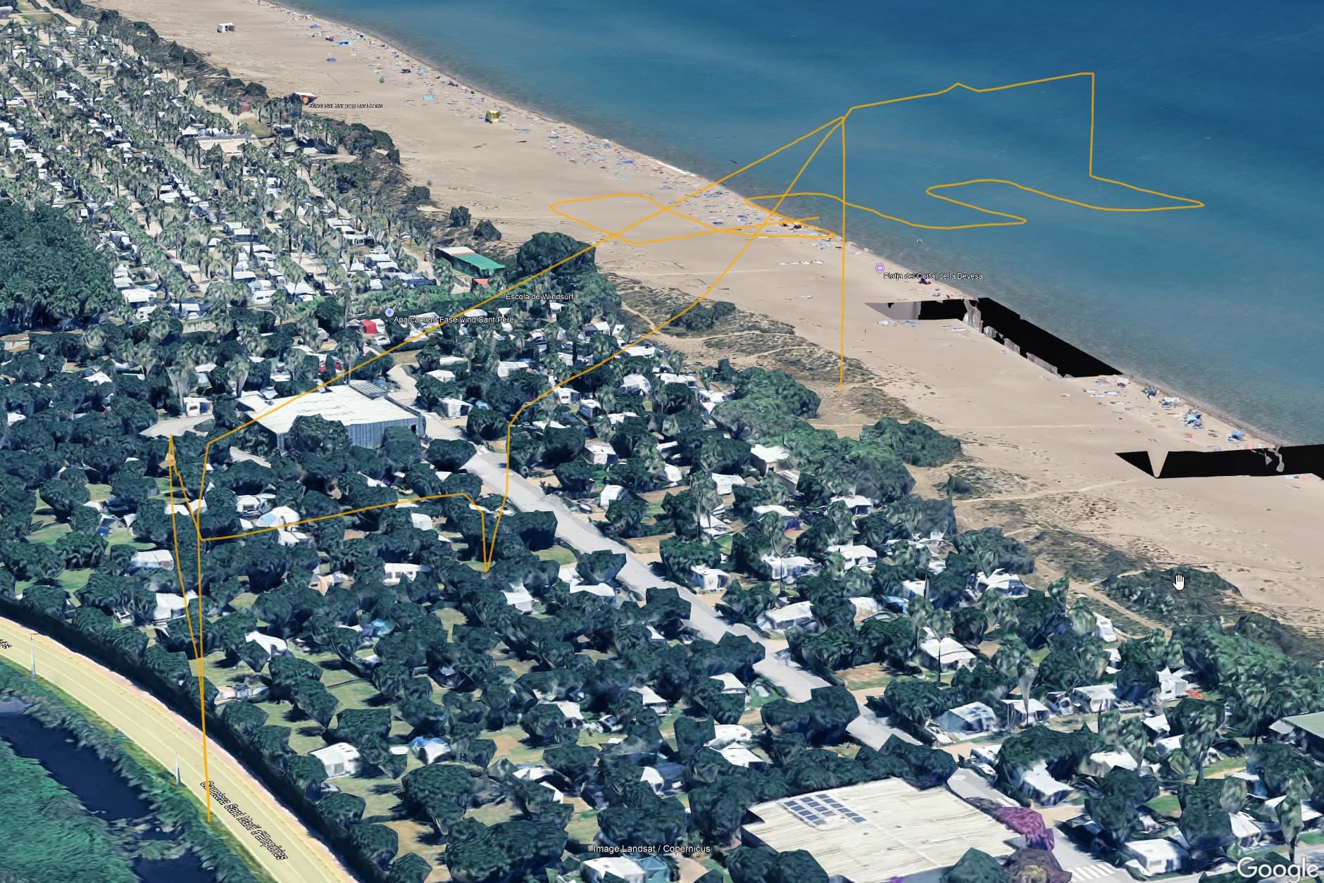

I have done some further analysis of your flight. Here is another snapshot from Google Earth where the flight path is colored according to the flight mode:
  • Green = Waypoint/Joystick mode
  • Yellow = Return to Home
  • Red = Auto Landing

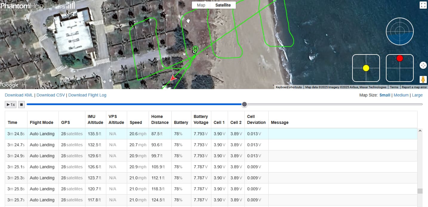

I then looked at the “Auto Landing” (red) portion of your flight log using the Phantom Help log viewer. The logs clearly show that you were using the controller sticks during the auto-landing sequence. Here is a snapshot showing you applying right stick forward during auto-landing causing the drone to fly to the southwest:
From what I can tell from the logs, your drone behaved exactly as expected based on the flight modes and your stick inputs. I can see your stick inputs that you used to counteract the auto-landing sequence. For unknown reasons, you flew further to the southwest during the auto-landing sequence. It is as if you got confused and pushed the right stick up instead of the left stick up to counteract the landing causing the drone to continue flying further away to the southwest.
If you dont mind can you link to how this data file was obtained.
It’s from the Airdata link that you provided, just viewed with a different tool.
