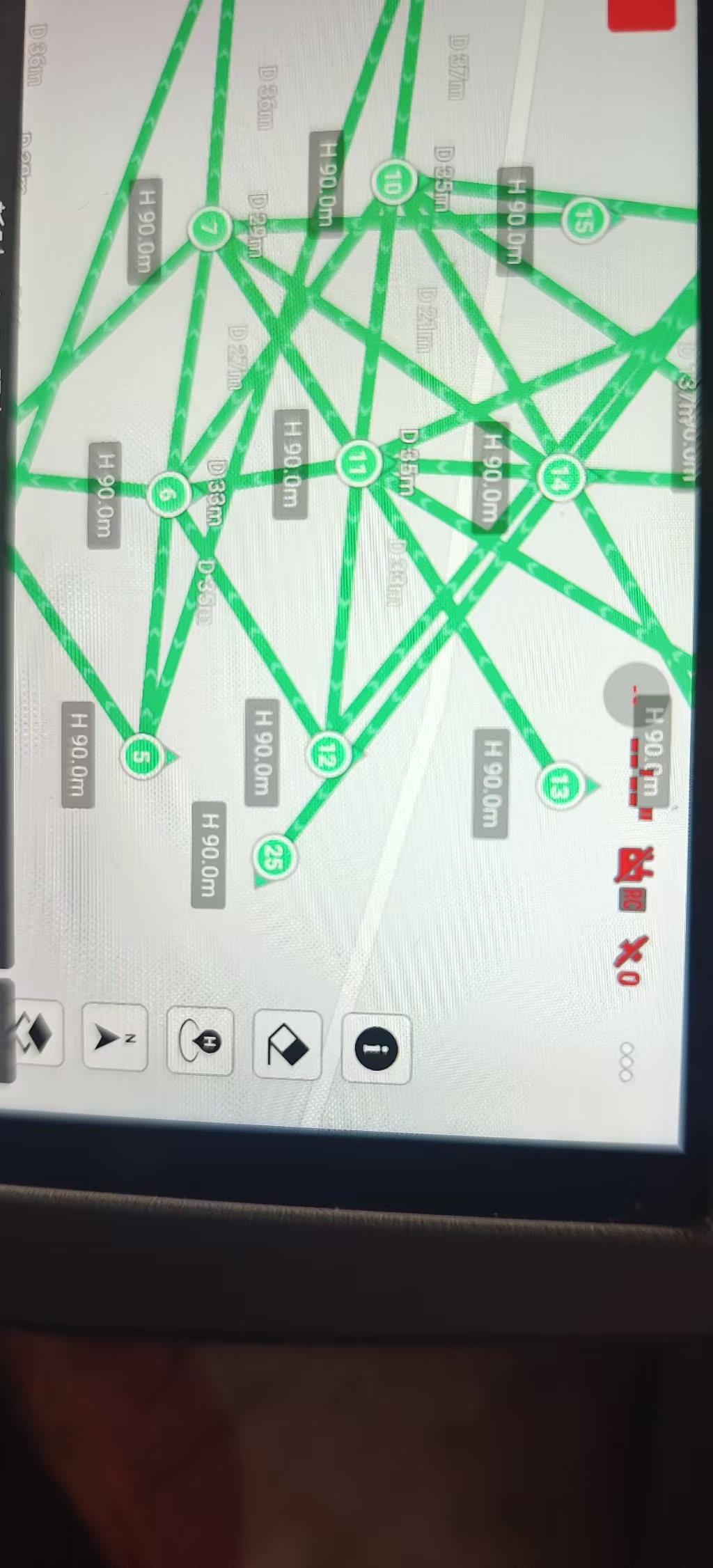

My device is Air3, why does it look like this when I export it to the remote control?
Drones of the type as mentioned in the title of this thread can ONLY use “Smooth Curves” as “Path Mode”.
If you have chosen either of the two other Path Modes in the new Litchi Hub, the mission will be displayed as shown in your picture. It should however run as a Smooth Curves flight plan.

Waypoint missions can be designed in Litchi’s Mission Hub with either straight lines or curved turns. The WPML language that DJI uses for waypoint missions in their newer drones also supports either straight lines or curved turns. However, DJI’s implementation of waypoints in DJI Fly does not provide a way to specify a straight-line mission. Even so, a straight-line mission can be designed (in Litchi’s Mission Hub), saved as a KMZ file, and uploaded to DJI Fly. The display of the mission will look weird as you have shown in your screen capture. Despite this, the straight-line mission will be executed properly using straight lines when flown. This is just one of those quirks in DJI’s implementation of waypoints.

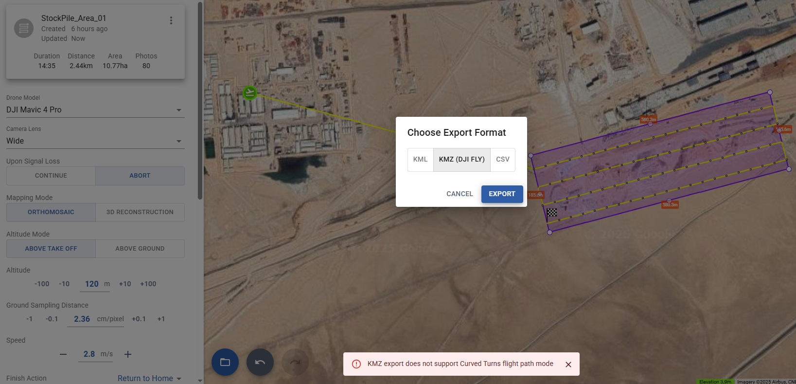

But, for my Mavic 4 pro, when I select “Curved Turns” instead of straight path and try to export KMZ (dji fly), the mission hub ends up showing an error “KMZ export does not support Curved Turns flight path mode”. :disappointed_face:
Please see the attached screenshot.
Yes, that is correct. My response above was to clarify why straight-line missions looked weird when imported. I did not go into detail about curved-turn missions.
There are two types of curved-turn missions: those where the mission path passes through the waypoints (DJI style) and those where the mission path does not (Litchi style). If you are planning to export the mission as a KMZ file, you must choose the DJI style of curve. In the Mission Hub these are called “Smooth Curves”. If “Smooth Curves” are selected, your mission will export correctly.
