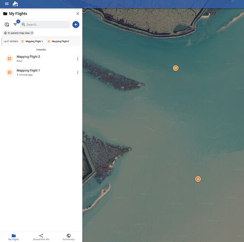

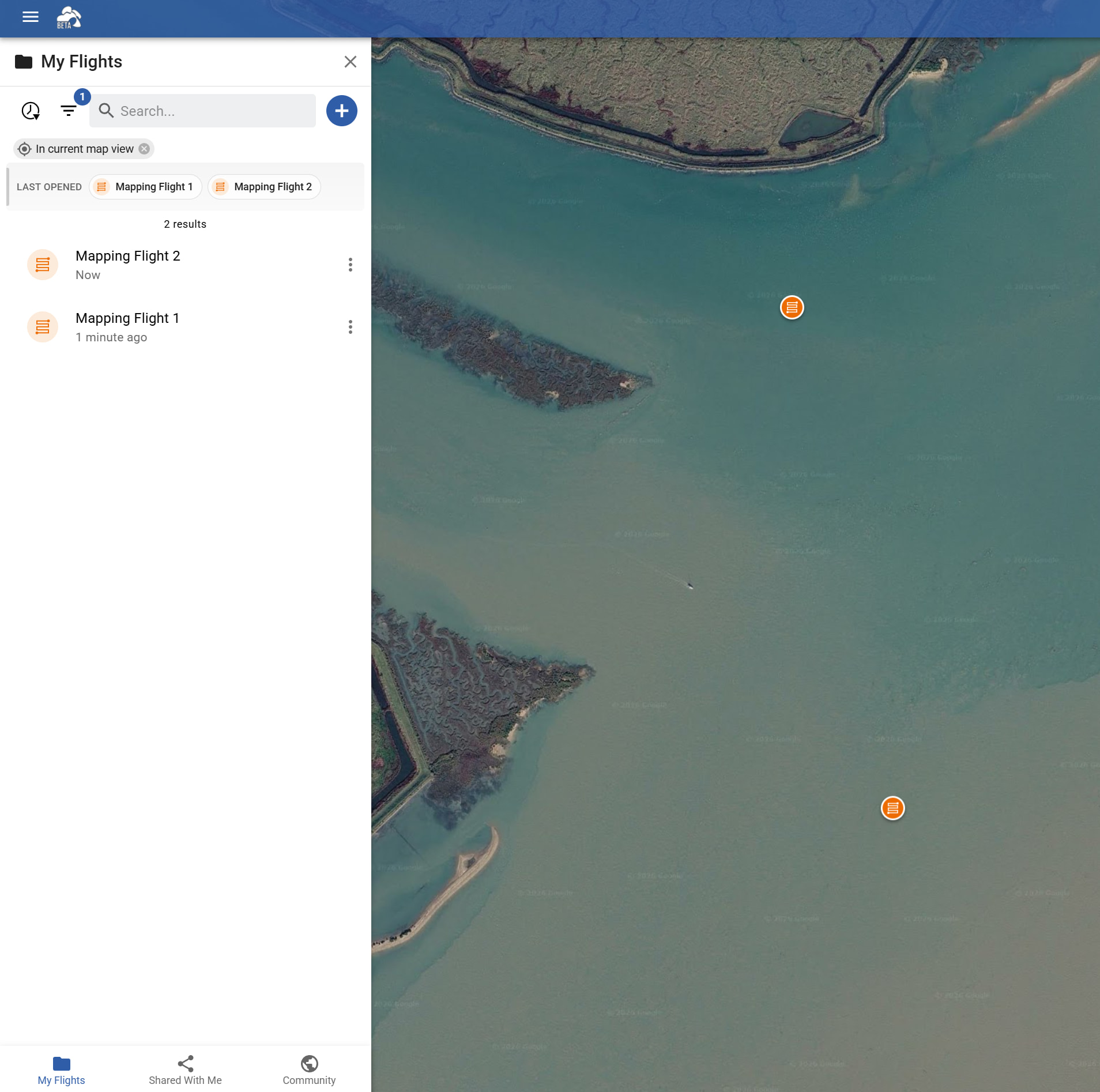

  9. Open the flight library, then you can see all your flights on the map displayed with blue map markers, click on a marker to open each flight. Only one flight can be open at once.

9. Can you please elaborate on this? Within Hub beta, when I open the left nav, I see a list of flights, but they’re only plotted on the map one at a time. What we’re hoping for (and this is critical for many mission types across many industries/use cases) is the ability to have all the previous missions plotted on the map at once and to then be able to use this information to create a new mission and set its boundaries to align with one or more of the previous missions. Without this, I don’t see a way to ensure contiguous coverage of an area (within Hub, and without first having to create KMLs in GE/GEP/etc.). Even if the waypoints could be set via specific coordinates (which is another useful feature to have), it would be very time consuming to have to grab them from the previous missions and set them for the new missions, particularly with irregular polygons with many boundary waypoints like we typically have in wilderness areas. In most non-drone map apps, one can create unlimited polygons, that all exist on the map at once, and then grab their boundary waypoints to quickly adjust and align them as needed.

  2. This is what I mean, you can see the markers indicating where each flight is, you can not however open 2 flights at once:
Re: 9, I don’t understand how Litchi pilots are planning their flights within Hub then. I’ve rarely flown a location without the need for multiple contiguous mission polygons and, without this basic function, we’d have to create the polygons in GE/GEP/etc. first. Is this in the pipeline to be addressed?

To keep earlier flights visible while planning the next one: open the previous flight, Export it as KML, then Import that KML back into the Hub. It is added as a Map Overlay (Map View Settings), which stays on the map independently of whichever flight is open, with its own on/off toggle, color and opacity. It shows the flight path rather than the polygon outline, but for a mapping flight the extent of the lanes is exactly the area that was covered, which is what you want to align the next area against.
To answer your question directly, no, showing several flights at once is not in the pipeline as this is the first time we have had that request.
