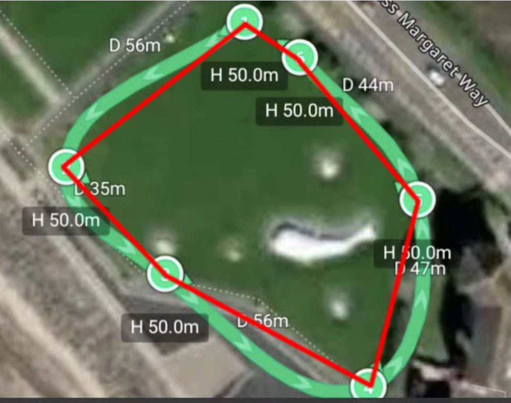

Thanks for your answer. I’ll answer to “the direct flights” with the attached picture : I want the drone follow the red way and not the last that applies DJI ; I tried by creating a kmz file in Maven but once tranfered in Dji Fly the flight is turned to the green ! Since my question I think it would be better to choose a Air 2s which is more secured with the obstacle detection. and it is usable with Litchi.

Pure straight line missions are only possible with drones compatible with the original (old) Litchi for DJI drones app.
Litchi for DJI Drones is compatible with: Mini 2, Mini SE (version 1 only), Air 2S, Mavic Mini 1, Mavic Air 2, Mavic 2 (Zoom/Pro), Mavic (Air/Pro), Phantom 4 (Standard/Advanced/Pro/ProV2), Phantom 3 (Standard/4K/Advanced/Professional), Inspire 1 (X3/Z3/Pro/RAW), Inspire 2 and Spark.

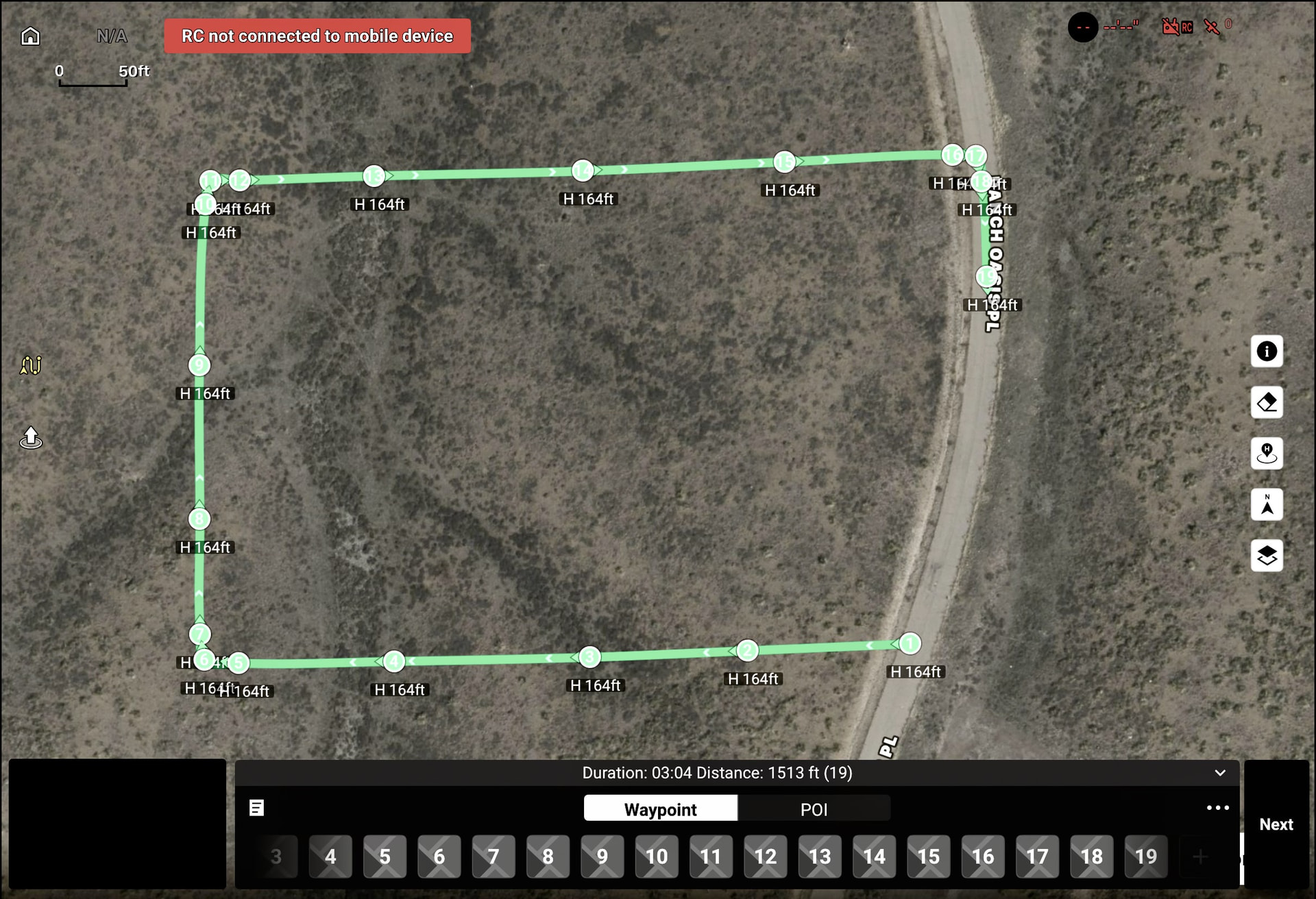

The only way to get relatively straight paths with DJI Fly waypoints is to add more waypoint’s close together particularly on the turns. They will never be completely straight but much better with more waypoints. Of course you would need a newer drone which supports DJI Waypoints like the Mini 4 you sold which as indicated has SDK support for third party apps. So you need to decide if you want a legacy drone or a newer drone which has SDK support and DJI Fly waypoints. Enjoy.
All drone models supported in Litchi Pilot can fly real straight lines in Litchi Pilot, including Mini 3, Mini 3 Pro and Mini 4 Pro.
