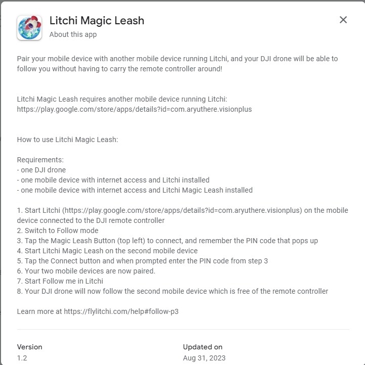

If you still have your Phantom (or any other Litchi compatible drone), you could consider “Litchi Magic Leash”. One of the runners would have to carry the 2nd mobile device.
