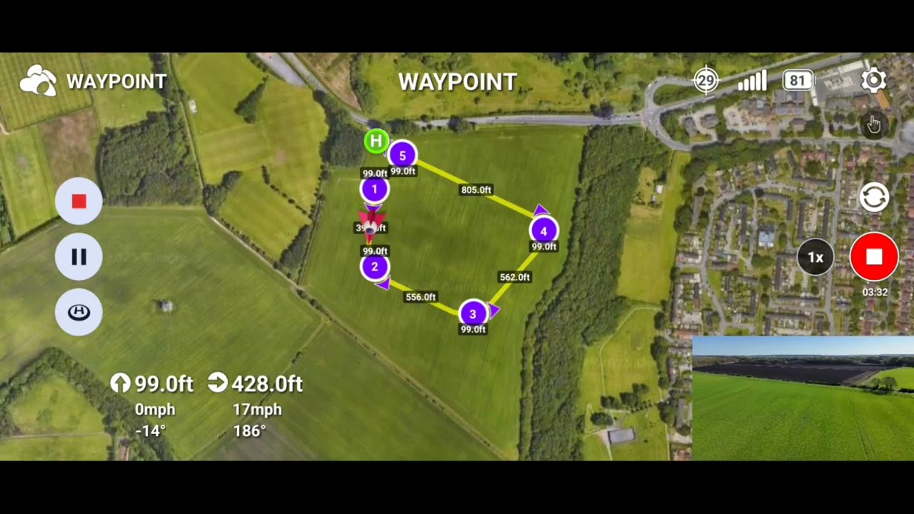

I tested waypoints and as expected, other than the strange method of having 2 screens to go through, the initial screen for planning then going back to the screen that launches the mission all worked fine except for when i choose reverse as finishing option nothing happens

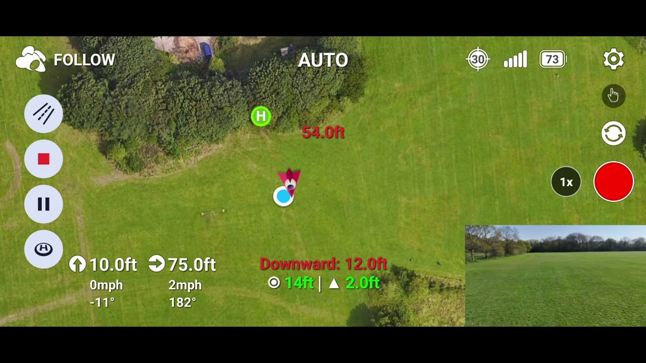

Also follow mode, im probably doing this wrong so please let me know as there isnt much in the way of instructions i can find, either way the quad had a mind of its own.

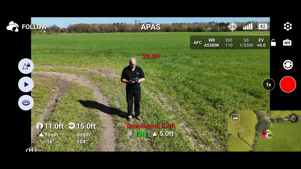

Also what are the red numbers that appear, i can guess the lower number is downward height but why is the top numbers appearing

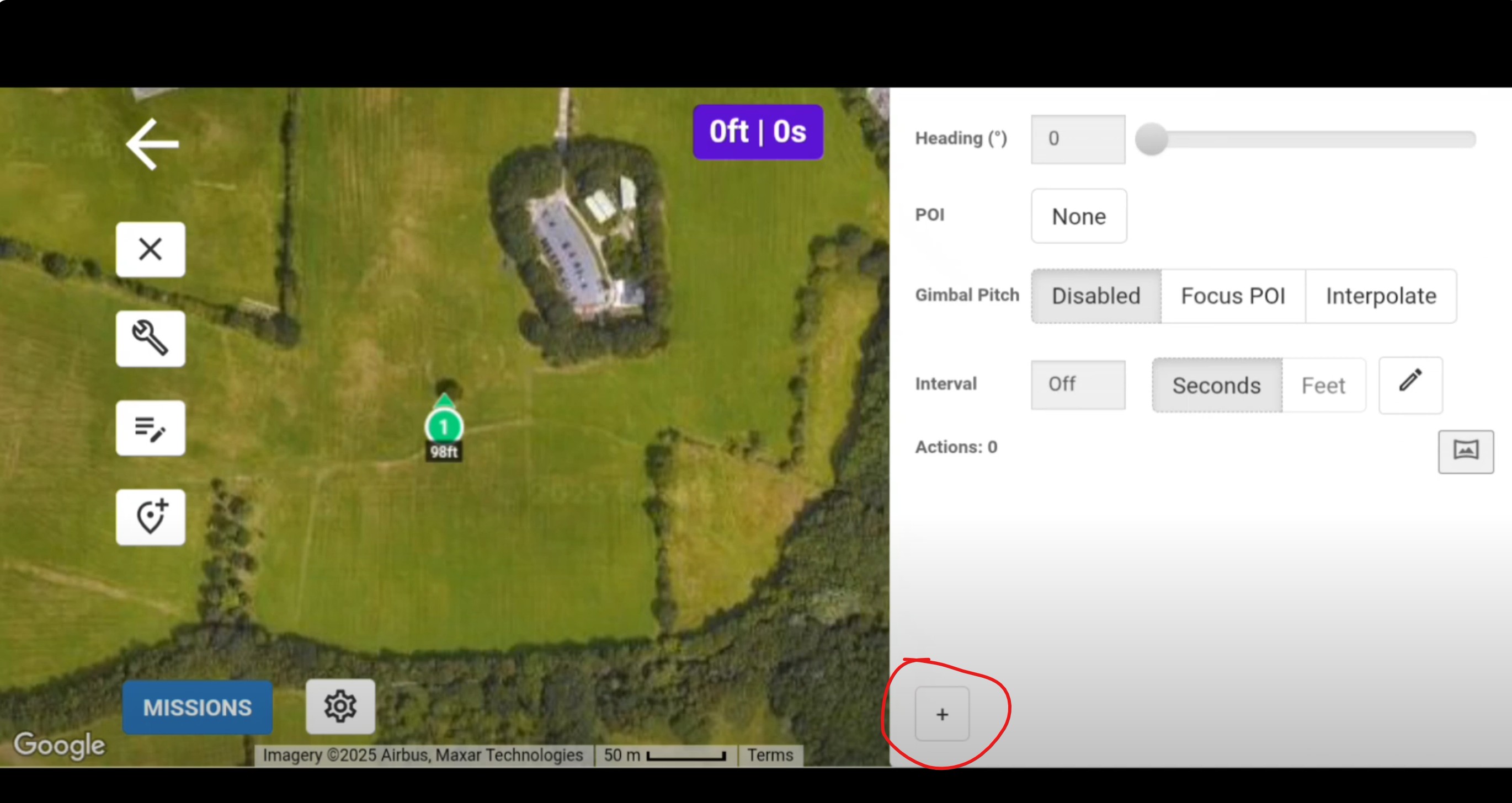

Oh and also in waypoint mode how do i add “start record” as an action, there is no option, all i can see is autopano option which adds the relevant settings, as a workround i just delete all the options and set the first to Record

Reverse finish action: it will soon be renamed to ‘Hold’ to reflect its meaning better. It means the drone holds position at the end of the flight, allowing you to reverse manually along the path using the joystick.
Follow issues: it looks like the main issues here is:
  1. your mobile device has no pressure sensor leading to unstable mobile device altimeter (as it relies on GPS altitude)
    and 2) overall your mobile device GPS accuracy is not the best at 4+m so I would suggest moving the drone a bit further away from you (remember GPS Follow is better suited for long range following due to GPS accuracy). However it does behave strangely overall, unsure why but to me it looks like the mobile GPS is not where you actually are (check the map to see if the mobile device icon matches your real location)
Downward is distance to nearest obstacle below the drone, the red number at the top is distance to nearest obstacle in all other directions.
You can add a start record action in the hub just like before by adding an action and changing the action to start record. Could you show us a screenshot of where you don’t see the option? Maybe a UI bug

  2. yep I have had a good play with follow, the results are shown in the video
  3. Also in the video i show the adding of a WP and my inability to find out where i choose an Action, also a screen shot of the webpage hub with the same thing.

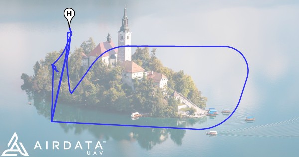

Also in regards to the data about the battery level, it seems that Airdata is the cause of that, i do get a battery percentage when i use the phantomlogviewer program to get a CSV file
Click on the + to add an action.

Your Follow video shows gimbal tilting up/down quite a lot due to the mobile device altimeter being quite unstable, again this is due to it not having an air pressure sensor. Lower to mid tier android devices don’t have these unfortunately.
Yep got that thanks Vico

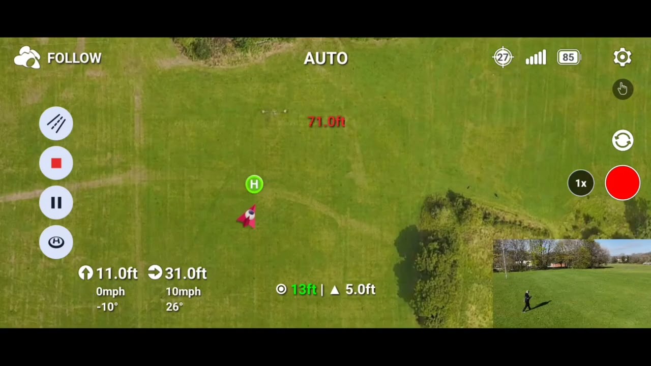

Ok so another test of follow mode now using the Samsung S20 and the follow mode is still behaving in a wierd way see the video.

The mobile device accuracy is not great (between 4-6m), ideally you want 2-3m. Move the drone further away to get better results with reduced mobile GPS accuracy.
Also the Adaptive heading mode is better suited for following higher speed movements (running/cycling/car etc.). For walking it’s better to use Locked heading mode (change it using the top button on the left side of the screen).

Yes - at that point the drone is like on a string.

Also I couldn’t find anything about choosing an object to follow (no frame appears) and nothing about this random circular motion at the beginning of a following action (the drone seems to position itself somewhere but where, how and why). I’m using a Samsung Galaxy S24 which seems to have a pretty good barometric sensor so I have no problems with accuracy and focussing the object, I just don’t understand the drone’s behaviour and which app setting effects which drone maneuver.
Locked is the same as the old North mode and Adaptive is the same as the old Course mode, they have just been renamed, see old user guide for more info Help - Litchi
When you start follow, place the drone in the position you want it to follow from (front/side/back etc) and frame the subject (i.e. make sure you are in the center of the video frame). For Adaptive mode you should also face the intended travel direction before starting (it uses your mobile device compass).
Locked essentially means the drone always tries to keep the same heading. Adaptive means it keeps the same heading relative to the direction you travel in (best suited for running or faster movements).
