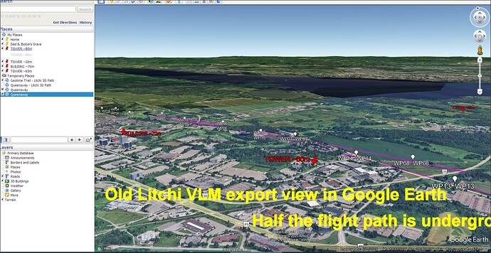

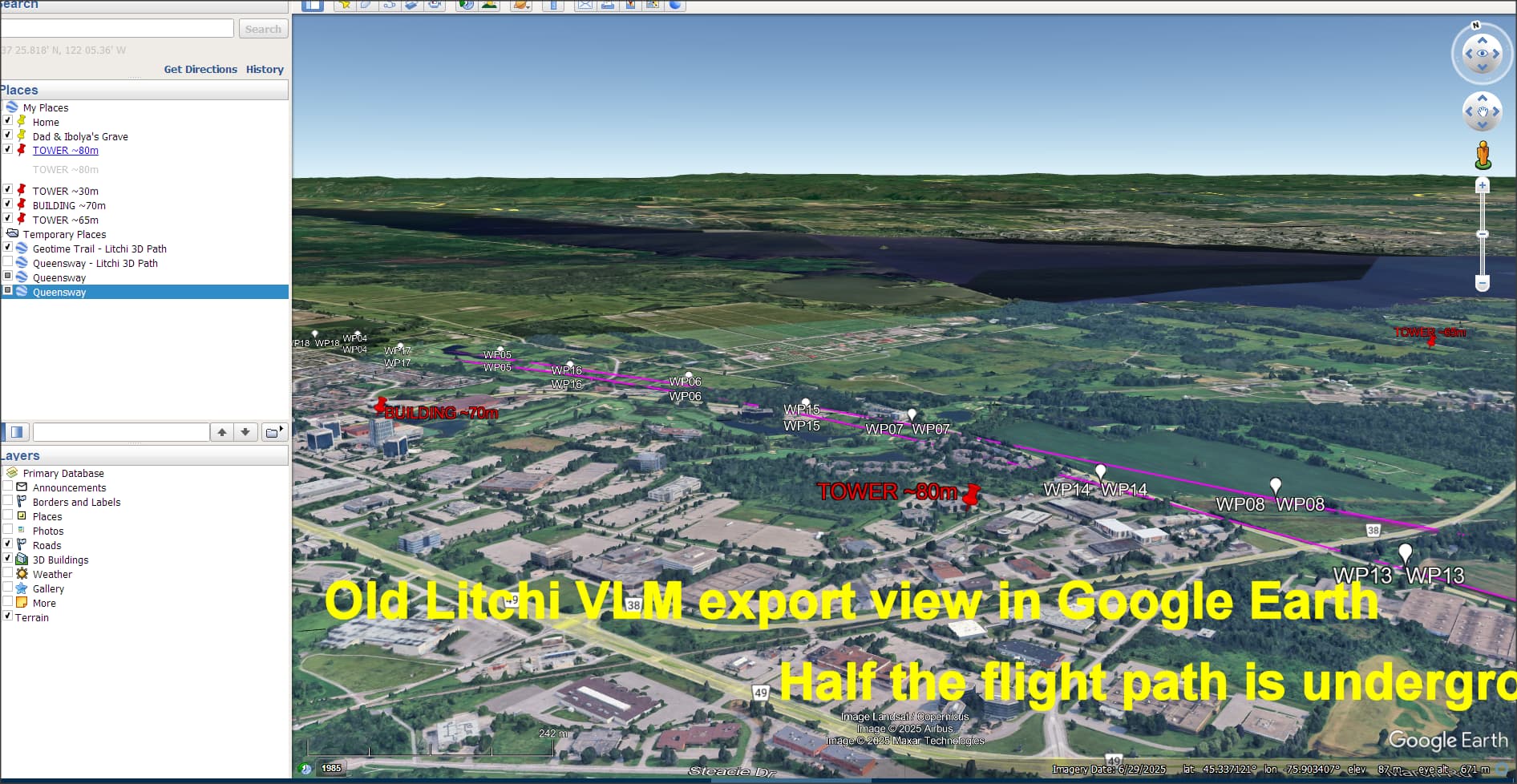

As many of you have suggested, I’m posting more details about my issue. The reason I believe it’s a software bug is that I’ve been using Litchi for 5 years and have NEVER encountered this issue, until the introduction of “The Next Generation Litchi Hub”. Now I’m having the same problem with the old and also the new “next generation” hub. Coincidence?
Even more why it smells like shoddy software is that occasionally, after reloading the mission, the altitudes do display correctly even though my mission did not change!
I have 4 screenshots to illustrate the issue, but the Litchi code monkeys have limited embedded media (= photos) to only one since I’m a new user. Being a paid user of Litchi since 2020 does not count, it seems. So as much as I would like to include more, I have been constrained to including only one screenshot.
In the OLD litchi view, altitude is OK.
Exporting to VLM from the old Litchi and opening in Google Earth, altitude is incorrectly very low.
In the new next generation Litchi view, altitude is OK.
Switching to the Google Earth view inside the next generation Litchi, altitude is also too low: I
I’m running Firefox 142.0.1.
