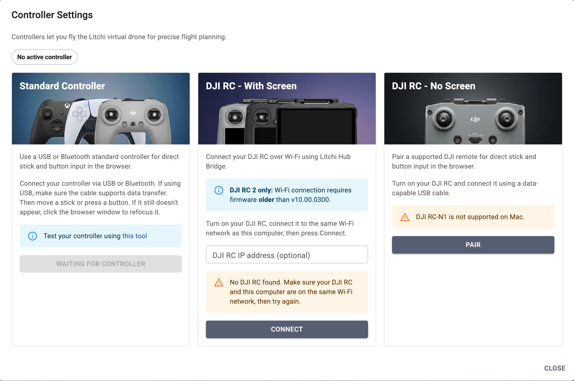

DJI Air 3 + DJI RC 2. RC 2 gisteren geüpdatet naar de nieuwste firmware. Hub Bridge vandaag geïnstalleerd. Mac Mini met macOS Tahoe 26.5.1. RC 2 wordt door macOS via USB herkend, maar Litchi Hub geeft ‘No DJI RC found’. Is dit het bekende firmwareprobleem boven v10.00.0300?
DJI Air 3 + DJI RC 2. Updated the RC 2 to the latest firmware yesterday. Installed the Hub Bridge today. Mac Mini running macOS Tahoe 26.5.1. The RC 2 is recognised by macOS via USB, but Litchi Hub displays ‘No DJI RC found’. Is this the well-known firmware issue affecting versions above v10.00.0300?
What are you trying to do, export flights or fly the Litchi virtual drone with your RC?
To export flights, connect via USB and follow this guide [GUIDE] How to use Litchi Hub with DJI Fly / SkyRover
To fly the Litchi virtual drone with DJI RC 2, you need a firmware version older than 10.00.0300, it no longer works with latest firmwares
Thx…the problem is definitely the DJI RC2 firmware. I hope there wil be soon a patch or a work-arround.
