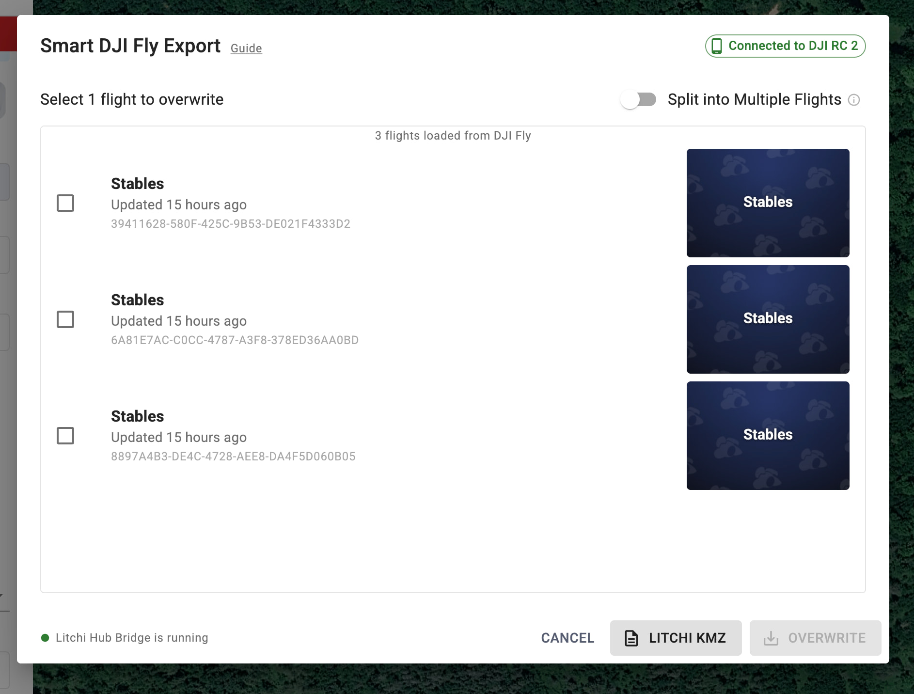

I made a waypoint mapping mission with Litchi Hub then used the hub bridge to transfer the mission into the RC2. Problem is iis not showing up on the RC2 after I’ve overwritten a mission with the bridge. What am I missing. I’m using chrome on a mac mini with the controller connected to the mini.

When you transfer a KMZ file (waypoint mission) from the hub to the RC2, the mission being replaced cannot be open during the transfer. Either display a different mission or exit the waypoint function completely before transferring.

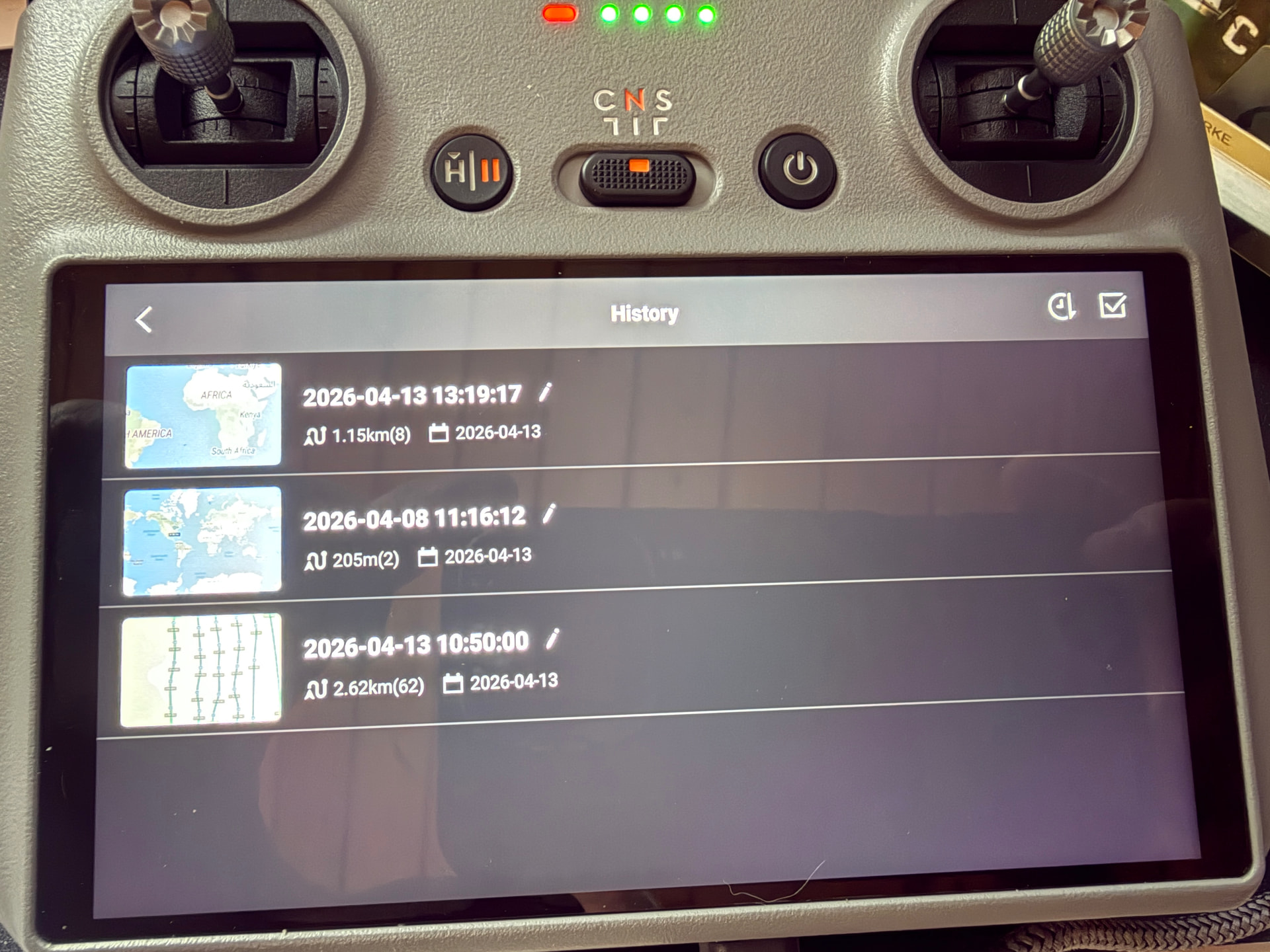

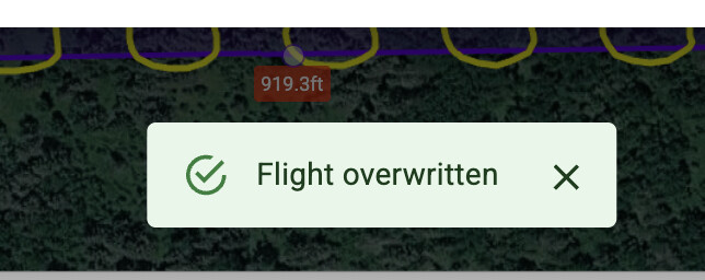

Its a mac mini and a mini 5 pro. Drone is not connected to the controller when I attempt the transfer. Just try it again from the home screen and still not transfering or overwritting the missions already loaded. Also says overwitten on the when clicking on the transfer button. But still not showing up on the controller.
All of these should now be the new mapping mission , but not.
Your transfer appear successful. When you open the missions in DJI Fly, and move the map to the location of the Litchi Hub flight, do you not see the waypoints?
Please note the Litchi Hub flight name does not transfer, and the waypoint image will only update if you follow the steps in the guide to the letter especially step 2 (creating a dummy just before overwriting): [GUIDE] How to use Litchi Hub with DJI Fly / SkyRover
The mission being overwritten cannot be loaded. If it is loaded, the transferring of the new mission will silently fail.
I think i got it. I reset everything in the RC, deleted all waypoint missions, made a short mission and did the transfer with overwrite and I see the new mission in its place. Now need to get out and try it.
