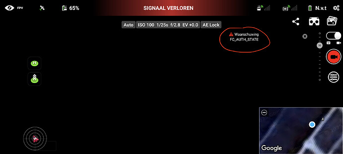

Earlier this week I purchased the Litchi app. My idea was to create a kind of hyperlapse of the construction of our clinic using waypoints and the new Litchi Hub, since DJI does not support this on the Mini 3 Pro. However, I am unable to connect to the drone. As instructed, I removed the DJI app and configured Litchi as the default app. At first, it seems to connect briefly, but shortly after I get the error message below, and nothing else happens. Could someone tell me what I might be doing wrong? I am using the Mini 3 Pro in combination with the RC-N1 controller and a Google Pixel 7 with the latest Android OS installed.

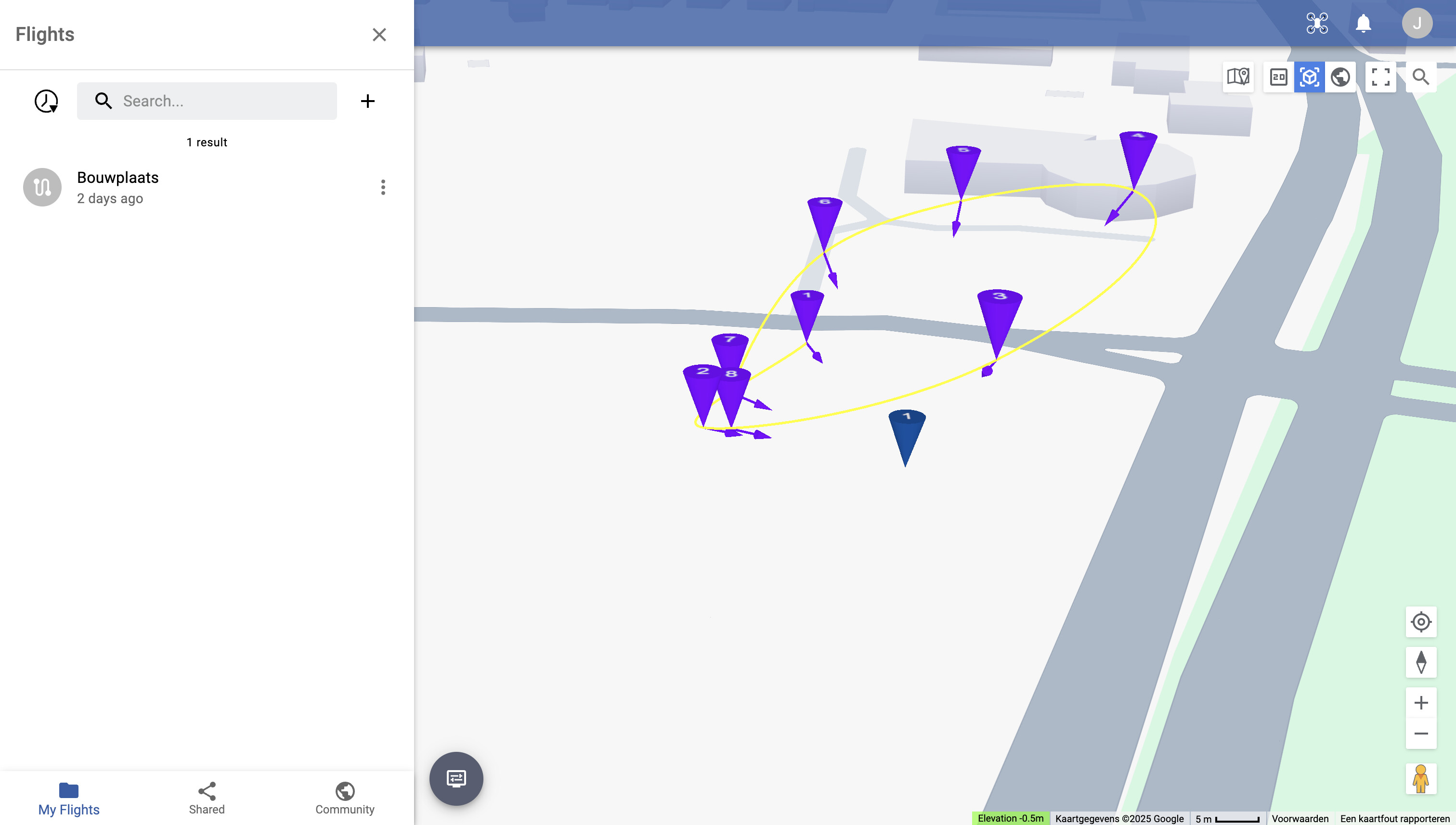

Then I have a second question. In Hub, I programmed the flight below. I can see it in my files in the app, but when I load it, nothing happens. Can I only view it when I am nearby? Or is there something else I need to do that I might have overlooked?

Use Litchi Pilot Beta for Mini 3 Pro, see [OPEN BETA] Litchi Pilot
That will solve both issues
Thank! Works like a charm :slight_smile:
