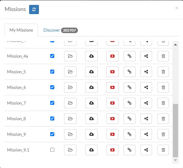

Because I cannot duplicate what you describe would you be willing to share a mission so that I could open it using VLM and preview the flight with Google Earth Pro? Make sure you share one that exhibits this incorrect behavior. To share a mission, uncheck the “Private” checkbox in the “Open” dialog, then copy and paste the URL here.
Same result. There is no URL displayed in the address bar of the browser. Is it possible to mission file to a file sharing site? If so, do you have one I could upload the mission file to?

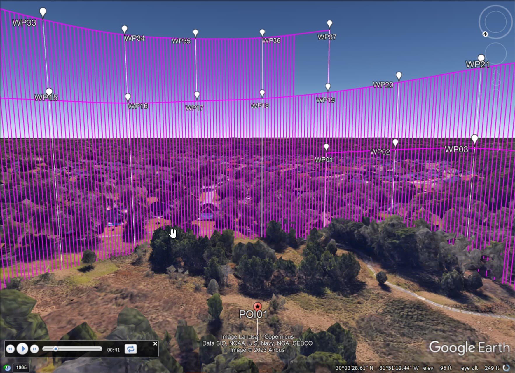

I just saved the mission you shared in my Litchi account and then used VLM (v2.8.2) to preview it and it previewed as expected with the heading view always pointing to the POI in the center. I don’t know why it is not working for you. Try resetting your VLM settings by holding the “Shift key” down while opening VLM.
Here is a snapshot of what your mission preview looks like from my system:
