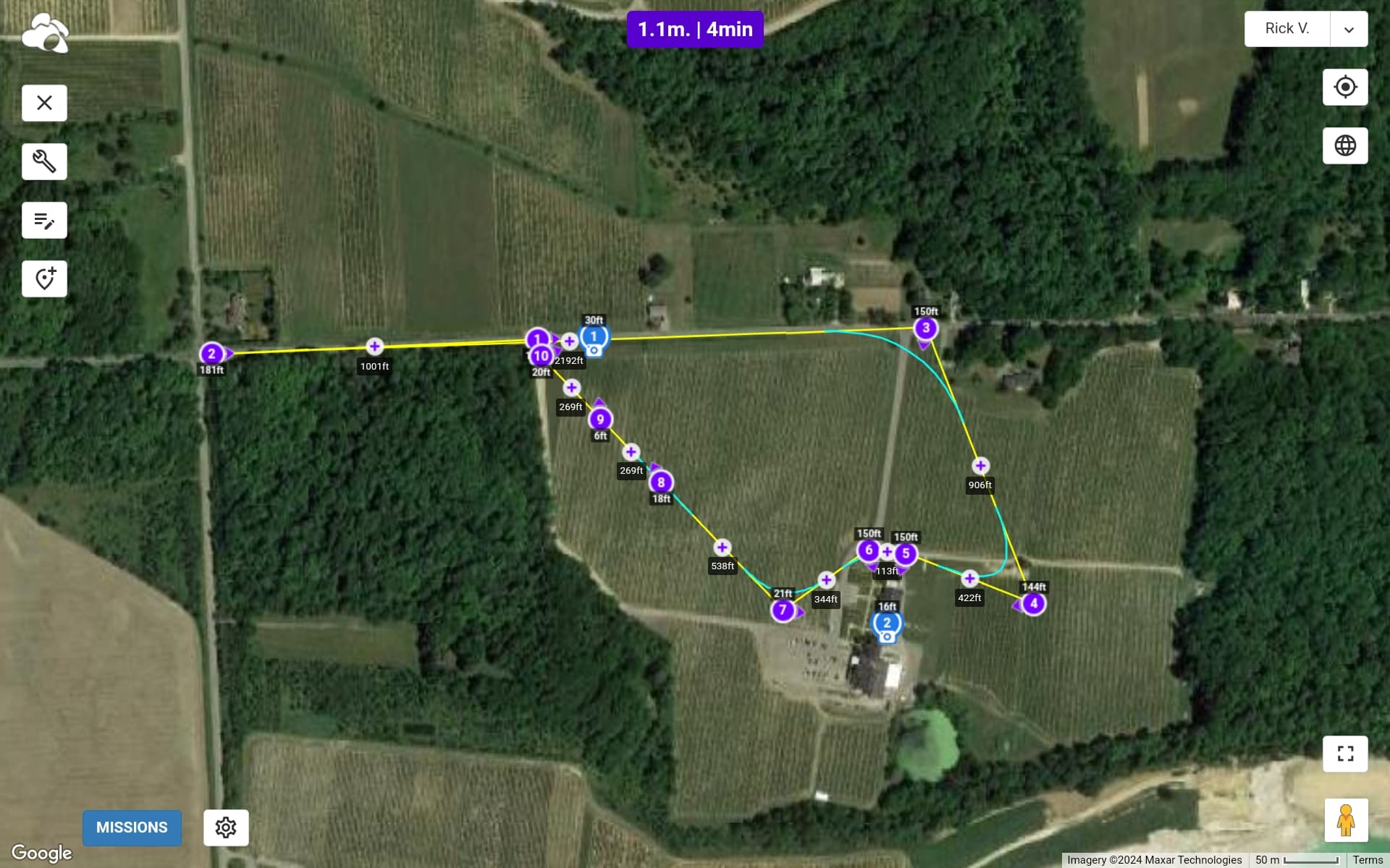

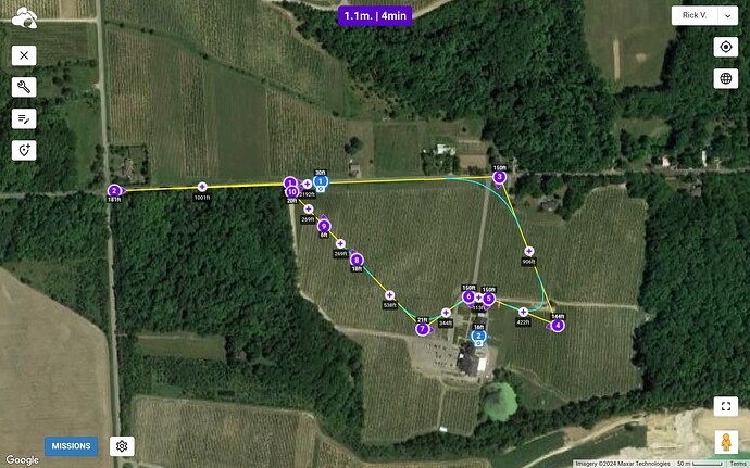

I’m doing a video for a winery, and I want to fly low over the vines, like 20ft. Waypoint 9 says 6ft. Altitude is set at 20ft, and Above Ground box is checked. Can you help ease my mind before I send Amelia on a suicide mission!
Thanks for your help
Rick
Share your mission. There’s not enough information in your post to provide assistance
This is it…
Sharing an image of the flight isnt the same as sharing the mission.
Follow the info in this post to share your mission.
