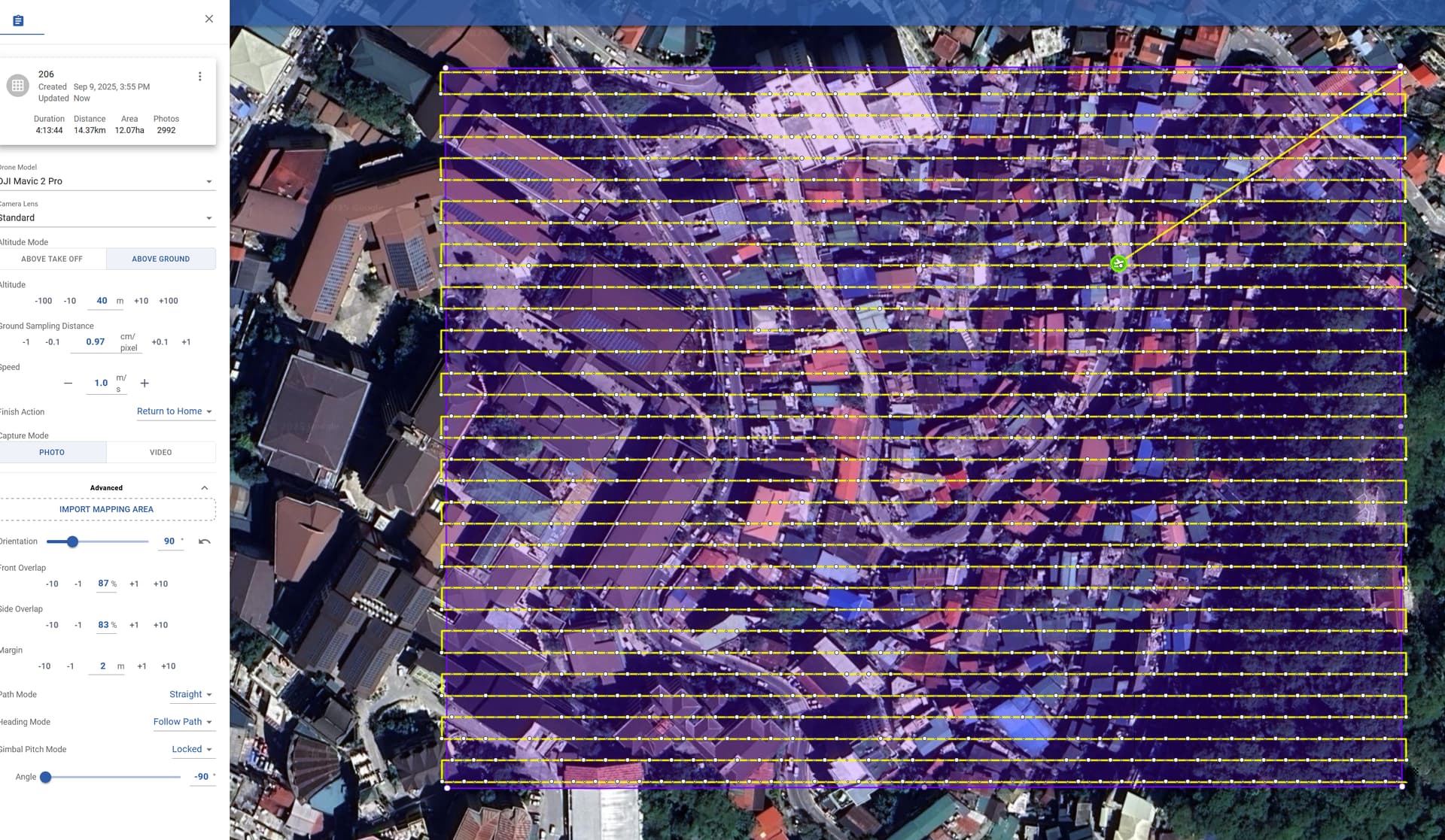

First image shows the settings where everything still works

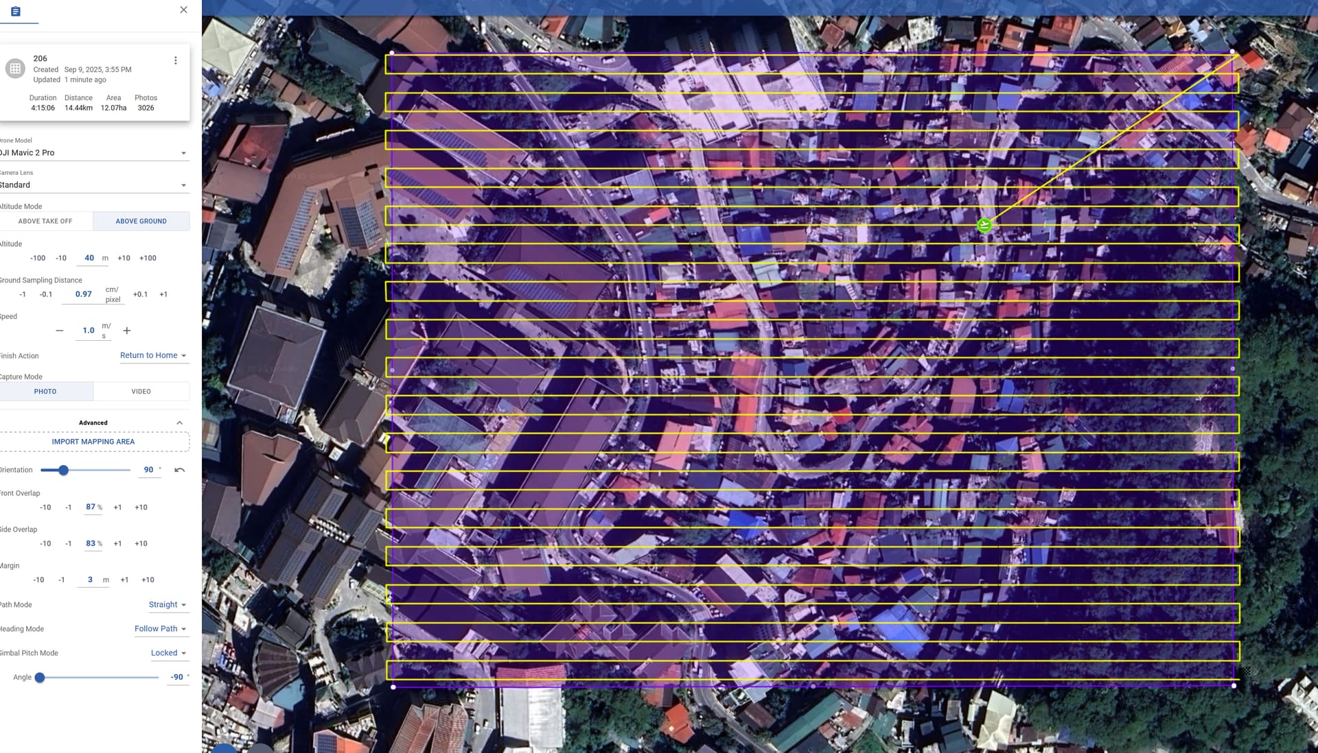

Second image I increase the Margin from 2m to 3m
There is no rational reason why litchi suddenly claims to make 0 photos during this survey - but that’s what it says.

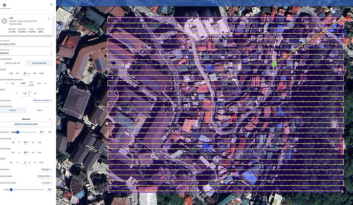

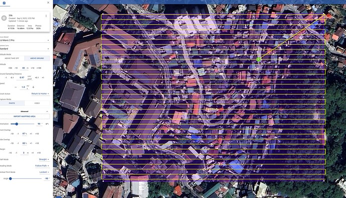

This isn’t a bug, but a performance optimization. When a flight plan includes more than 3,000 photos, their positions are hidden on the map to ensure smooth performance. However, the total photo count is still displayed in the mission summary.
Thank you so much for confirmation the survey will still just run fine ![]()
