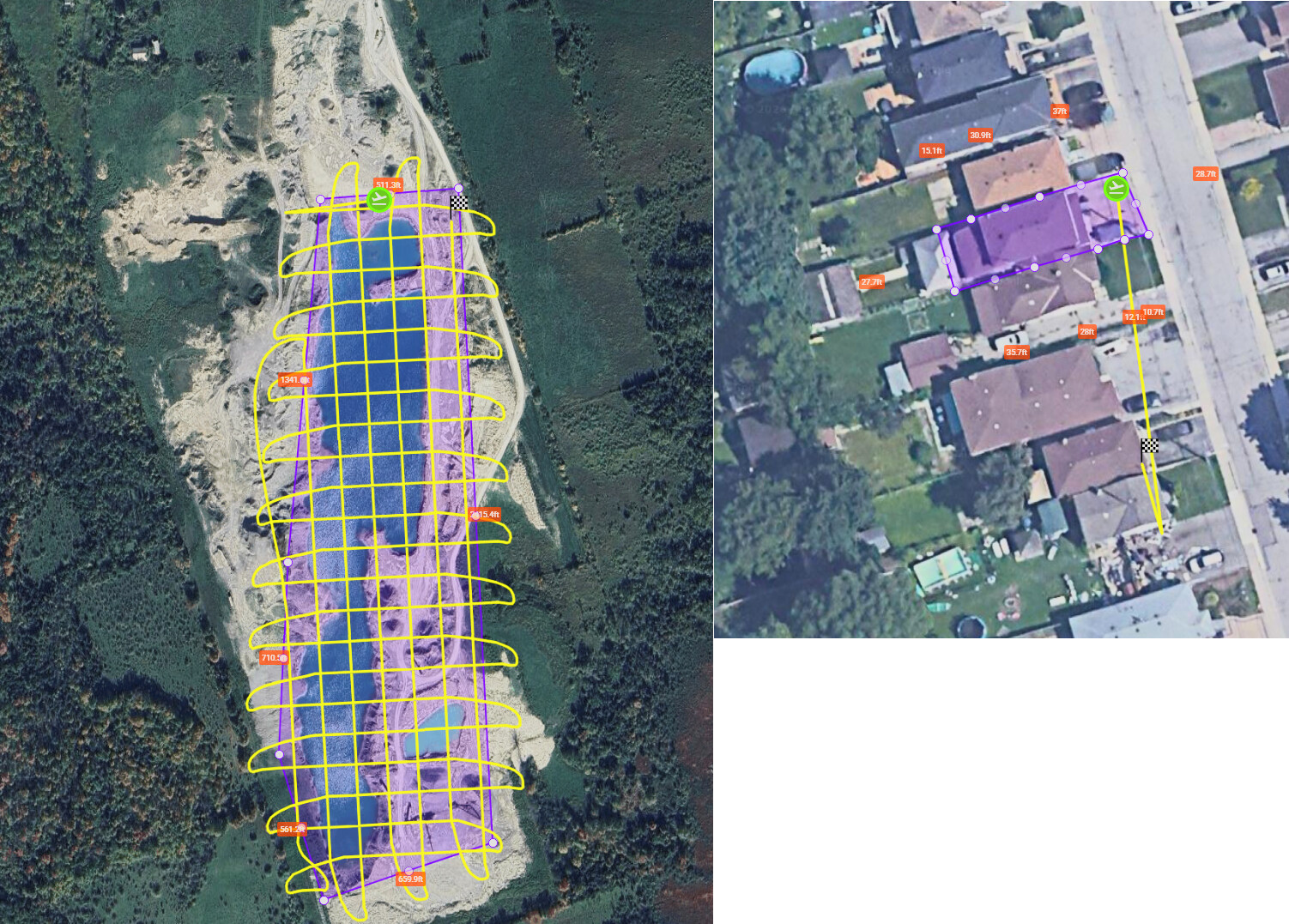

Hey all, first time working with the platform. I am having a weird bug or whatever it is. The left is a area map flightplan I generated for a property I hunt at and as you can see, no issues whatsoever. But since it’s almost 1.5 hours away I wanted to test it close to me. As you can see using same setting some how it only paths 3 waypoints and not even inside the purple area I made.
Is this because it’s in an urban area or is there a setting I am missing because the mapping region is small?

From the screenshot you attached, it looks like the area is very small which means one photo would cover everything. Photos taken outside the area is likely due to being in 3D model mapping mode (gimbal angle is tilted then)
