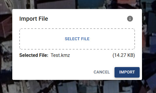

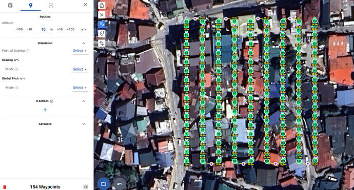

First I import a file.

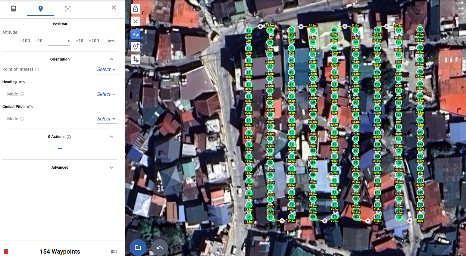

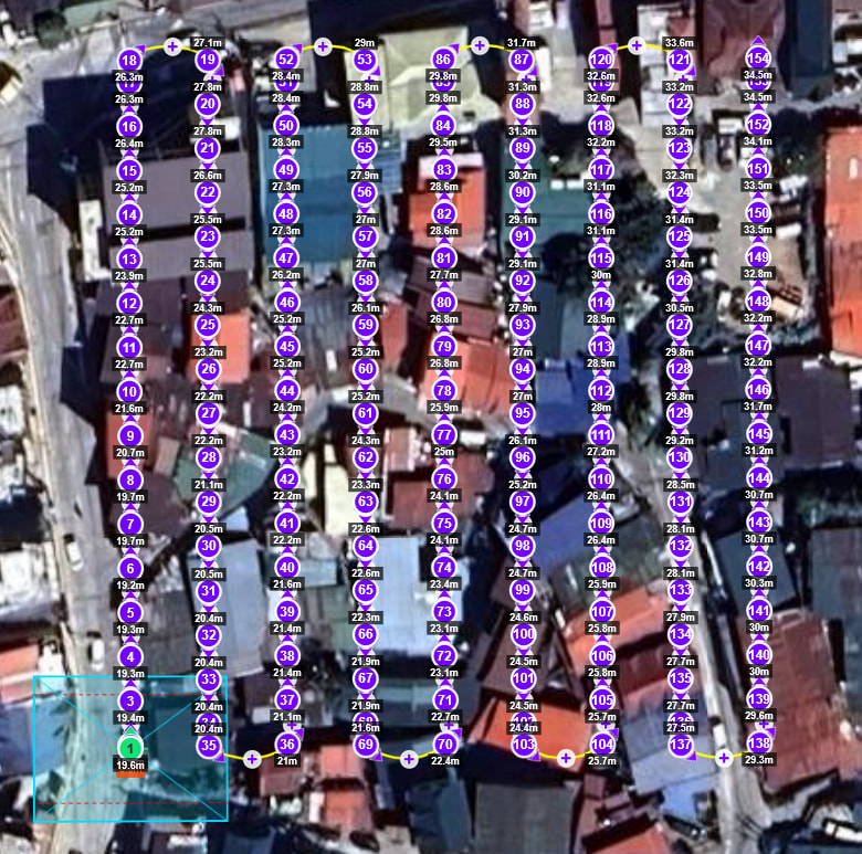

See the values in ATL
I select them all

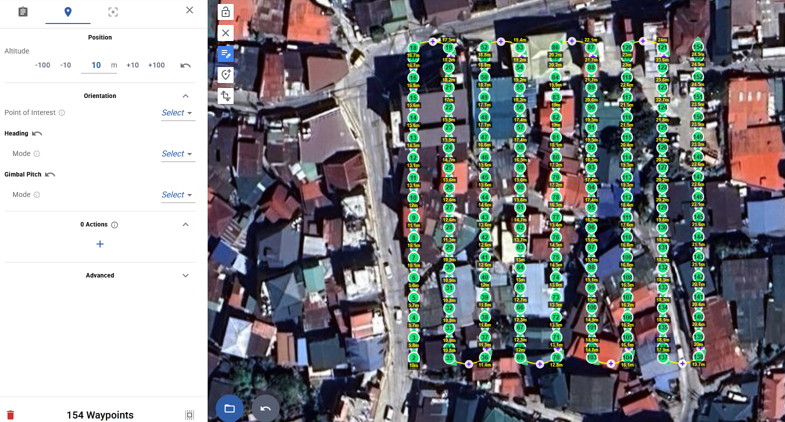

Now I click +10
Something isn’t right here …

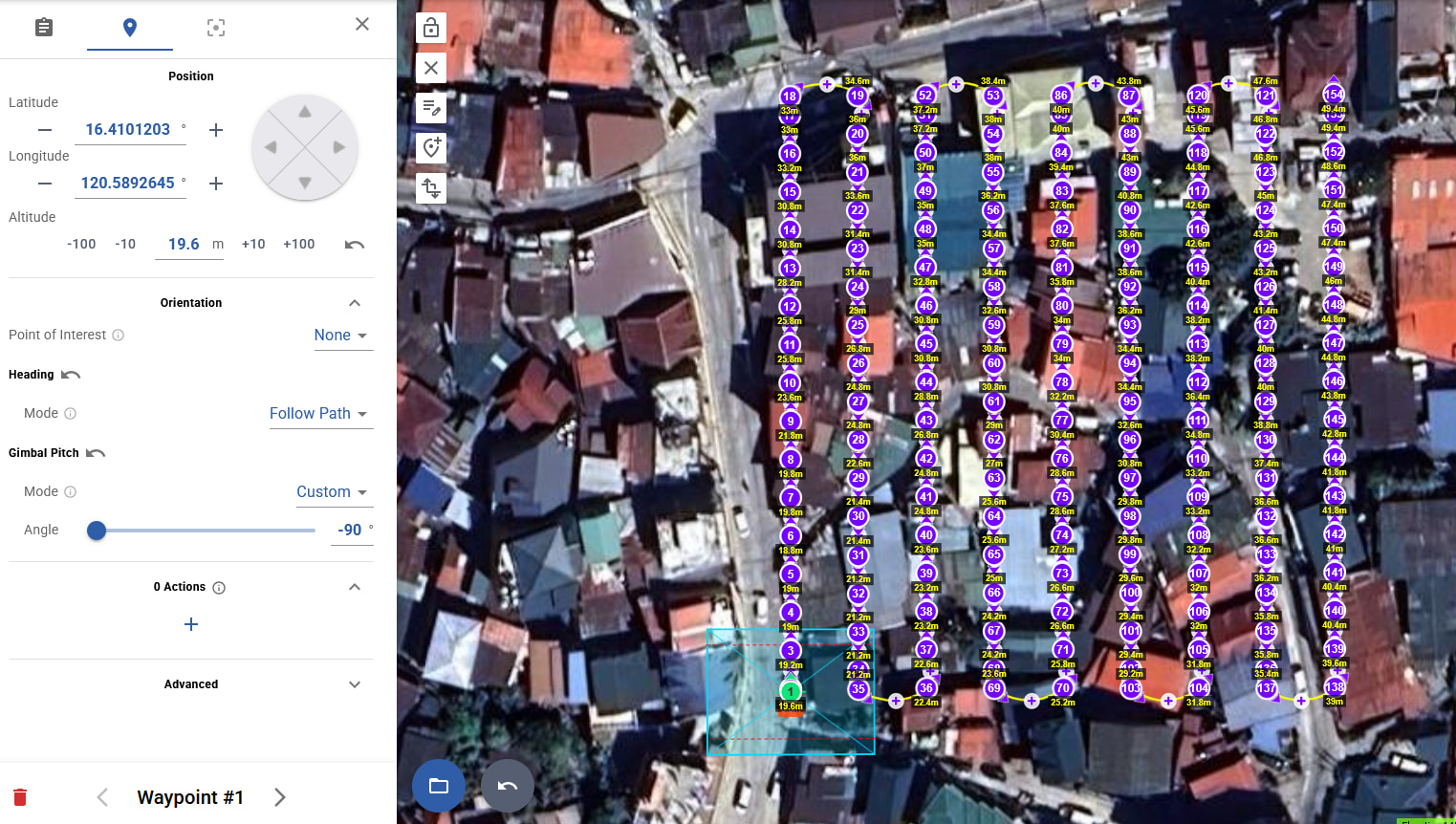

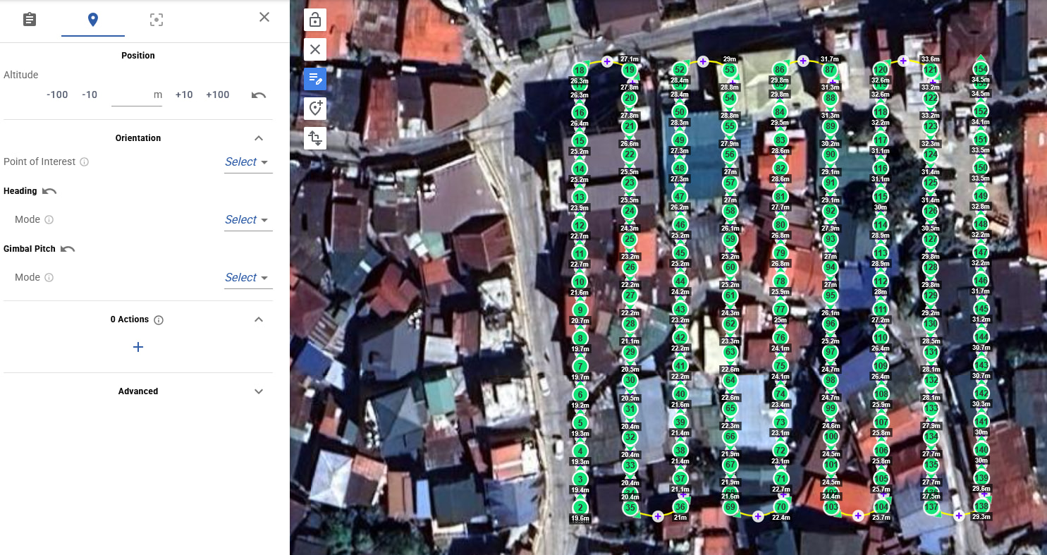

I do the same now with AGL, I load my KMZ again.
The top right value is 49.4 and lower left is 19.6 (diff is 30m, give or take)
Now I multiedit and select all

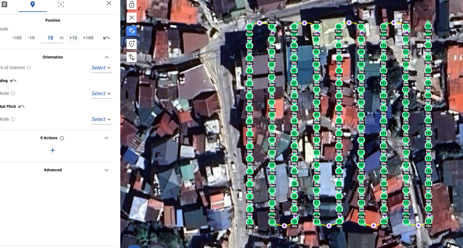

Now I apply +10m
Top right is now 24.9 and bottom left 10m, diff is suddenly only 15m (give or take)
So something isn’t right with this math here
  1. it doesn’t do +10m (same at ATL, it doesn’t simply do +10m) but
  2. it doesn’t apply the same value to all other values, so something is really off here
Works as it should for me, please attach the KMZ you import so we can investigate
Also to be clear, if your goal is to add +10 to all altitudes, you should not click the +10 button. Instead you should type in
+10
The +10 button is a shortcut to increase the current altitude input (0 if empty), so when the input is empty (which it is by default), it does the same as typing 10 without the +
