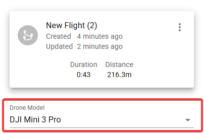

What app are you using? Litchi or Litchi Pilot? If you select a newer drone model such as an Air 3S in the new Mission Hub while creating your mission, that mission will not display correctly in the old Mission Hub and may not display at all in the Litchi app.
What drone model did you select in the new Mission Hub?
What drone model are you using to fly this mission?
